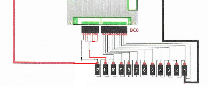

I hacked up this diagram I found here on the forum. I think this is how I wire 12S to it can you please lmk if it is correct?

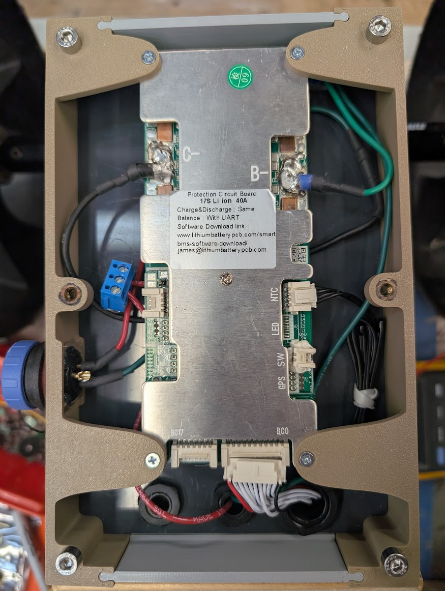

it depends on the BMS. i’ve seen 3 styles of bridging connections for lower S counts.
if you have this one:
then yes. your diagram looks correct.
and for an example this 7-14s one does it differently:

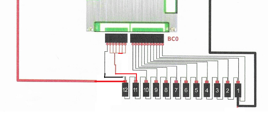

I think the BMS is an LLT, but I was to understand that they are all the same root manufacturer :slight_smile:
Diagram still correct?
Thanks @Fess!
LLT sells JBD, they’re the same.
Just as followup everything worked fine, no fires :slight_smile:
