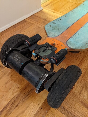

So first off is the form factor. Currently on my low rider I have them mounted on the sides of the nose:
I’m going for a long and low look here so I really don’t want them on top. That means that the wired-in lights have the basically be the same size as shredlights.

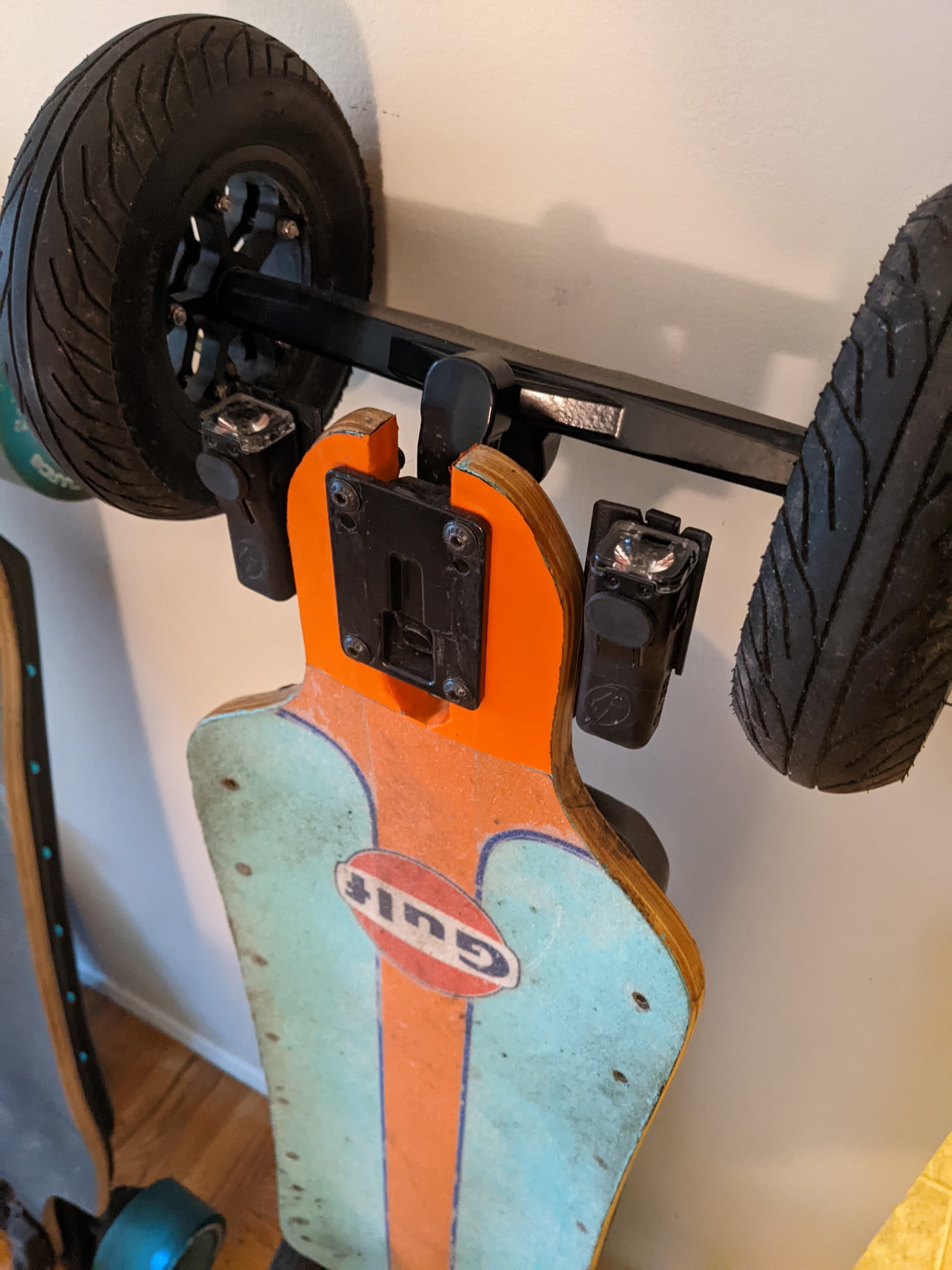

On my AT board it’s a similar story:
I don’t care so much about not having the lights on top here - but it works well - I like knowing I can run off the board if necessary without tripping on lights or kicking them off.
But again it means whatever I get can’t be much wider than shredlights (about 30mm when mount is included). Could go to 3.5 but that’s about it.

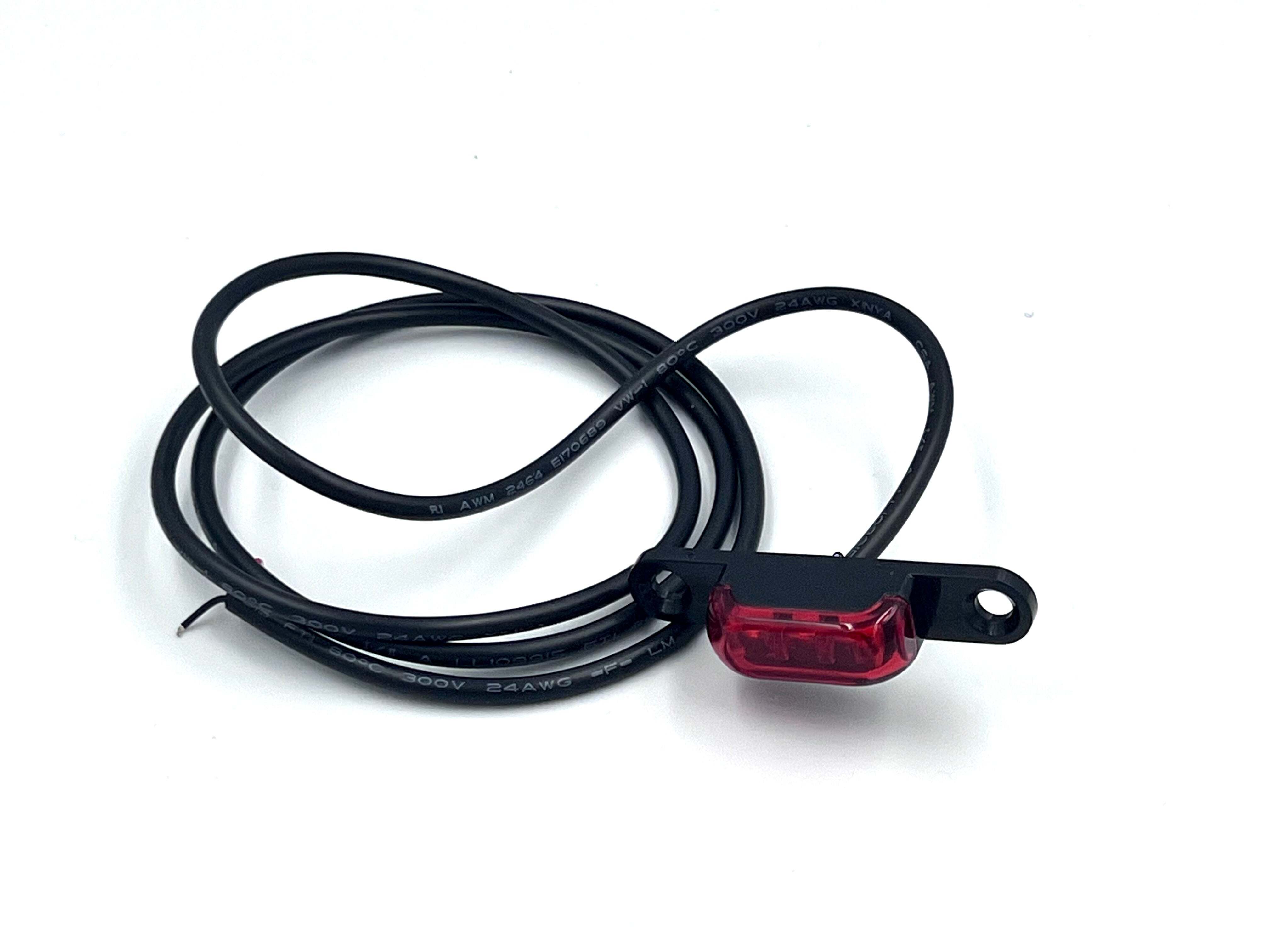

For a tail light, we stock these, low profile and you could easily design a bracket for them to sit on.
We integrate them into a riser.

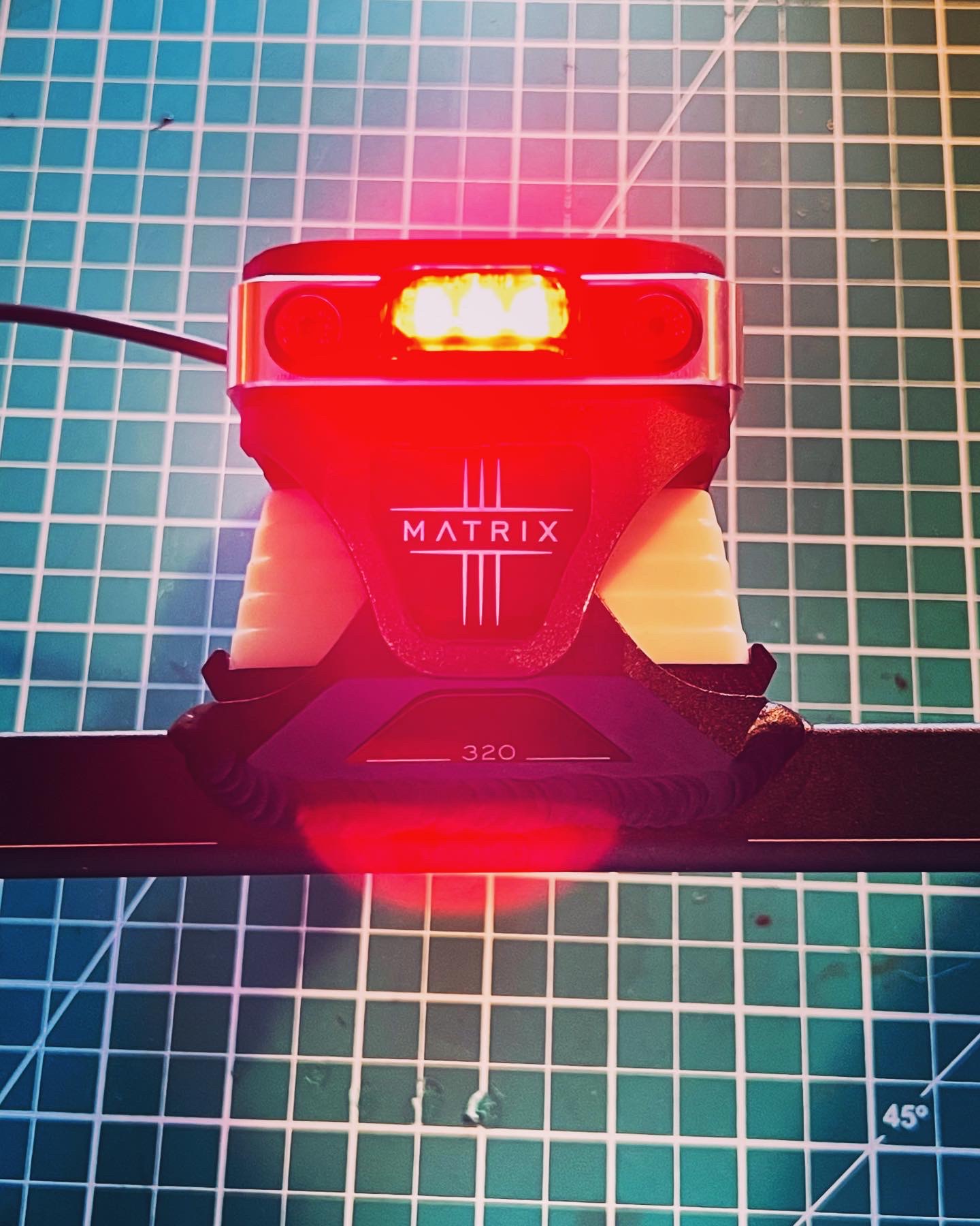

@ShutterShock tell the good people about your lights :metal:
Haha I was reminded by Kevin that I should really just START selling stuff rather than trying to make everything perfect lol
I’m thinking of starting a thread for a limited number of sets
