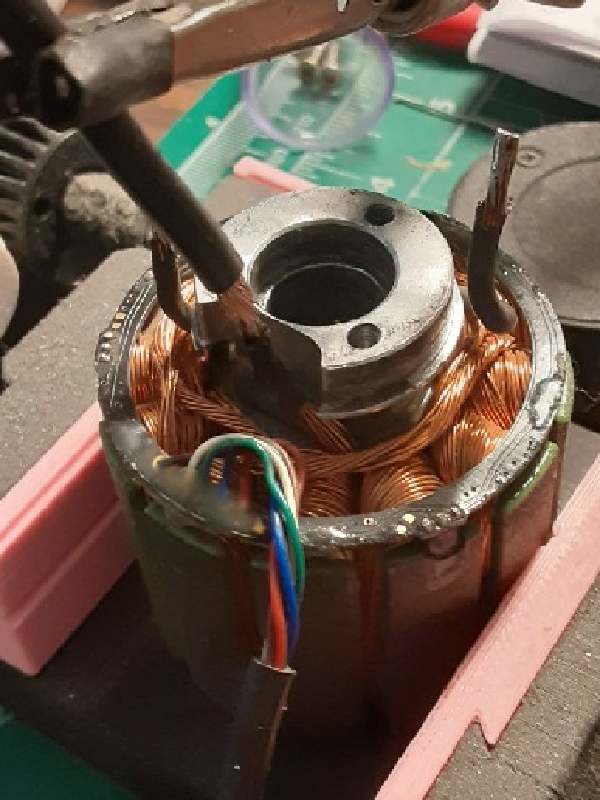

Whenever I rewire phase wires 12ga. Is my go to…
do you rewind stators too? :nerd_face:
Not SK3s or SK8s
But yeah I’ve been known to…
The epoxy over-coat on the SKs makes the job untenable…
:crazy_face:
Always wanted to wind a motor from scratch, no idea what for :laughing:
How long does it take on average?
Your first one will take for-fucking-ever…
But after practice it only takes a couple of hours to pack all the copper in there gUud-n-tight. And terminate it properly
Getting the wire off the stator, on some motors is often times more difficult that the actual rewinding

If i could figger out a cheep, easy method of reinsulating the stator core i’d be in like flynn!
How do they insulate that core anyway, is it powdercoat!?
Naaah it must be a dip right?
It’s some sort of high-temp epoxy or sumpin’…
Yeah but they dip that? Or how do they do that, maybe we can st34l it xD

the “best” case is that the stator insulation isn’t damaged when removing the windings…
you can get plenty of brush on epoxy insulation, but it can get quite pricey… when I saw the amount of damage the stator insulation was taking… and the amount of work to get less than 1/2 done i abandoned the project as to time/labor/parts constraints…
I’ve taken apart stator windings that were easy-peasy just clip and unwind… the SK3/8 series motors was not in that realm…

6374s but yeah… a complete waste of time
Aah no im sorry i was talking about the fact that ill be rewinding different motors not those sk3s after i saw your struggle.
