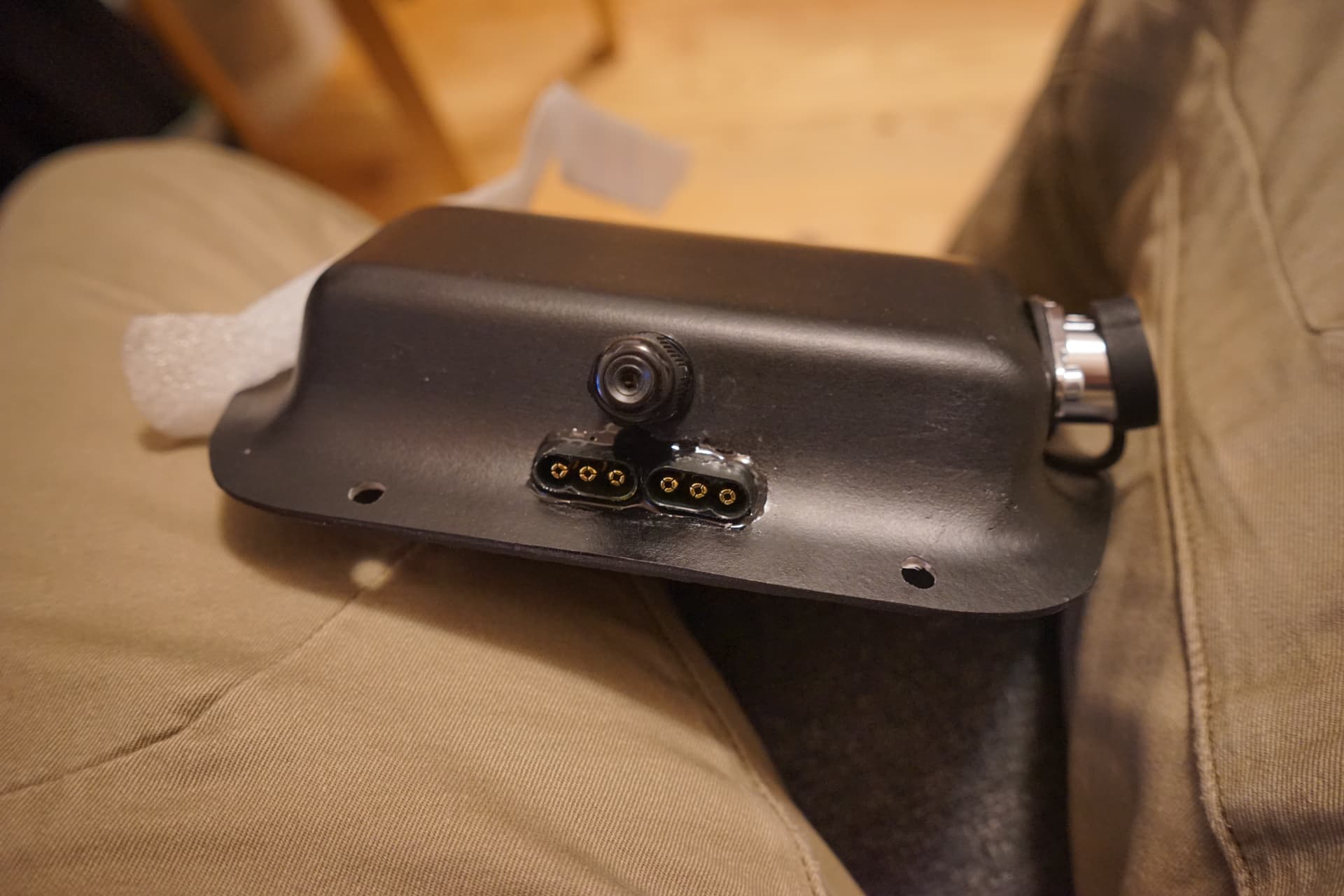

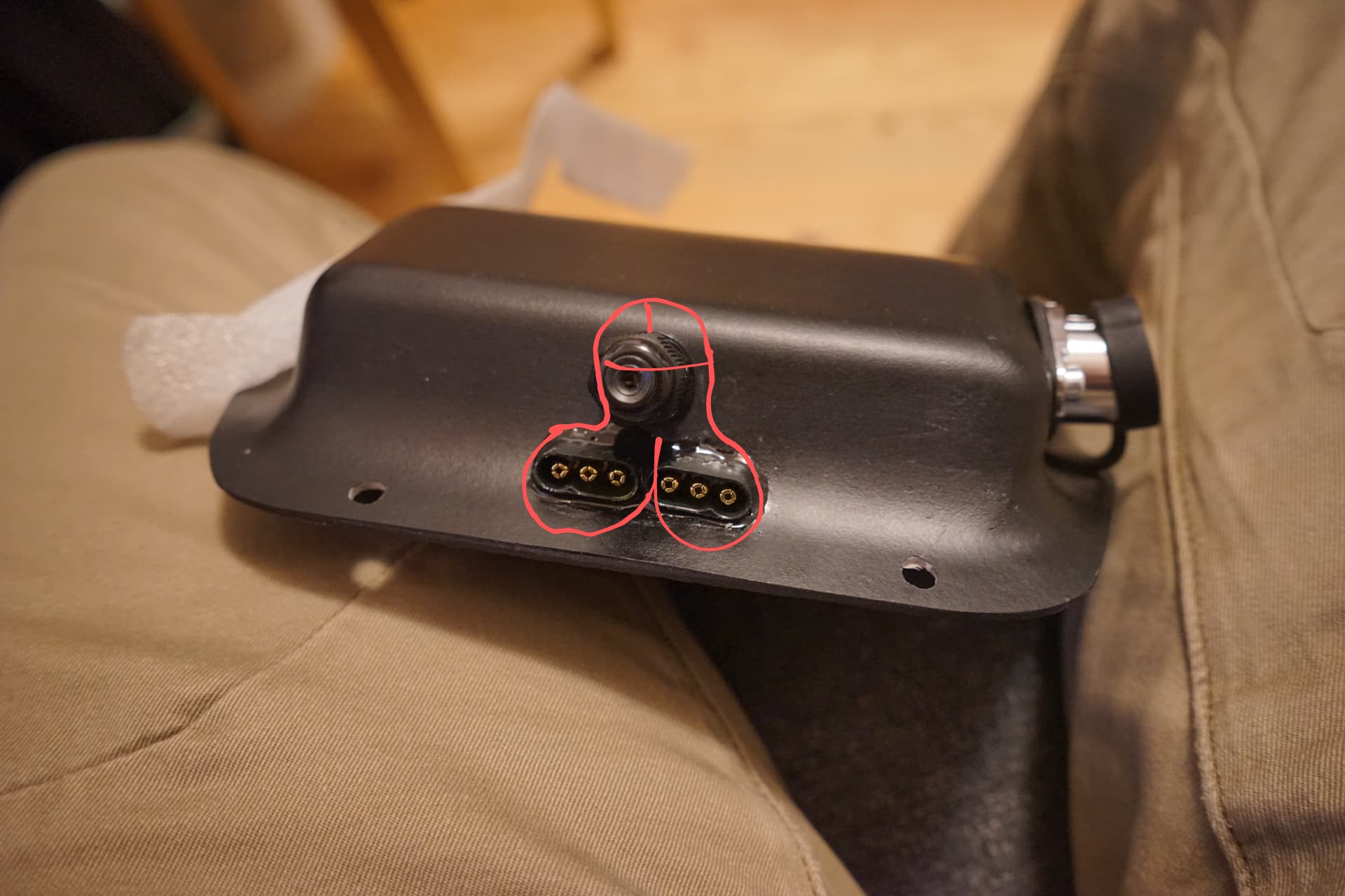

Or, you can make it serviceable:
Eh I’ve had connectors ripped out before and you can’t zip tie them together when it goes through an enclosure, glands provide a physical clamp on the cable which helps significantly with stresses. If there’s such things as an affordable waterproof locking connector that can handle the amps while being as low profile as an XT90 I’d use them though.
