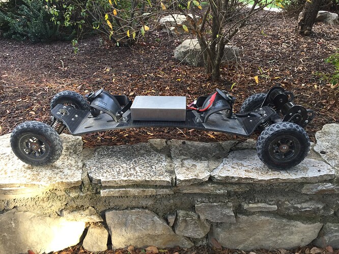

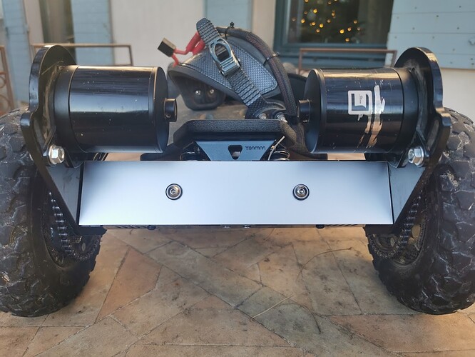

I removed the WILLOZBOARD HobbyWing XERUNS and replaced them with the FLIPSKY ESCs. They look very well done. The soldering job appears to be great, what I always experienced with FLIPSKY products.
They were about 1 mm bigger than expected so I managed to cut original back plate and asked JohnSteel a new aluminium back plate to put upon.
That’s the way it looks now. It’s quite light. I use ASA25 chains here. Maybe I’ll replace them with ISO-06B if it breaks too often.
I transformed original 6S Lipo pack into a 12S Lipo pack. It was easy because it’s made of 2x 6S Lipo in parallel. I built two other packs, using the same HAMMOND 1550 aluminium boxes. You can fit 2x ZIPPY Compact 6200mAh 6s 40c LiPo Pack inside.
I’ve ridden this build only few times but everything works well. I feel TRAMPA deck are really nicer with not too heavy Lipo pack in the middle.
Those ESKATING.EU (Maytech) 6374 makes a screaming noise at 12S! Gear ratio is 10/45. Max unweighted speed is 60 km/h.
5.2 firmware. +25% throttle curve. About 80A motor/battery amps.
I think I’ll get back to ACKMANIAC firmware again. I always feel I have less power with official firmware.
