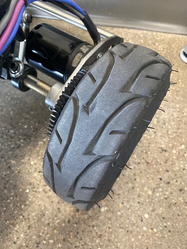

i’m running the nova 175’s on mbs xl’s right now. they fit and balance really well.
Those look good! I think i may try that setup!
Thank you for the pics and video!

Hay man, whats the grip and ride feel like on these
they grip really well, i actually raced them at esk8con and they performed very well. there were a couple times where i lost traction, only one where i fell but every time, it was because of a defect in the track. probably gonna be my daily tires from now on, until they release the 8in ones lol.
this is what they look like now. very little wear on em so far. i would love to see a wider tire from them in the future tho, 70-90mm would be nice.
here’s a pic of the rear
Would prefer a 200mm also but i rekon ill get a set of these shiped over just for gigs. They look like theyve held up well to tough conditions.
