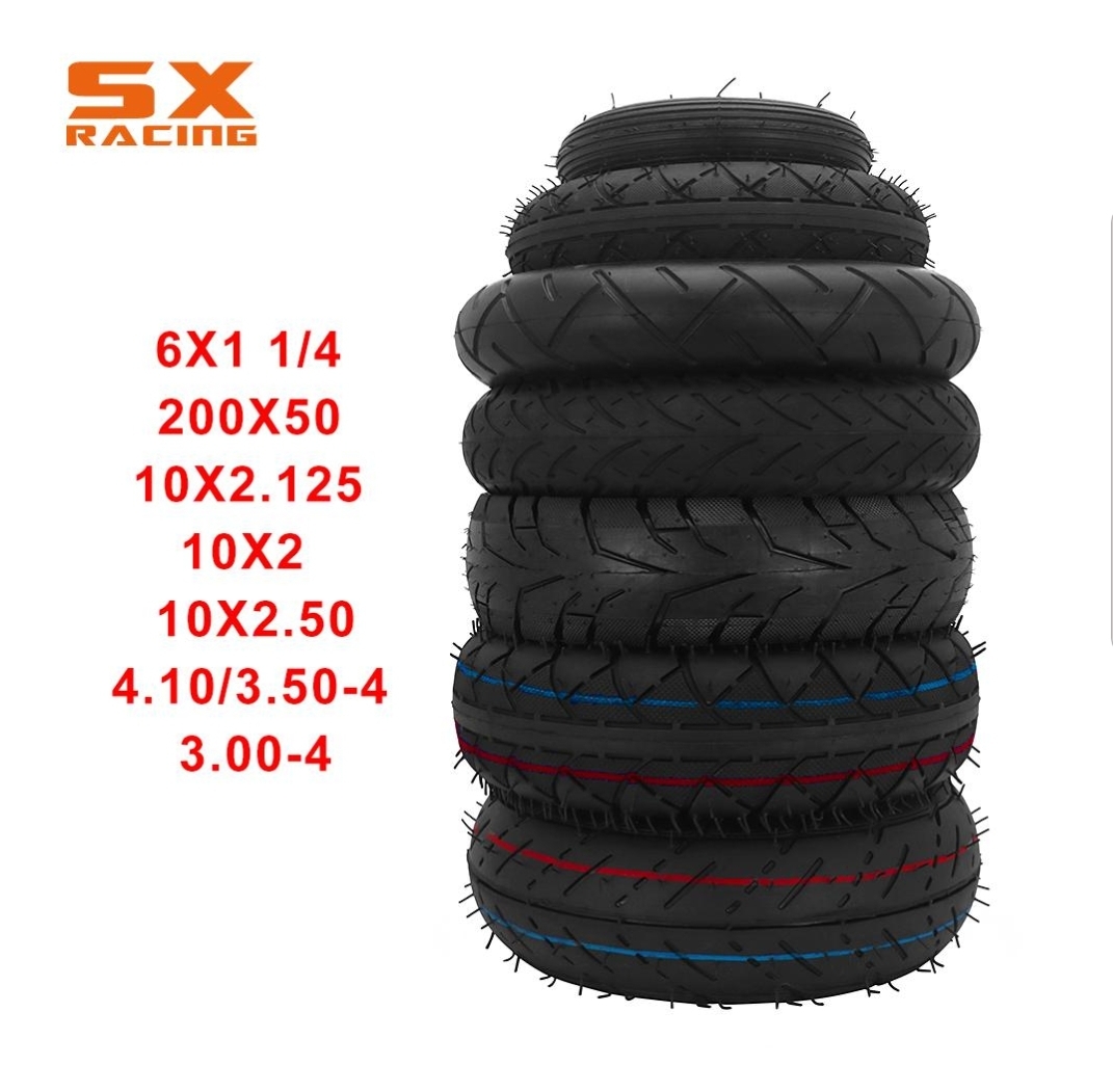

Check out some of these interesting sizes. I got the 9" roadies to try out.
The 2nd from the bottom are 12"
Damn… some good looking road tires in there.
I like the 10x2.5
Here’s what I’ve learned in their sizing schemes…
  • When they use X in the dimensions, it’s diameter by width.
  • When they use hyphen, it’s tire thickness and hub size.
So the 3.00-4 is 3" tire + 4" hub + 3" tire to get the total diameter, 10" wheel
Thought about casting instead of cnc?
The 10x2 and 10x2.5 are 5" hub tires, FYI.
Ah damn. Nvm

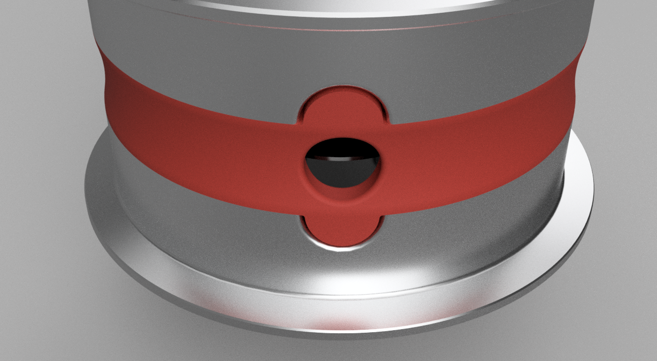

Just finished CAD for a V2 MegaDeep addressing some issues from the first version.
Main changes are :
Hopefully these changes should make the MegaDeep more robust and reliable. Below is an assembled view from the front and back showing clearly the offset.
My plan is to get one of these on print tonight to validate the fit then build a full set ready for some real world testing and abuse.

Nicely done, the MegaStars doesn’t have the interlocking slots of the SuperStars?
I am thinking of making the little valve area fill a stand alone piece that can be glued after, this way you don’t waste a ton of material in support
I thought this but it only takes the print from 38g to 44g so it hardly seems worth it for the effort. Bumps the time to a bit but I don’t mind that.
