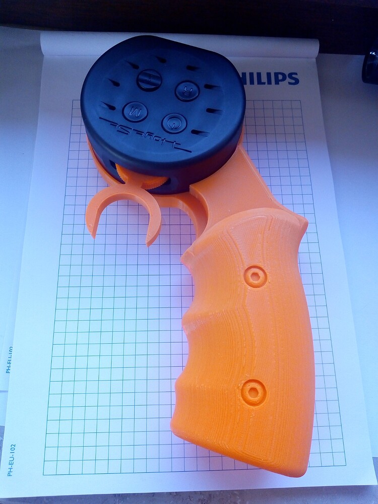

Imo the puck is the only available remote worthy of any kind of city riding.
Puck is awesome, however, having issues with it’s ergonomics…

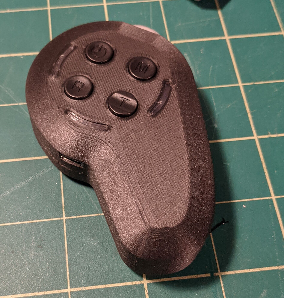

Yeah, sucks that it’s a polarizing design. There have been cases made to try to fix this
The perfection would be, the ergonomics of VX1 with the electric parts and trigger of da puck …
