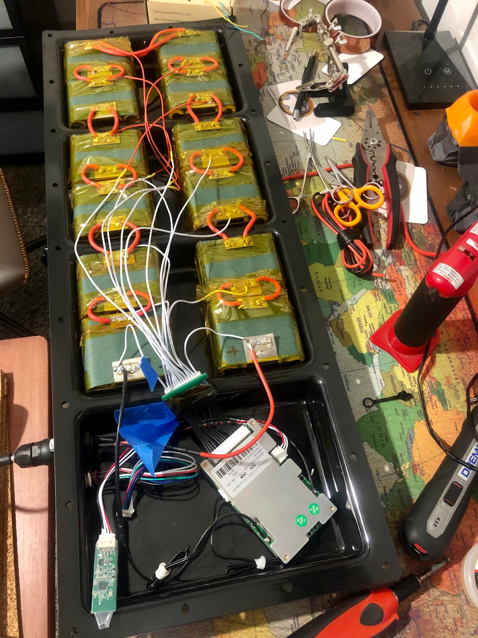

So the BMS balancing cables I have all have smaller male plugs than what came on the Lacroix Smart BMS… anyone know where to get the correct male plug? Wires or not, I can add if needed.
If it’s a 12s I think Duck Battery Systems has the JST plug on their website
those wont work on an LLT bms. the LLT bms use JST-XH not the JST-PH that daly uses.
Oh whoops my bad
So did you buy their smart bms kit for their boards with out having their boards?
You might be better off buying a smart bms al la carte vs the lacroix kit. Maybe resell to a lacroix owner
If it is indeed JST-XH
us shipping
China shipping
Amazon should also have kits with housings up to 13 pins, bit expensive & too much keywords to search to find quickly on mobile
Ebay seemed dry (for US shipping), only have the female housing/male pins in 13 pins.
It was a whim purchase when I bought the stormcore and motors last week for a flux deck I’m building.
It’s just the adapter but apparently they use larger connectors. I can cut and solder since they have plenty of wire on the extension just didn’t want to do that to 13 tiny wires if I could solder the tabs and snap them into a matching connector.
It is, I have the misc kits but only have the connectors up to 10-pin.
Just ordered from that battery source, much appreciated!!

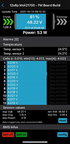

Finally got around to putting this together - working great, thanks for everyone’s help!!
