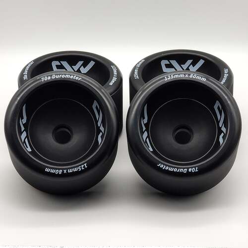

I would suggest just adding MAD wheels from @fujio001 to this set up and calling it good.
Either the V2 105s or the new MAD Max 125.
Their grip and comfort are probably 100 times better than your existing wheels

OP did mention “really disliking cracks, bumps, and tiled bike paths” so the suggestion of 125mm thanes might actually be enough to get by his needs without a full rebuild.
MBS would have all the stuff you need but like Raf said if you’re looking for more bumpy road comfort some bigger wheels like the MAD 125’s might be a nice compromise.
125mm can handle small bumps maybe, but really only pneumatics can confirm to terrain

@rafaelinmissouri great suggestion actually! My main goal is a smoother road setup, so if I can achieve that with only new wheels and maybe a new pulley, I’d be quite satisfied. Did you notice a big difference compared to say 90mm wheels?

It’s a far more significant difference than you could imagine.
I have had giant urethane wheels. 100,110.
And the MAD wheels are far superior.
Like way above and beyond.
It’s kinda of a rubberized urethane. @fujio001 can maybe make comments on the compound used.
So you have the compound itself. But also the construction with the holes.
So these wheels do 2 things way better than regular urethane.
***Vibration Dampening.
***Grip.
I have the V1s and the MAD Max and I probably need another set soon…
