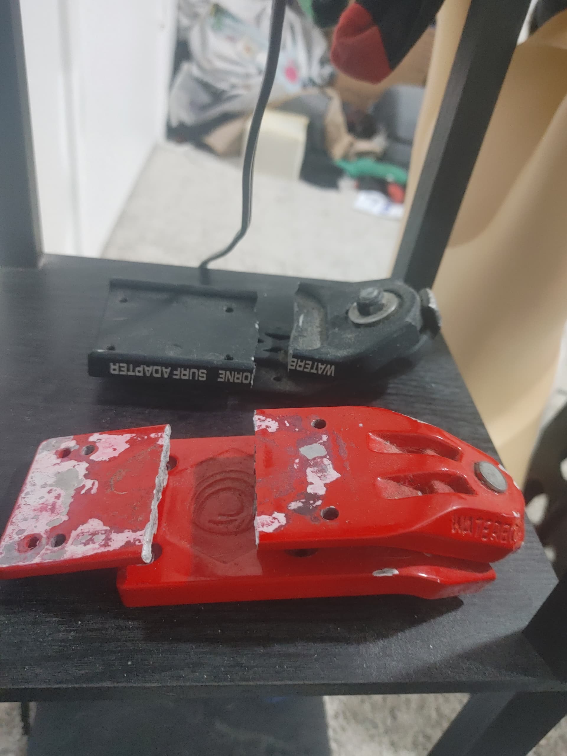

I love and will always use Waterbourne stuff but keep in mind that the surfadapter will crack eventually.
Keep an eye on the top side since that’s where it should break when working right. Meaning you dont loose wheels when it breaks

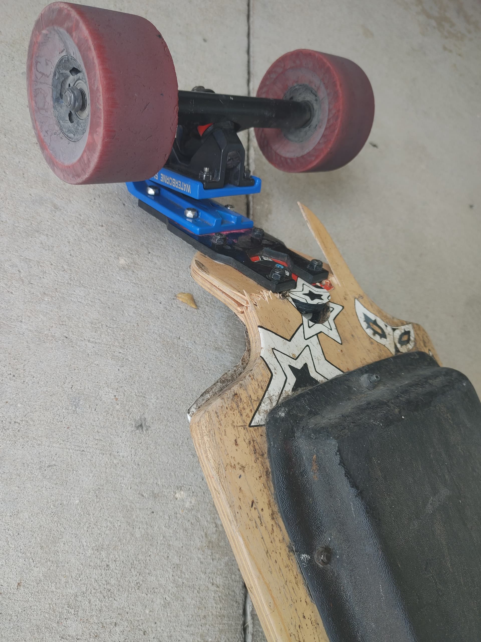

Also apparently the bracket to extend the wheel base puts too much stress on the deck. Granted it took over 2 years for my deck to snap but still something to keep in mind
I broke two surf adapters. Both were replaced by the company without needing them back. The black,one was always defective but the one I painted red broke the safe and intended way
