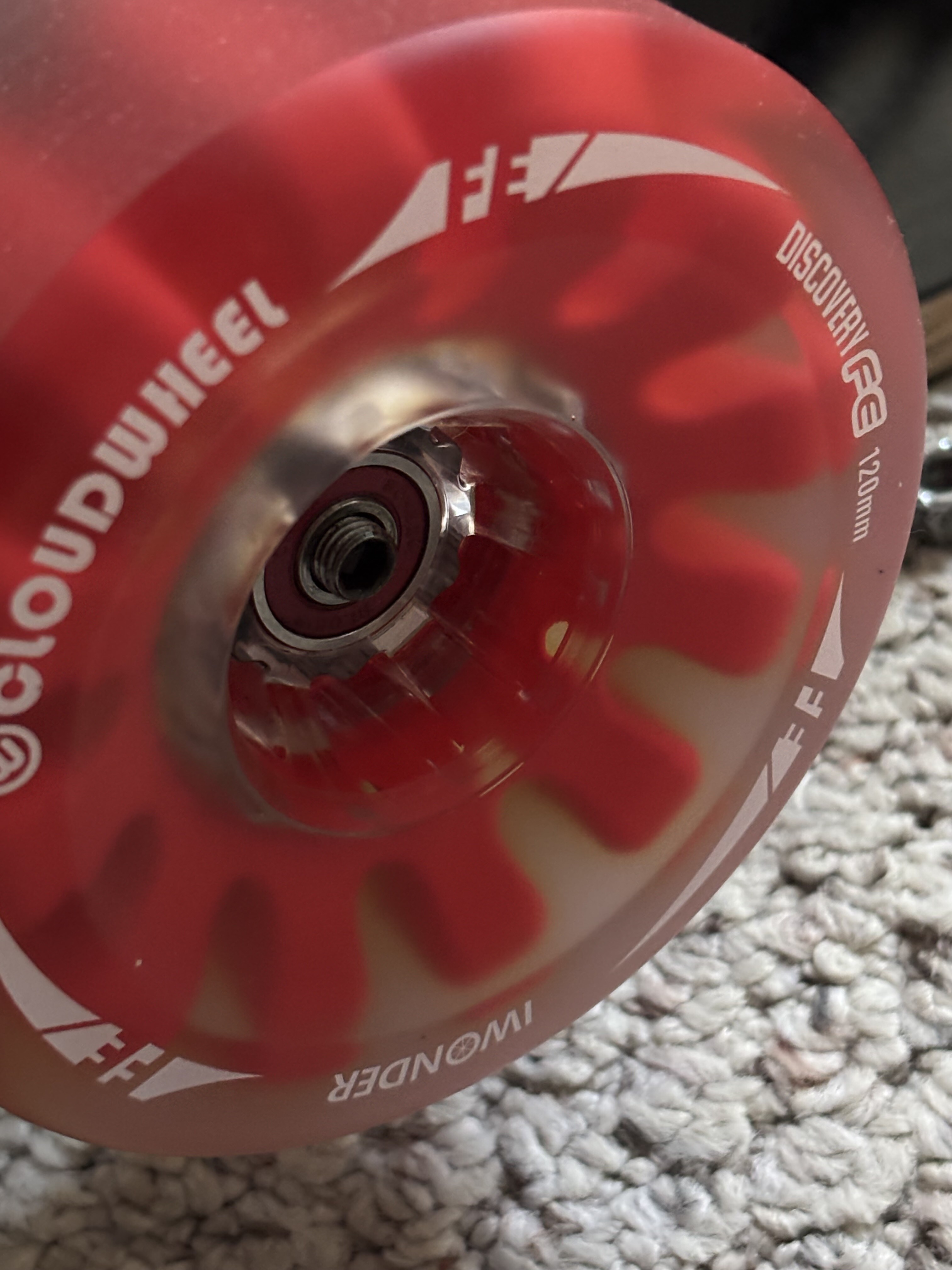

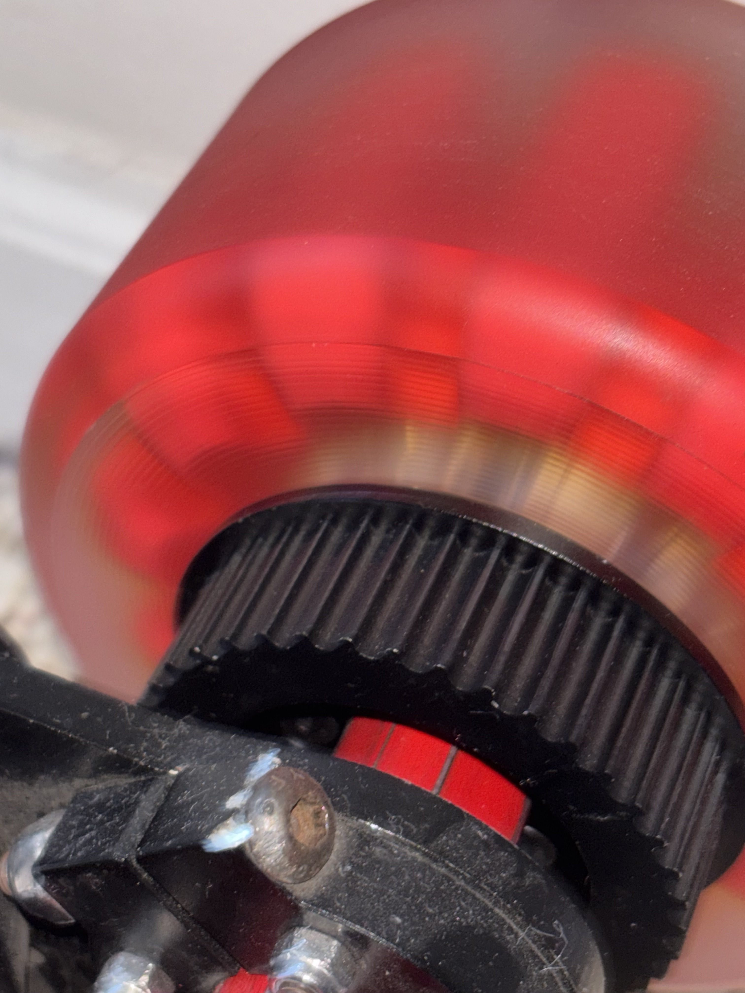

So recently I got the new Discovery FE’s from IWonder and a new pulley that has a support bearing on the inside, I thought my BN 220 trucks would be able to fit both the wheel and pulley since I had the OG discoveries on there with a pulley without the support bearing and had plenty of room so when I slapped these on I was surprised that it barely fit, can’t even tighten the nut, any ideas?

The axles are 50mm long so I am surprised that doesn’t work. They must only be made to fit onto 60mm long overall 10-8 stepped axles. The axles on the 220 hangers are already over 15mm long than a standard skate axle.

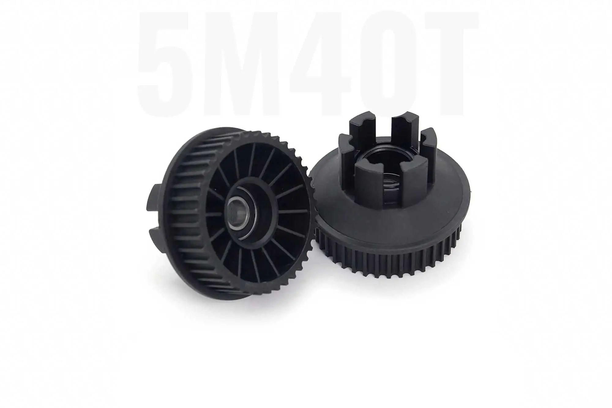

Here’s the link to the pulleys I got. They were a good deal especially coming with 2. Quality’s pretty nice too, I was surprised as much as you were cuz the axles are pretty long compared to most skate trucks so I was very certain it was gonna fit just fine including the support bearing it has in the back. I checked around as well as your site to see if it was possible to just swap the axles for longer 8mm axles since I literally got these trucks from you a month ago but no deal
