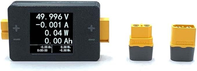

I think it is wise to have an inline meter on one’s charger output.
It can help one see issues with their battery, or charger, or the circuit, before they turn into something worse than the walk of shame.
