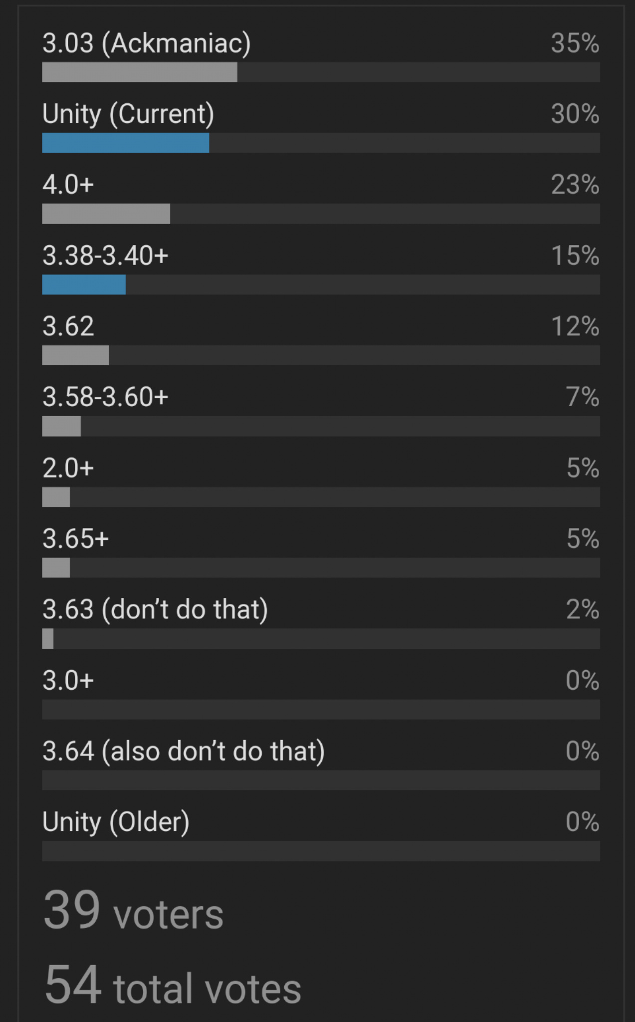

just curious, apart from hfi, what features do newer firmware have that isn’t in Ack 3.03? which modern ESC’s aren’t well supported by Ack 3.03, other than Unity?
normally, i would just read the changelogs to get the answer myself…
I’m surprised by the poll results so far. I knew Ackmaniac was still being used but figured it was a much smaller crowd. Granted the sample size of this is small and DIY focused, but all the same, higher reporting % than i expected.
PS: who the hell is using 3.63? you nihilist.
pffft! you dismiss this as if pew/gallup/nielsen don’t do the exact same thing :smiling_face_with_three_hearts:
