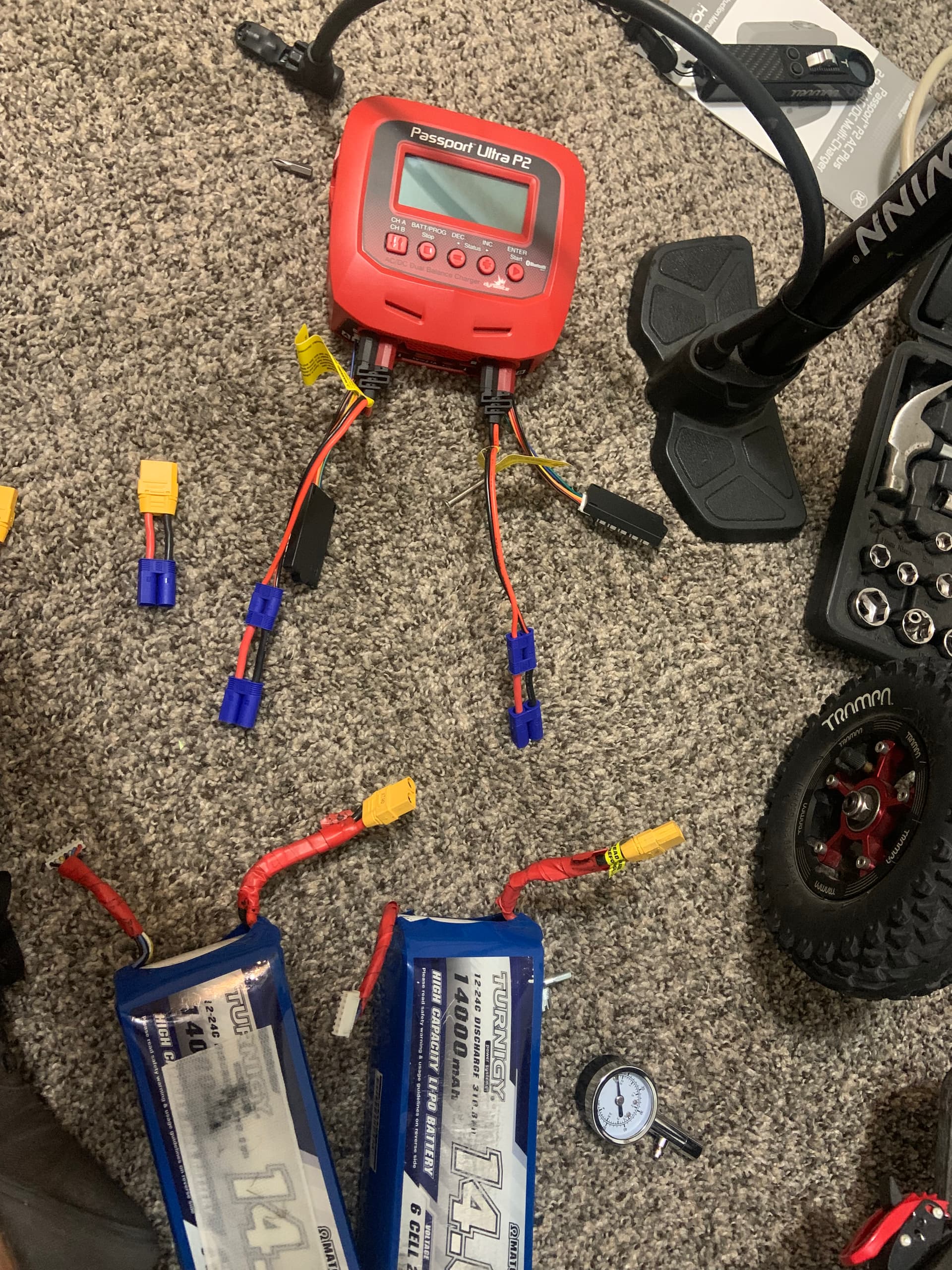

What do i need to charge these? No adapter sent fits, its the ultra passport p2 charger.
deans to xt90
unless those plugs are banana/bullet connectors on the charger
then it’s that to xt90
No none of them fit, ive tried all combinations, i dont know what else to do, or if there is an adapter i need to buy. They guy i bought it from said that the charger package would send the right connections but im not seeing it.

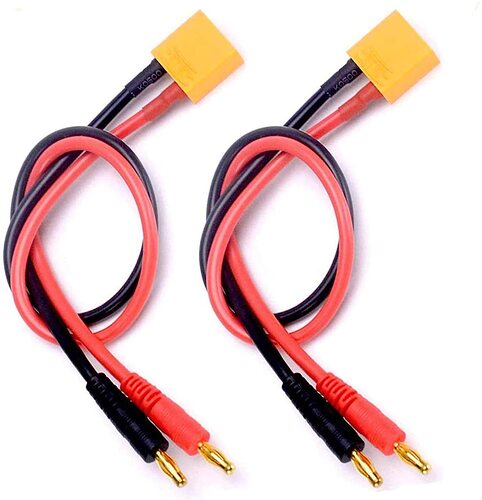

you need to get a (iirc) 4mm bullet to xt90 adapter
or
get some male xt90 connectors and cut and solder the adapters that you currently have
If you don’t feel like soldering your own or buying adapters you can buy a two pack of charging leads for pretty cheap.
