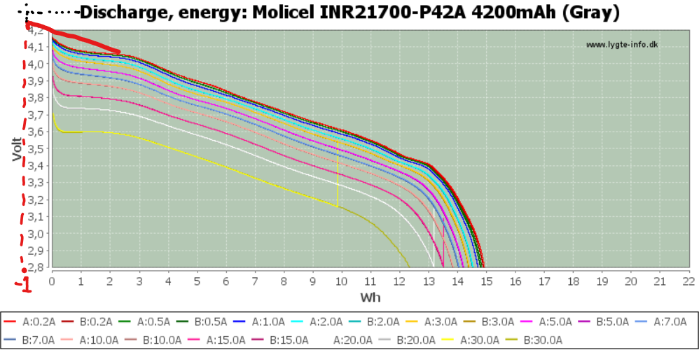

I’ve always been a little unclear, does the phantom voltage have any effect on safety either? Like if I’m trying to fast charge and I know I have 0.03V/cell of voltage rise, would it be unsafe to terminate at 4.23V/cell so it drops down to 4.20? Or if VESC could be set to permit a small amount of overvoltage for regen brakes. Never done this, but I’m curious to know if the option exists.
AFAIK cells can charge to 4.25v just fine, this will just hurt cycle life a bit. There’s so little capacity above 4.15v that there’s no point and you’re likely better off just letting it drop down to 4.15 for better cycle life
Yeah, that’s where I usually stop the charge too. I was just thinking of the 1% of trips where I need max range.
Most of our cells are rated to 4.20V nominal, 4.25 max, so 4.23V shouldn’t be a big issue. It is abusing the cells though. LOL…I guess we can say that about 4.20V too if our priority might be longest cell life.
I don’t enough to know how much additional risk is added by going over 4.25V. The higher and longer you do it the worse it is, and cells are much more sensitive to overvoltage than undervoltage, but I don’t know enough to be able to quantify the risk.
I have to fall back on erring on the side of caution and to recommend not exceeding 4.20V and if it happens to lower the voltage as soon as possible.
A thermometer might be able to quantify it lol.
Fig. 1: Cursed discharge graph
I guess that confirms we have the option to squeeze ~1Wh/cell extra out of a pack if it’s charged right before you ride… hardly ever gonna be worth it, really. I might set my charge termination a little high if I ever want to avoid the CV segment of the charge cycle though. Thanks Mooch :+1:
That voltage curve verrry quickly goes vertical to the left of the graph. You might get another 10mAh stuffed into a cell brought to 4.30V or so, about 0.042Wh. Most definitely not worth the risk and cell damage IMO.
