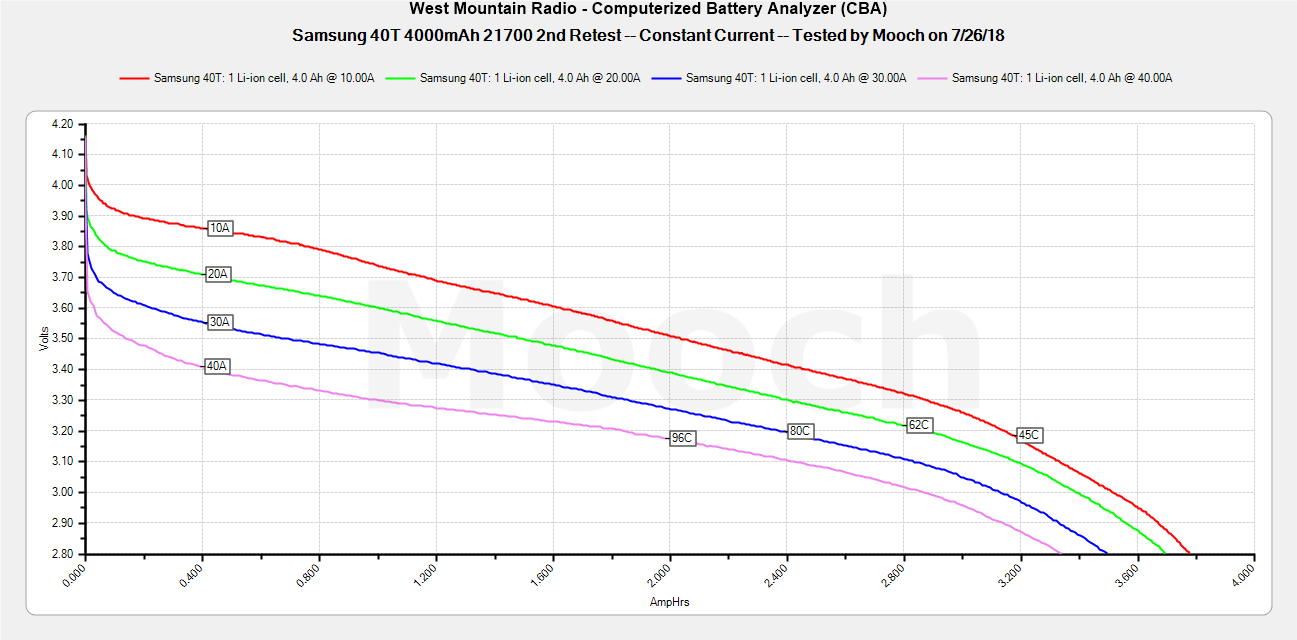

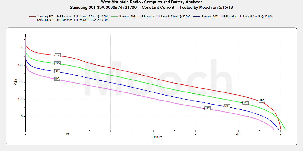

If that graph is true its alot better than I thought it would be. I want bigger cells for new builds, 21700 limits my choices to pretty much samsung 30t/40t, but I want more mah than the 40t, with the IR of the 30t…
One day :thinking:

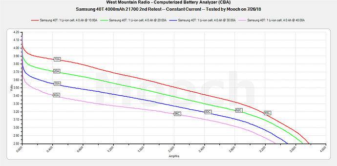

Do any discharge sheets show the temperatures after longer continuous runs? Like Mooch does.
Maybe thats the killer?
Unfortunately that reviewer doesn’t talk about temperatures. I would hope he would mention if they get crazy hot, but yeah it’s a big omission.
Thermal imaging videos of batteries are pretty cool.
Even samsung 30t/40ts get warm under heavy load, I cant imagine these will outperform them thermally
Cell max discharge rating I believe is mostly a function of temperature.

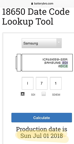

If you are willing to go off brand, why not try the liitokala 21700 4000mah? massive thread here. Consensus seems generally positive and unbelievable value for the price.

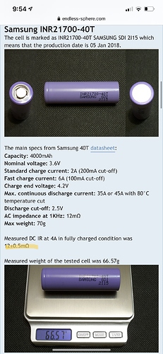

Liitokala are b-stock rewraps, so their 4Ah 21700 is probably Samsung 40t
oh snap. no way! :o

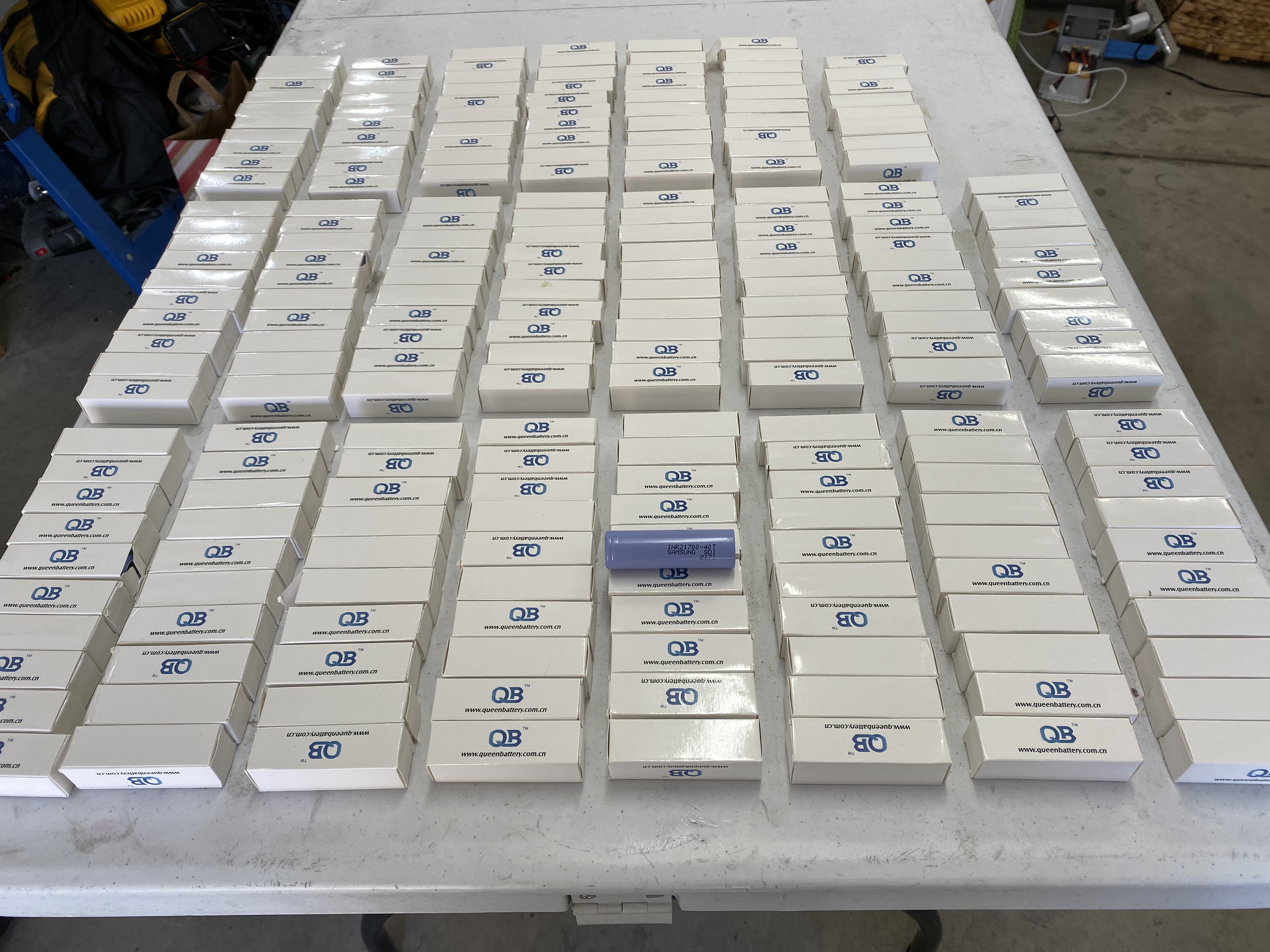

How much fo dis?
They were around 3.90 per, SH around 90 usd

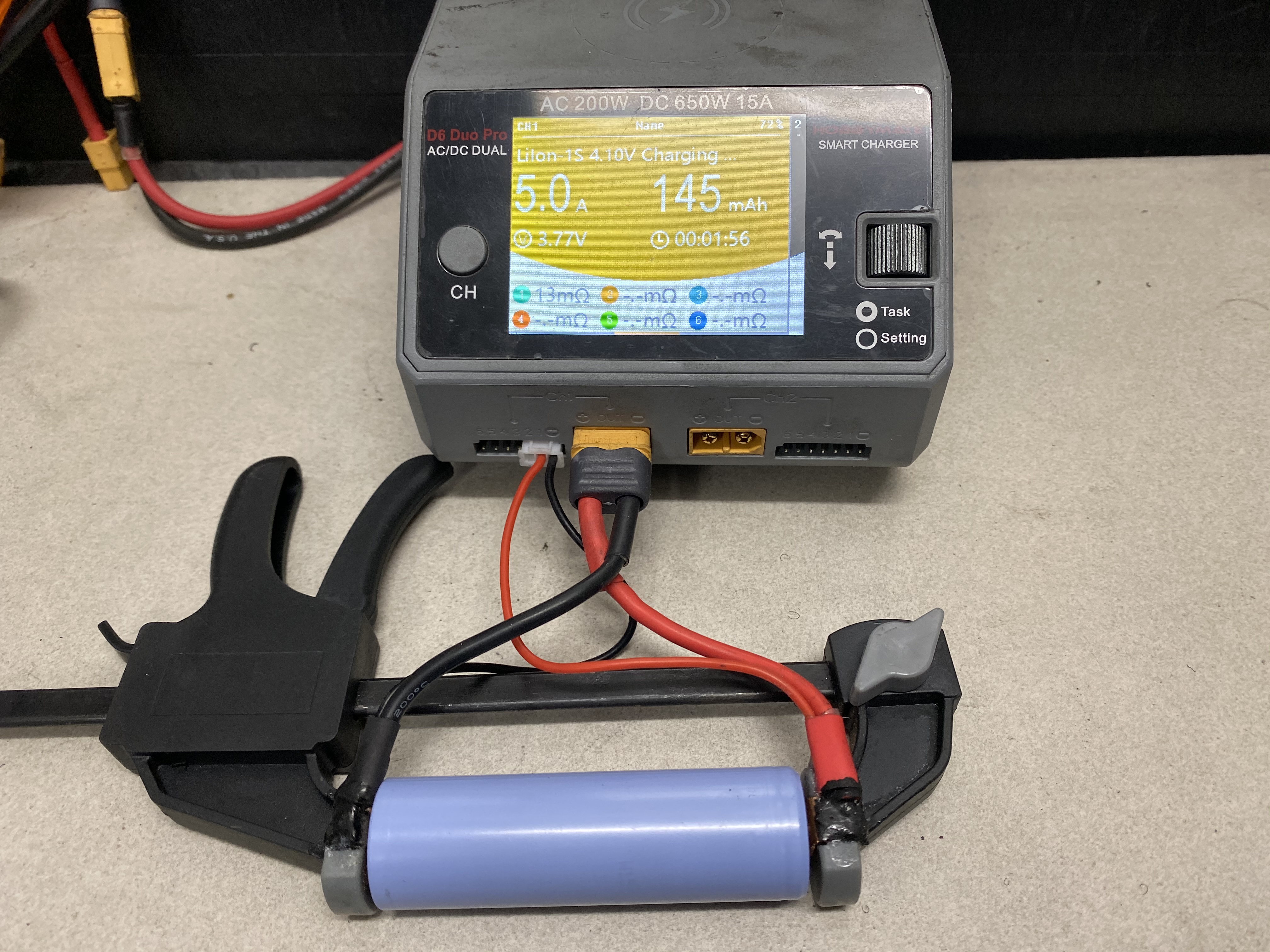

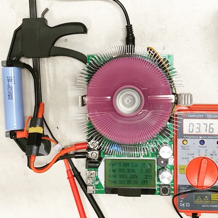

-Compression copper contacts rigged for testing. Short leads.
-dimensionally, 40t’s are in the expected can.
-11-13 ohms IR
-pulled a solid 3ah out of the cell at 5 and 10a constant load.
-arrived at 3.45v.
-not hot after discharge, have thermals, but I’m le tired
Sorry, I have a childs multimeter :man_shrugging:
Thanks for testing a delivered cell and putting up the numbers. Good info :call_me_hand:
