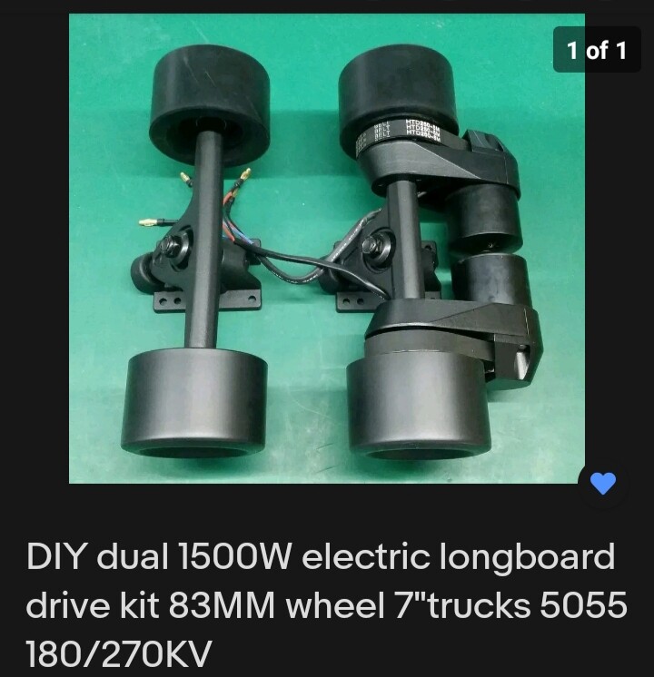

What deck I need for these trucks?
Also, will it carry 280lbs?which one?
A) what deck I need for this trucks?

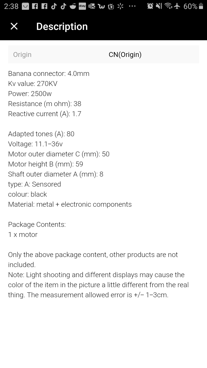

B) what deck I need for this trucks?1500w 180kv/270kv

Is that the DIYE setup?
If it is, it’s been reported a safety hazard since the trucks break due to poor manufacturing

Any deck that is flat will be suited for these kind of truck
Might not fit drop through deck with the motor and all, but topmount no problemo
I’m not sure. These are copies from AliExpress.com
Honestly, don’t bother.
Just buy a Boardnamics setup instead
Just hit up boardnamics.com. you’ll be glad you did

Don’t buy those, they are a waste of money. Then when they break you have less money to buy something, umm, good.

If you’re on that tight of a budget, I would make a single drive setup using Caliber 2 trucks and Boardnamics motor mounts and pulleys
You can upgrade it later to dual motor if you want to

You can pick up a full belt setup from Boardnamics for a very decent price
caliber 2 trucks come in only one size. What matters is the thickness of the motor mount you get, and motor size. What you need is small 6355 motors. But caliber trucks are soft and don’t hold mounts well, and the axle length doesn’t allow for a wheel pulley with integrated bearing.
TL;DR: get a belt drive from boardnamics, lol. A quality single drive is great value for the money.
Think of Boardnamics like an entry level but with higher quality made parts and affordable pricing. Everything Kevin makes has been outstandingly phenomenal for the price he sells @. Plus he is a trusted vendor with a long time standing coming the community. He stands by his products 100%.
Just fork out the cash for one of Kevin’s setups and you will not regret it. I have quite a few products from him as well and none of them have let me down in anyway. Granted, as you said this would be your first build, I have years of failing, learning and sometimes teaching and still learning my self and understand the care or attention to awareness in assembling esk8s.

When every attempt is made to cut the price down in a kit, manufacturers typically scrape on the non-visible performance parts. If they put extremely shitty motors, it’s pretty obvious that speed and torque is bad. Poor battery: no speed, no range. When they put shitty trucks, bushings, and kingpins, and paint them black, no one really notices, … until it breaks… This is kind of fine for a 50kg 12y.o. kid, but with your weight, I’d say stay well away from them.
That’s unfortunate, but your weight will mean that you will need to pay MUCH more for your board than a lighter rider. Just because Physics. Thicker stiffer deck, bigger motors, bigger battery, …
