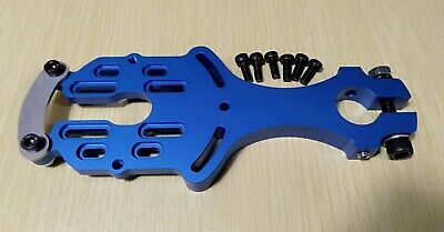

Hello going to order these wondering what pully wheels to get and Belts to get I have dickios motor mounts, and I intend going for 170kv motors.

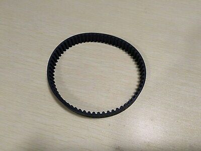

I’m using dickyho’s pulleys on this wheels, with 170kv motors, i’m going 15t/44t, it has quite a lot of torque, while still keeping a nice top speed. As for belts length, with dicky mounts and this pulley setup, i’m using 315mm belts.

thanks very much dickyo, i have already got the m mounts off you

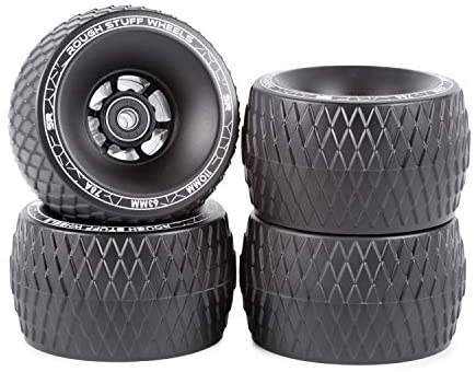

Grrrrrrrrr I’m torn between the tourqboards wheels and these
The one below is cheeper and no import tax is it any good?
those wheels are mega hard. TB110 110% better
Here’s my two cents on this, get the TB110s over these slick revolution wheels. The contact patch is actually tiny on the Rough Stuff wheels because of the concave shape. If you are going to ride huge, heavy wheels - the ride should be plush AF. TB will give you that, these other wheels will create vibrations and road noise and will be less smooth due to worse thane and less contact patch.

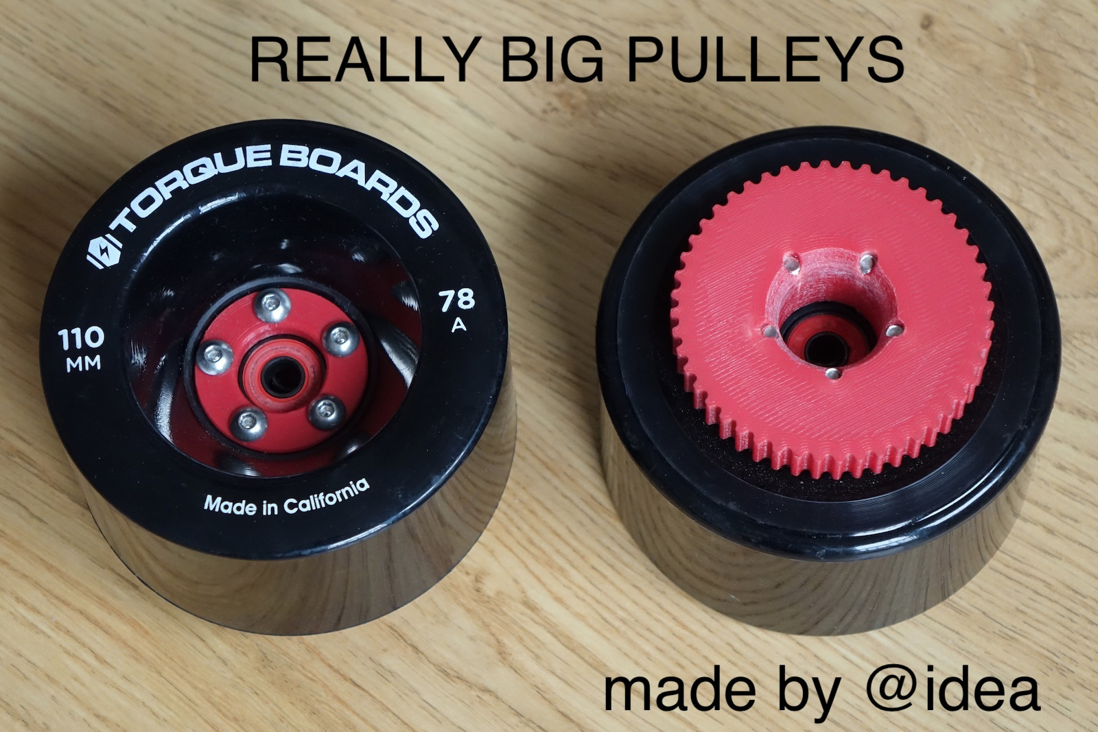

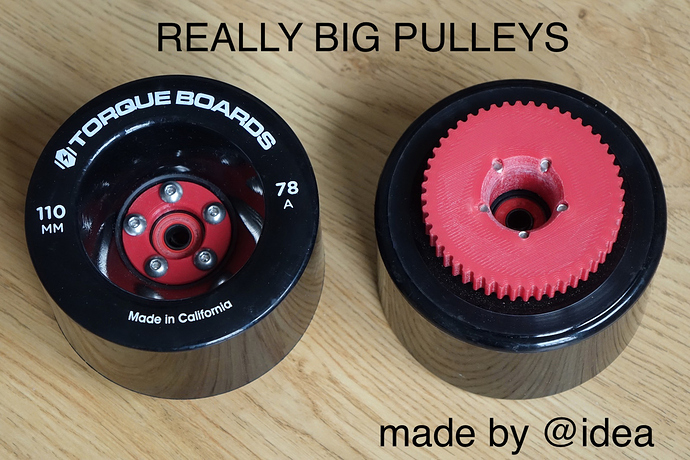

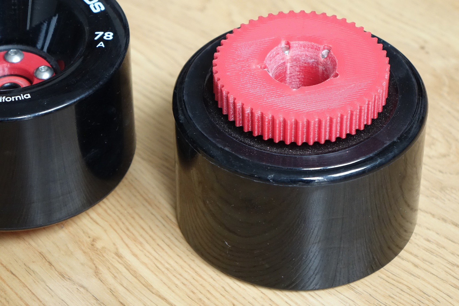

I have these 3D printed 48T pulleys from @IDEA. Already have a second set. The first set lasted me for around 1000 km.
OK tb wheels it is
Does idea sell those if so where can I Contact him they look really good thanks
I like the @3DServisas pulleys, but whichever ones you use, 42T or around there (40T - 45T) is good on 110mm wheels
