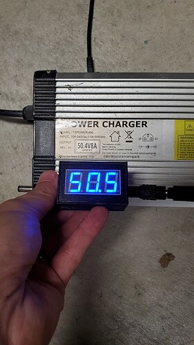

Yz power-450
Charger claims 50.4V output
Meter claims 50.5V

I have verified that the meter in pictures measures ± 0.1V from my mid level Tenma portable multimeter.
