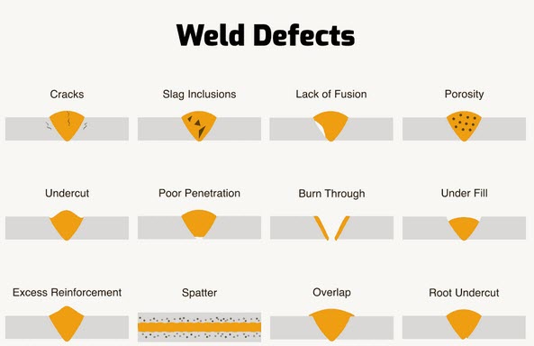

Further reading on common welding faults can be read Here on this website
Weld Testing - Weld testing ensures the integrity, safety, and compliance of welded joints using Non-Destructive Testing (NDT)âsuch as visual inspection, ultrasonic, or radiographyâand Destructive Testing (DT)âsuch as bend, tensile, or macrotech tests. These methods identify flaws like cracks, lack of fusion, or porosity, critical for quality control in manufacturing and construction.

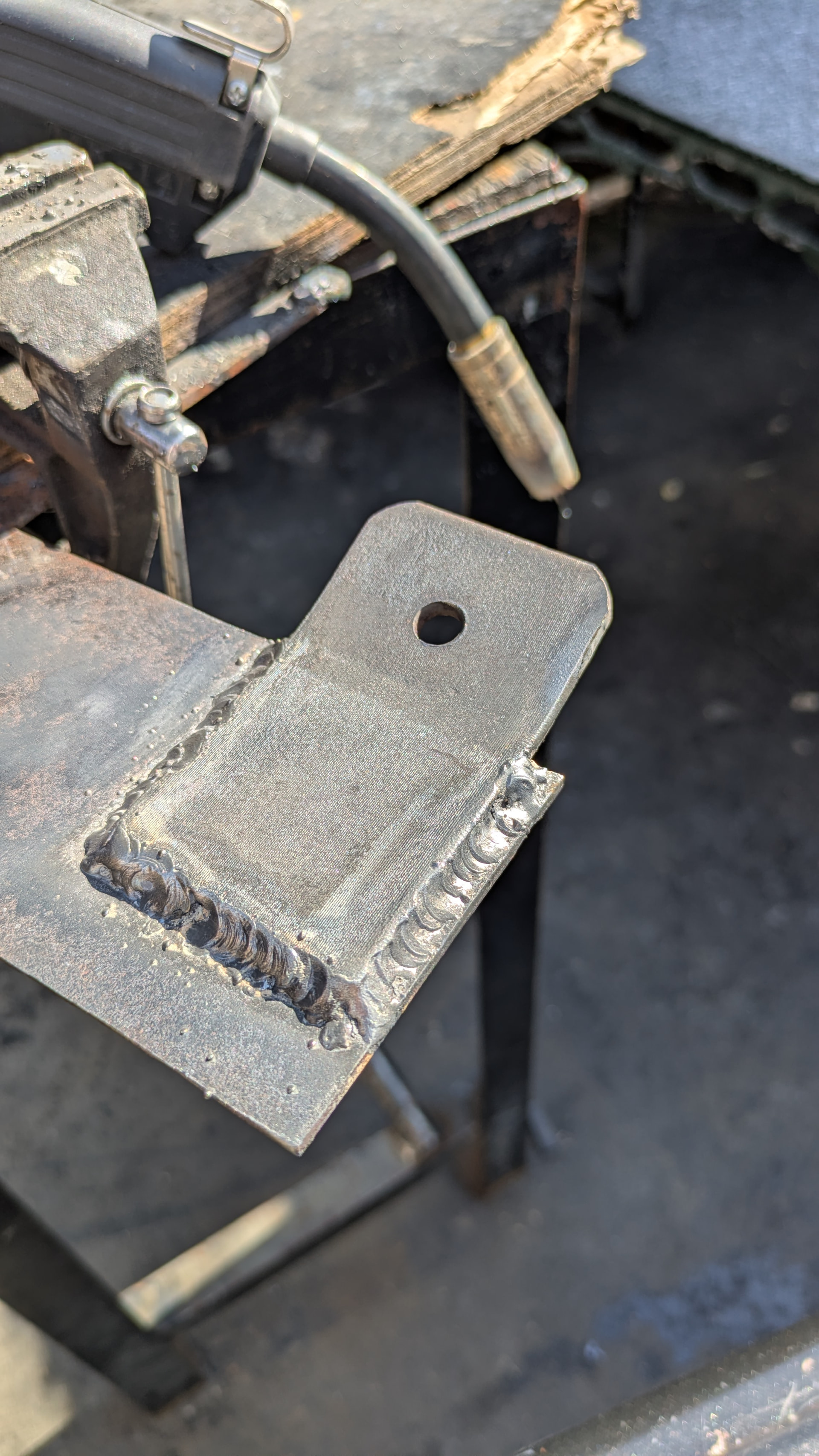

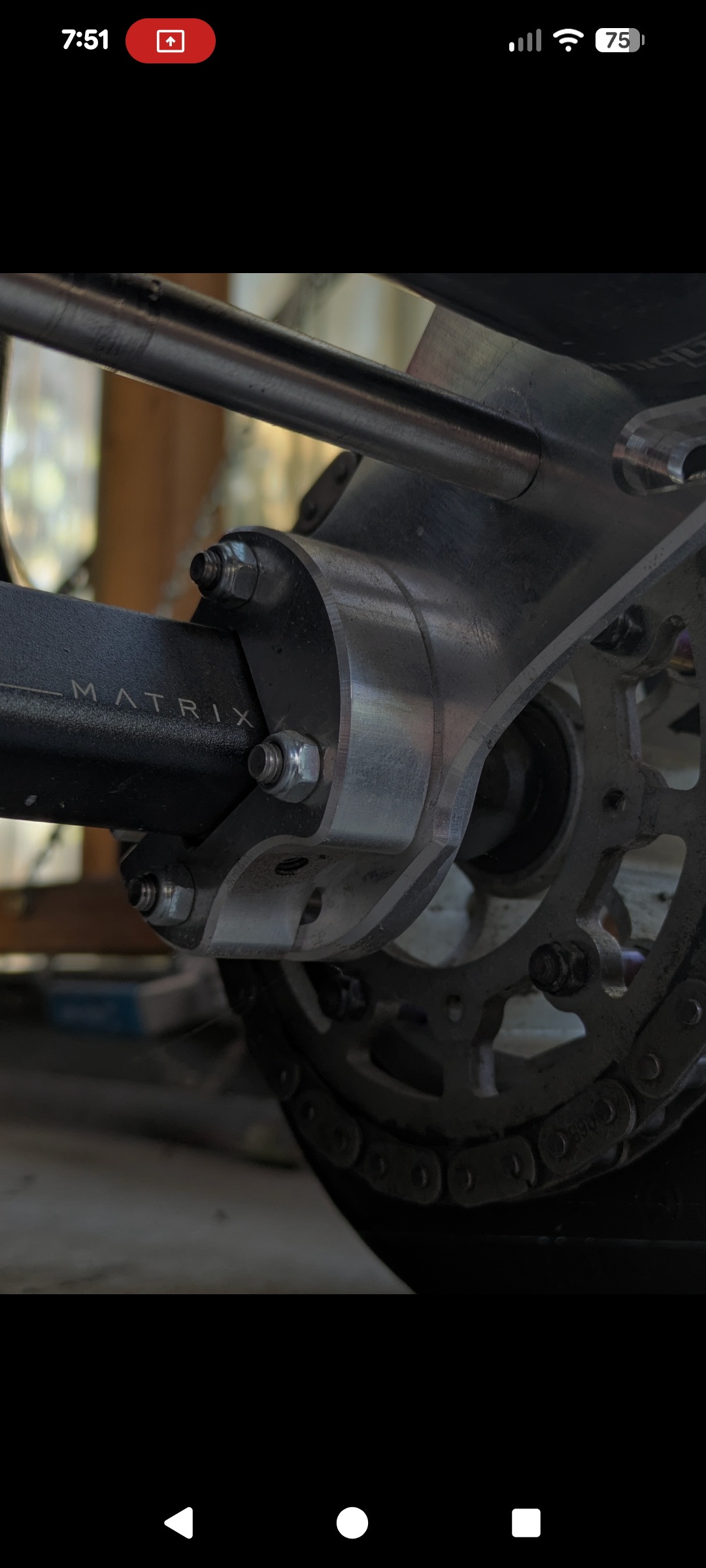

Ive recently been doing quite a bit of welding after a VERY long time off doing any at all. I do remember the difference between good and bad welding, the project Ive been working on has a mixture of both haha⌠The awning structure in question.
Ive been using a Mixture of MIG
and Arc welding
to fabricate all the required parts for the job.
These days with the likes of 3DP prototyping and CNC the skills to do this kind of thing seem to be all but falling away. I really enjoy a good afternoon cutting and welding, welders provide a way or making all sorts of things possible and youâll never look at a pile of scrap metal the same.
