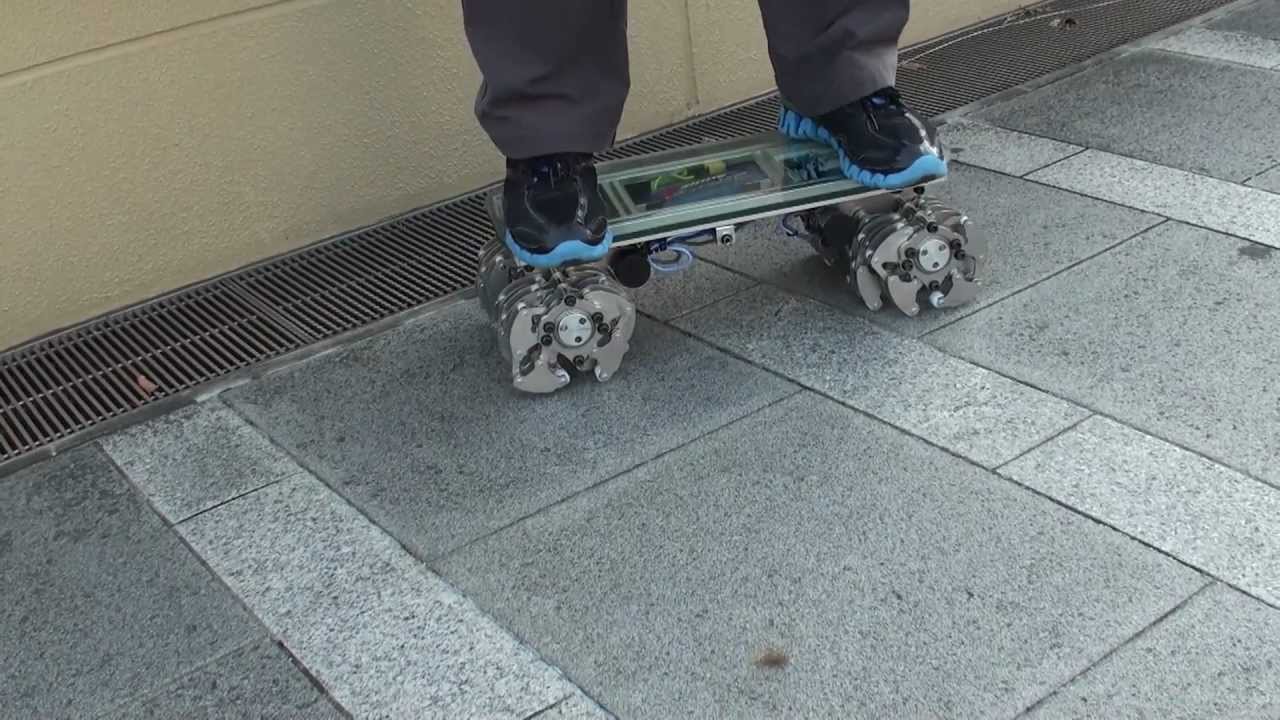

Eskate with legs instead of wheels.
“Mechanical conversion from roll to steer”

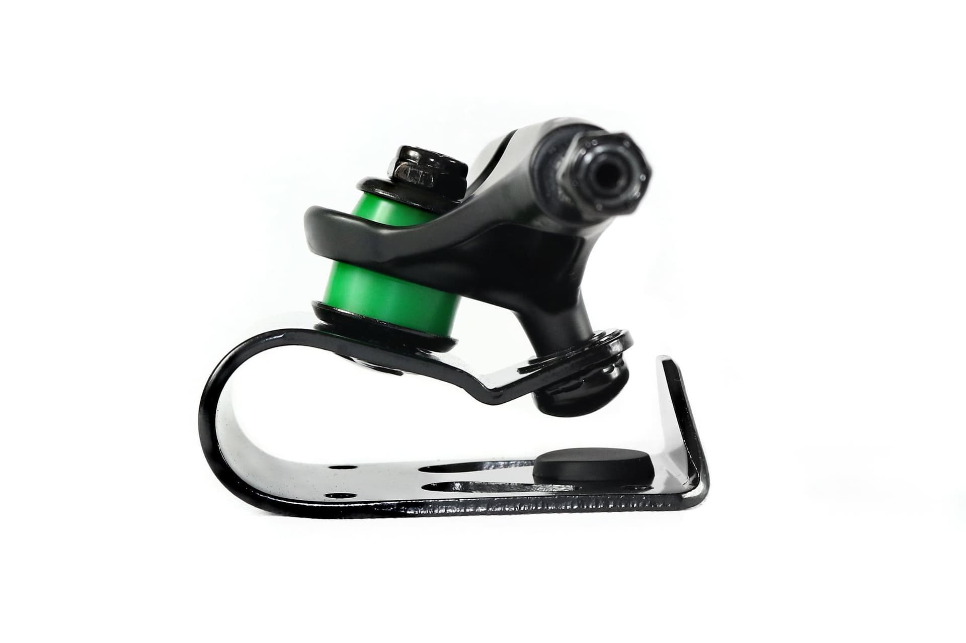

I’ve seen someone use two metal plates connected with a bracket on one end and a spring on the other to create a “suspension baseplate” if you will. And then you just mount regular trucks onto that.
Kinda like avenue suspension trucks, but they don’t have a freely-rotating bracket or spring:

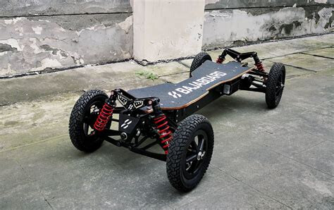

Alternatively, you could just use a Bajaboard front truck if you really want suspension:
So here is the thing: I have already a bit over half of the board done and/or bought. Plus apparently the bajaboard is not really suitable for REAL offroading… (plus the turning circle isn’t great)

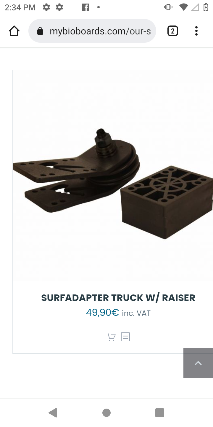

I am using this on my street board: Suspension Kit - Bio Boards so I know about the options out there.
