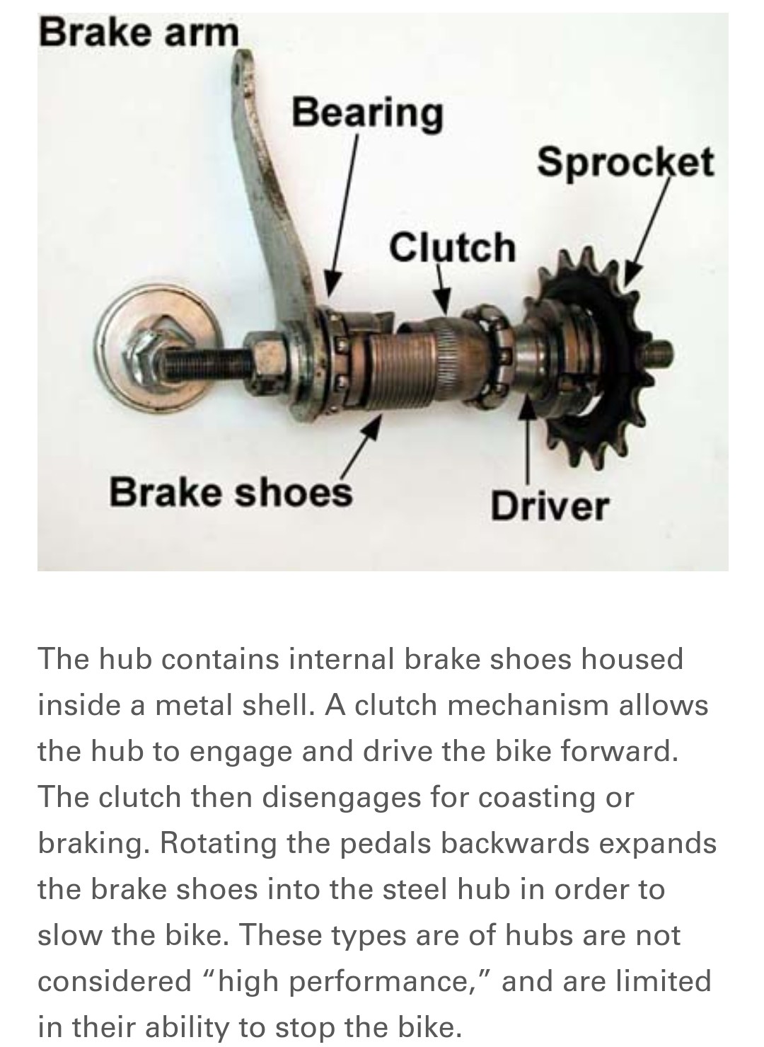

So my dad is an enthusiastic cyclist and we were chatting today and he mentioned some bikes have a system that allows free rolling but at the same time when you reverse the pedals it can brake and reverse
Why not use this system on esk8 for the following reasons
Multiple gears
Free rolling
Still get fully functional reverse and brakes
Thanks if anyone knows anything about this
They require a physical shift over that happens when pedaling in reverse. Would need to be implemented in an esk8 super small but I’ve discussed before free roll energy saved vs regen braking recouped.
Only bike I’ve seen where you pedal backwards and it brakes is w a coaster brake.
Bikes either have a true hub motor where they can regen brake but don’t coast well or they use a geared hub w a planetary gear inside and they coast well but can’t regen. I’ve never seen any other options.
Gearbox(cvt?)+ freewheeling does sound pretty cool for a cruiser. Brakes, are pretty useful so that would have to be part of the design.
My idea to solve that was an electric clutch that could switch on and off freewheeling.

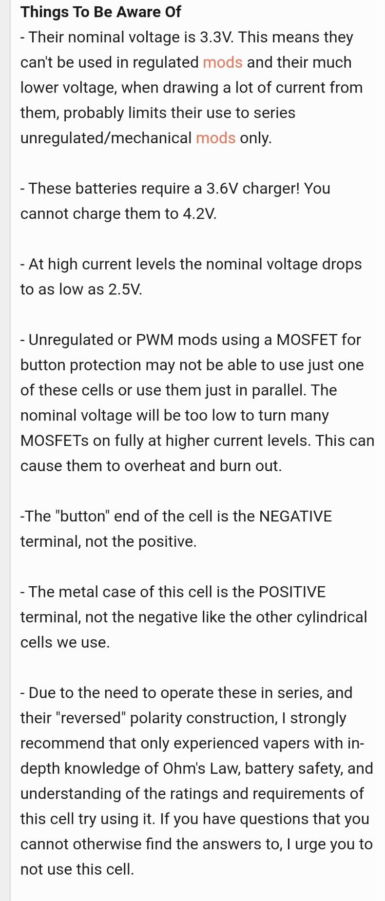

Using these cells on a mountainboard in a diff config probably 13s (42.9v) and charge at 4C (which is 12min from flat to full). Doesnt need to be charged at 4c ofc.
Maybe like a 13s4p 10ah battery with a but ton of amps
Talk me out of it? IDK. I just want to do something with these cells for some reason.
If I recall correctly, they need a special charger because of the nominal voltage right? Everything else looked solid on them.
I think 14s with these cells = 50.4v = 12s liion?
Nominal 3.3v charged 3.6v wonder how shit the range Will be tho
@b264 what do you know?
That would be great since I already have a high amp
12s charger for my tipo.
They charge to 3.65V/cell
12S is approximately 10S lipo and charges to 43.8V (or 42.0V works)
14S is approximately 12S lipo and charges to 51.1V (or 50.4V works)
If you don’t charge to the full voltage occasionally though, the cells may not balance as well
They do have about three times the cycle life as li-ion and can charge at 4C

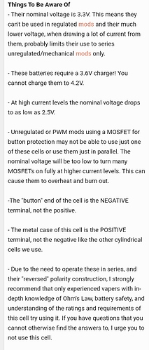

nominal voltage is 3.3V/cell
Found the supposed negatives mooch listed for your consideration, sir
That’s mostly for vape usage
Yes, that is correct… as are 99% of moochs ratings. Yet many still hold those as the unbiased standard for reliable testing because he gives various discharge and charge curves for cells.
