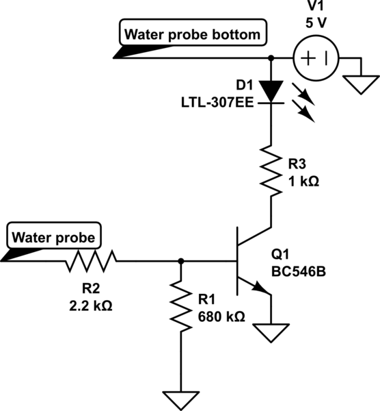

someone may have already mentioned this but wouldn’t it make more sense to put an actual water sensor in the lowest part of the battery box? They’re pretty simple, you can either make your own with a transistor and a couple of resistors or you can buy them.

Moisture sensors might work since we want them to go off for any moisture at all instead of at a certain level or impurity content. Most “road water” should have enough stuff dissolved in it to conduct enough.
