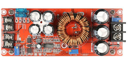

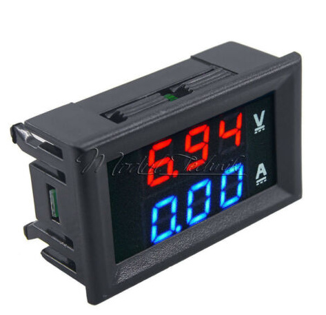

I am thinking of using this DC DC Step Up converter and then have a Input Voltmeter and an output Voltmeter with included Amp Meter.

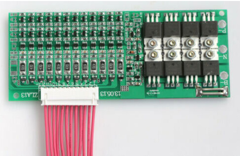

Do you charge your portable battery pack with a BMS or just directly without (I plan on just charging it directly because it’s just a portable pack…)

Protect the portable battery with a discharge BMS in case you forget to unplug it.
My consern would be how dose the board BMS deal with charge and discharge simultaneously?
I am not sure if I want to go the route of an extra BMS. I might just use a Input Volt and Output Voltmeter to monitor the charging process. Also the other Step Up Converter has some kind of a low voltage protection…

essentially yes. so as the module i linked is a step up, it’ll take the voltage from your range extending pack, and pull the necessary current from it to get the 50.4v out at (say 4a). so once your extender pack gets to like 45v, it’ll just pull more current from the pack to push the set current and voltage.
Also, there is a low voltage protection in built, but it’s a bit sketchy. so on the packs i have a cheap charge/discharge bms (over 30a isn’t really necessary) which i have a charge port hooked too and the output with an antispark. so i just open the box, plug in and I’m on my way.
if you just wanna balance charge, you can use a hobby charger, and get a 100v volt and ammeter and just keep an eye on it so the voltage doesn’t get too low (have it sitting between the boost converter and battery so you can see what’s being pulled from the pack)

I would use a step up converter. The onewheel guys use this solar charge controller as an adjustable stepup converter. I have the same setup and it works great, even same voltage to same voltage since as the booster pack goes lower than the main pack, it can still crank power into your main pack while controlling the amps. https://onewheel.wiki/Charging_on-the-go
This would let you use anything as input voltage, for example I use a 12v battery from my small solar setup to charge my onewheel at 58v.

@mynamesmatt Does the Step up Converter get quite hot ?
yeah dude this is pretty much exactly what I’ve done. it’ll work very well. i find it’s good for when you wanna do a longer ride, yet when you do a shorter ride you just unplug it and you’re right. think of it as a power bank for your esk8 (and yes you can charge while riding). and yeah 5a is a pretty good sweet spot. Also you wanna consider the Max current draw. so once the 12s pack is at 3.2v/cell, the pack draw will be just under 7a (incl losses).
without sufficient cooling and high current (7a+), yes. with air flow over the big mf heatsink, you’re pretty right. gets a bit warm but it’s ok.

you won’t need fans no way. I’ve pumped 9a through one of these with no fans and it got pretty warm but was fine. at 5a you don’t need a fan no no no
I’m pretty sure step up converters don’t do well stepping up to such close voltage differences-, like 12S to 12S charge voltage.
Is this what you said you were doing?
I’d recommend 8S, maybe 10S as supply so that it can effectively step up voltage to 12S. Everything else sounds great to me.
nah it does it fine. it essentially acts as a pasthrough at first, then as the voltage goes down, more current is pulled to get re desired voltage
I think thats the beauty of a switching converter… there is no real “deadzone” or “dropout limit”. Depending on the efficiency you might only lose some % on the output side.
So I also think it should do fine

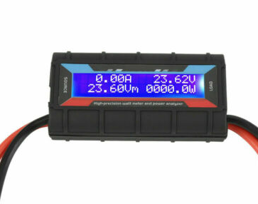

The Step-Up Converter and the Wattmeter.
I was able to regulate to a stable 50,4V even with my lab supply ranging from 8-17V for the first test run… seems very stable.
As soon as I get my battery I can set the current limit and then there is only the BMS and the case missing…
