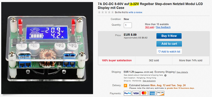

Sure you can… I got the exact same one already but for lower voltages - I use it as my lab supply it’s perfect for DIY Projects and to limit current to detect shortcircuits etc.
Yeah… they are super cheap - there is also versions available with bluetooth etc.
I have mine running for years without issues… also EEVBlog reviewed one of those and said it’s a really good product for the price
So yeah basically with this DPS it is possible to make a 14S Pack and regulate it to a charging voltage of around 50V and limit the current to around 4A.
Then as the 14S Packs gets “drained” the output voltage will automatically fall off and probably stop charging by itself.
So that should be safety enough to not overdischarge the charger pack (I guess)…
Also thinking about it more properly… I am about to build a 0-50V Portable Lab Power supply with 20A Current… I mean… this would be perfect not only for esk8 but for basically…
