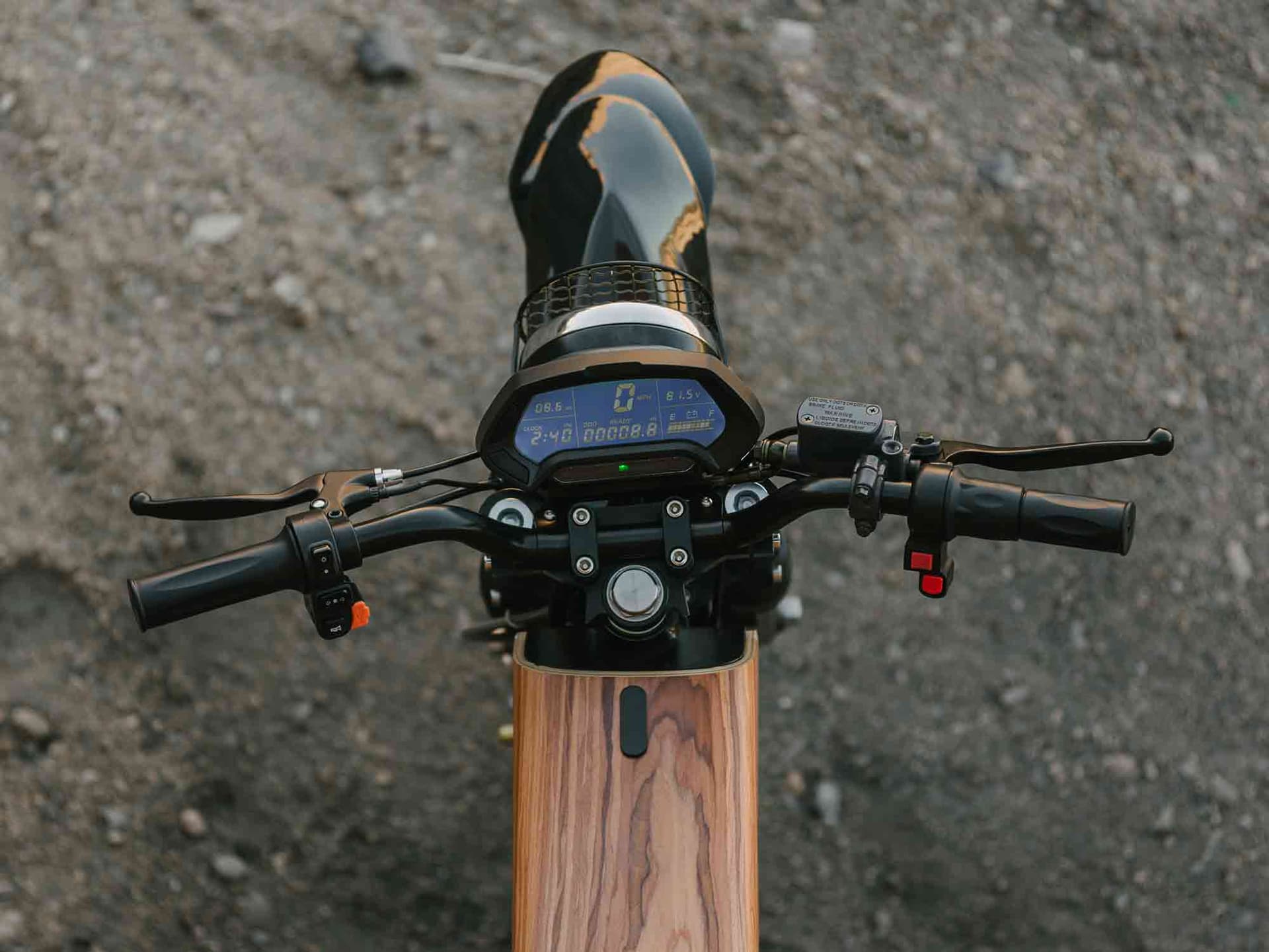

This is actually very interesting personally speaking. My biggest issue with ditching the stock Kelly ESC for something VESC based is that I would have to separate all the rest of the bike controls like lights and turn signals out to switches.

Bike already has rocker switches for turn signals and speed mode selection.
Another rocker switch for low and high headlight
A button for the horn
Brake light is activated through the brake levers
Then another button for power on/off
It would take a lot more relays and rewiring though under the cover as they’re all running through the esc currently. They’d all require new hookups to a step down converter vs the esc acting like the main hub.
