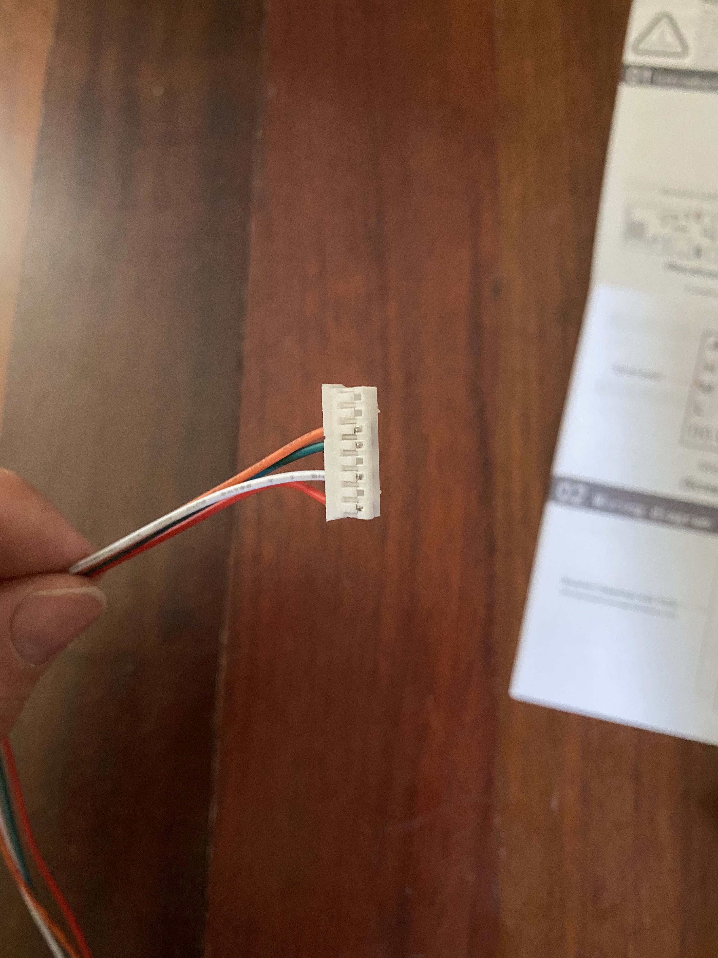

Hi everyone, I recently ordered a Stormcore 60d along with a vx2. However, I accidentally ordered the vesc6 version, while the stormcore is a vesc4. Would anyone here know how to rearranged the remote receiver cable pins so it would fit the UART port on the stormcore? Thanks
no, its not…
follow this diagram and wire it to the primary (the side with all the ports, not the side one) UART port, u can switch the pins around if u lift the tiny white tab and pull the wire out, and push it back into the appropriate hole
ah thanks, im just having some trouble lifting the white tab. I tried a flathead screwdriver and its too big to fit into the slot
try paperclip, works for me
I use a razorblade and just be very careful and go slow.

This worked I think i figured it out, thanks!
