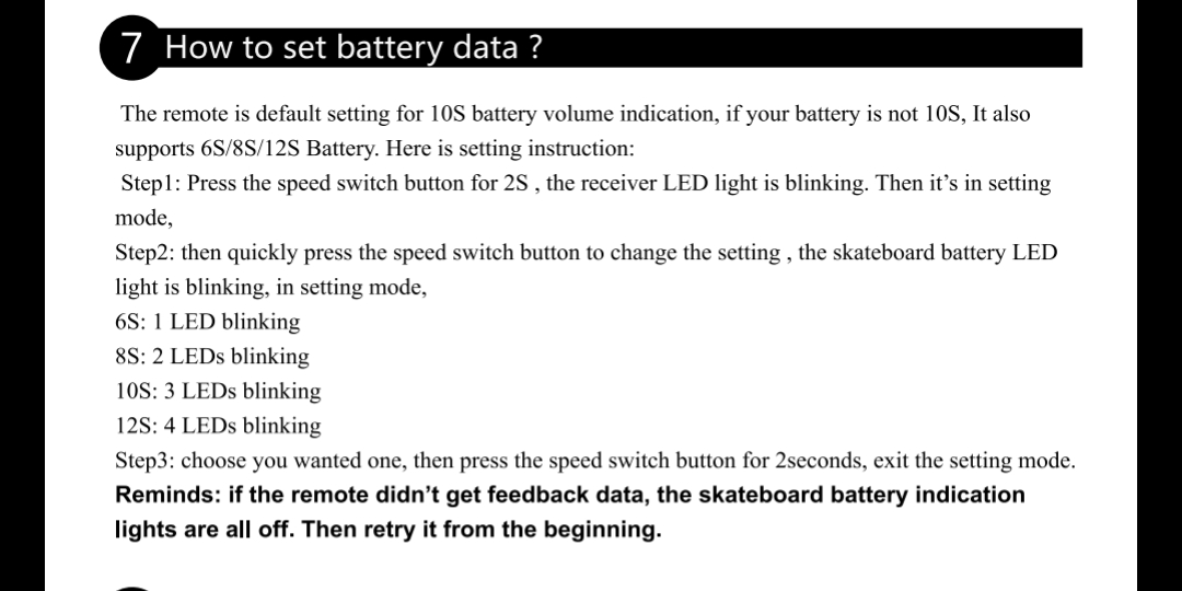

Noticed today my flipsky vx1 pro remote isnt showing battery level properly. When my 10s6p pack is at 37v its still reading at full charge (4 leds) when it should be reading maybe half charge? Anyone have any idea what i can do? Blue wire that is used to check voltage with the reciever is connected directly to the positive of the battery pack and the connection is not damaged in any way. Maybe the reciever itself?
Check if these settings still work (taken from the vx1 non pro)

Theyre still the same for both. Plus by default its 10s but yes it is set for 10s
