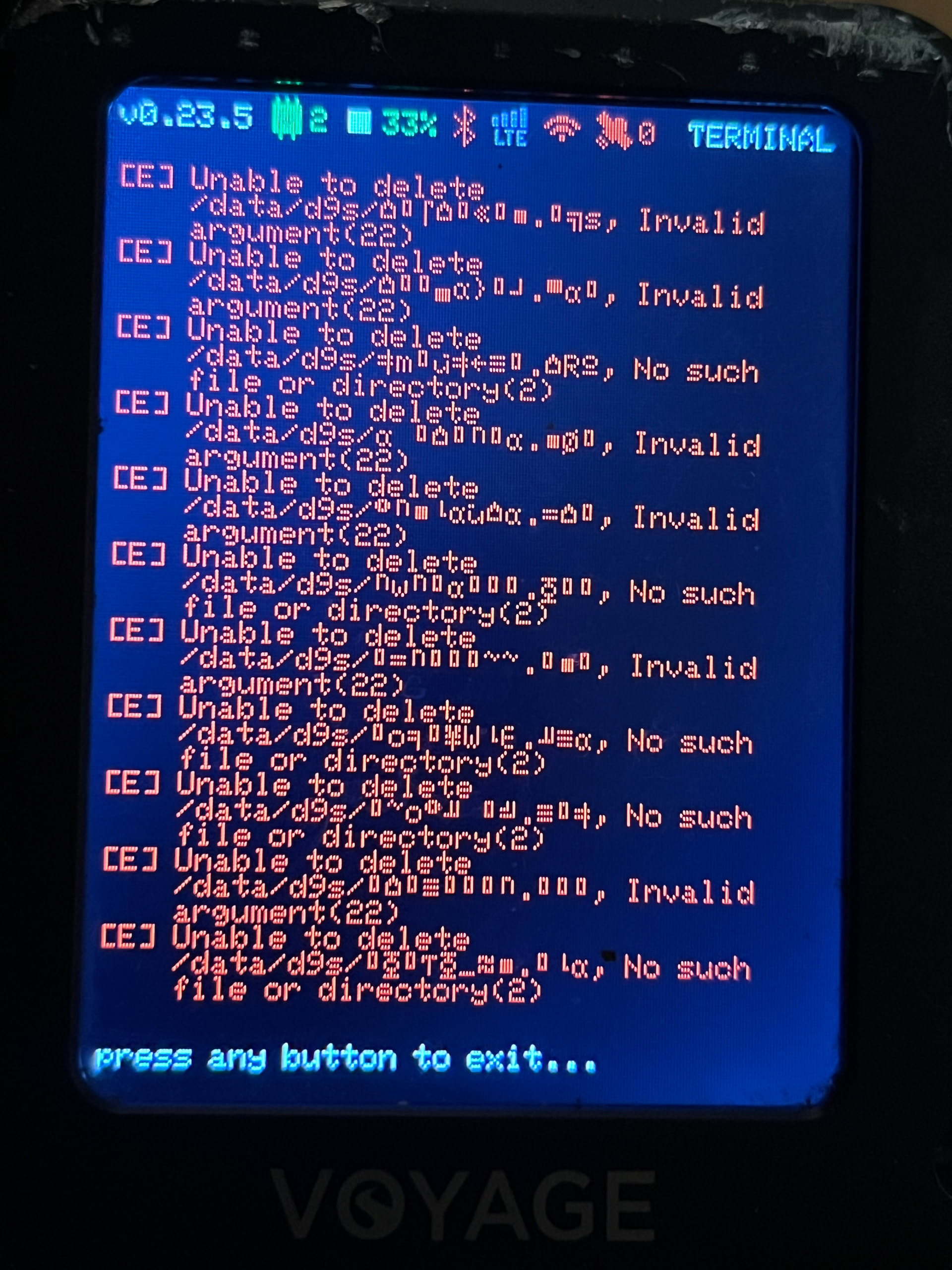

I’m having trouble getting proper recordings with the Minnie. It doesn’t always record, and when it does, the recordings are often incomplete. Most of the time it starts recording at some random point and then stops while I’m still riding. I also can’t manually start a recording. Is this normal, or am I doing something wrong?
Getting a lot of errors and failing to get logs - did a factory reset and formatted everything a couple times. @janpom any ideas on a fix or next steps?

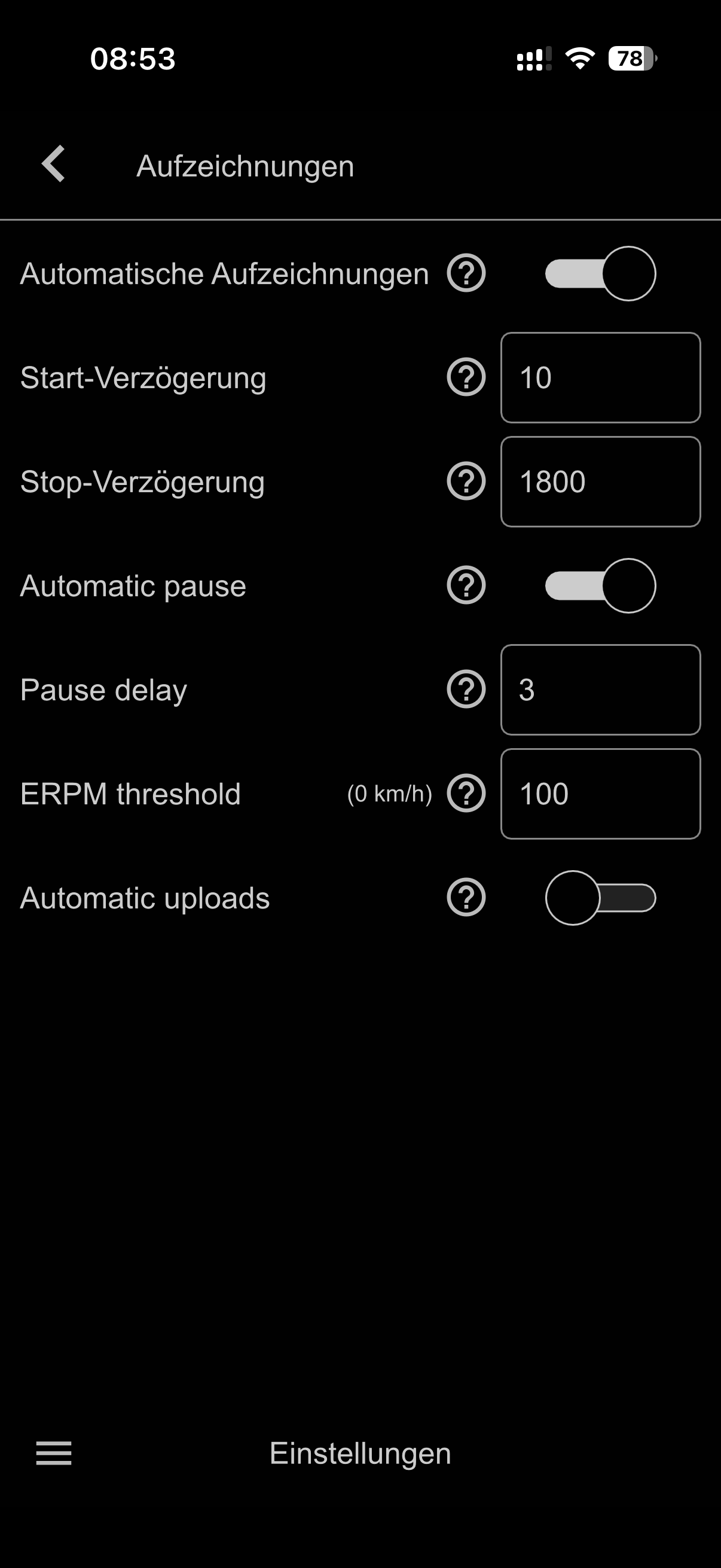

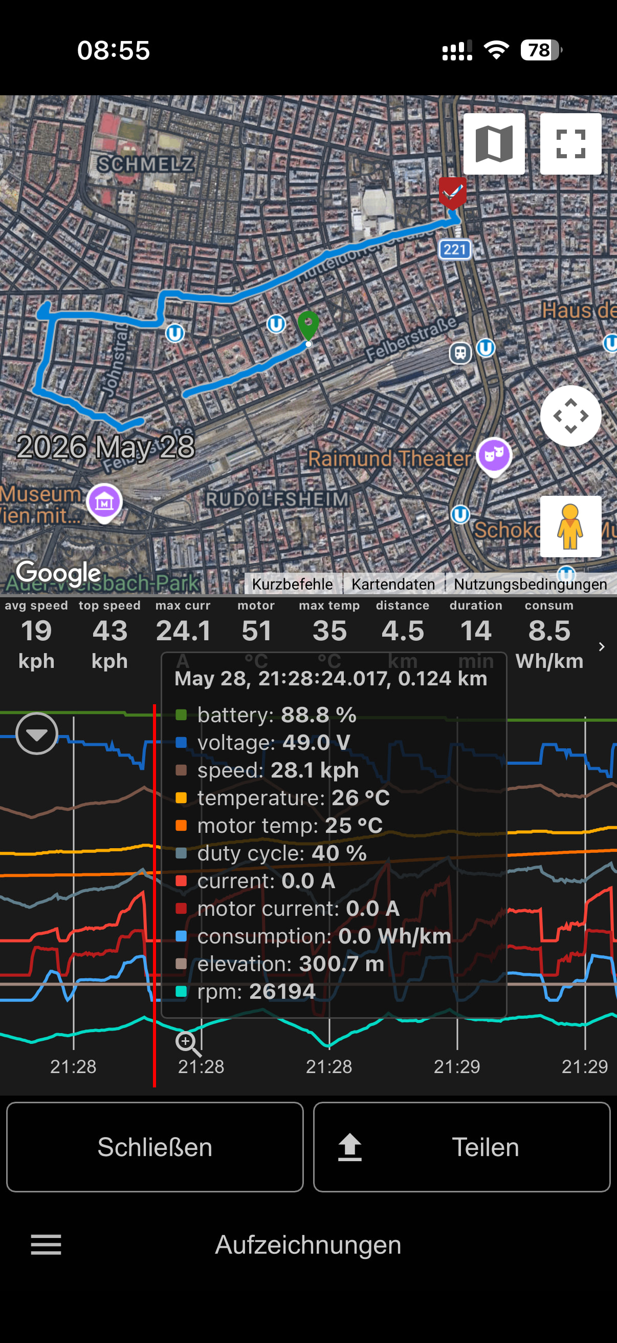

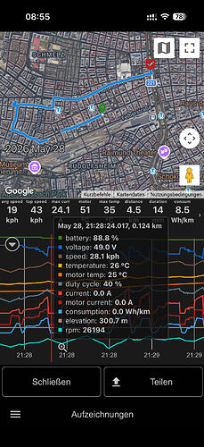

That happened to me as well, but in my case it was caused by having the Metr.at app connected. Could this be the same issue?
I have used the meter app but haven’t in a while. I was using it before so i could access the logs. What was the fix? Just delete the app or something more complex?
Edit: had to factory reset a while ago and did the setup via voyager connect but meter app prompted an initial setup also - completed that and seems to have sorted it out! Im gonn do a little test run and see how it handles a new log. Hopefully all set
@janpom „Does the Megan Terminal Screen display live VESC Lisp (LispBM) print / COMM_PRINT messages directly from the VESC?“
Oops, missed the question, sorry, but better late than never :slight_smile:
No, the terminal screen only displays messages coming directly from Megan.
