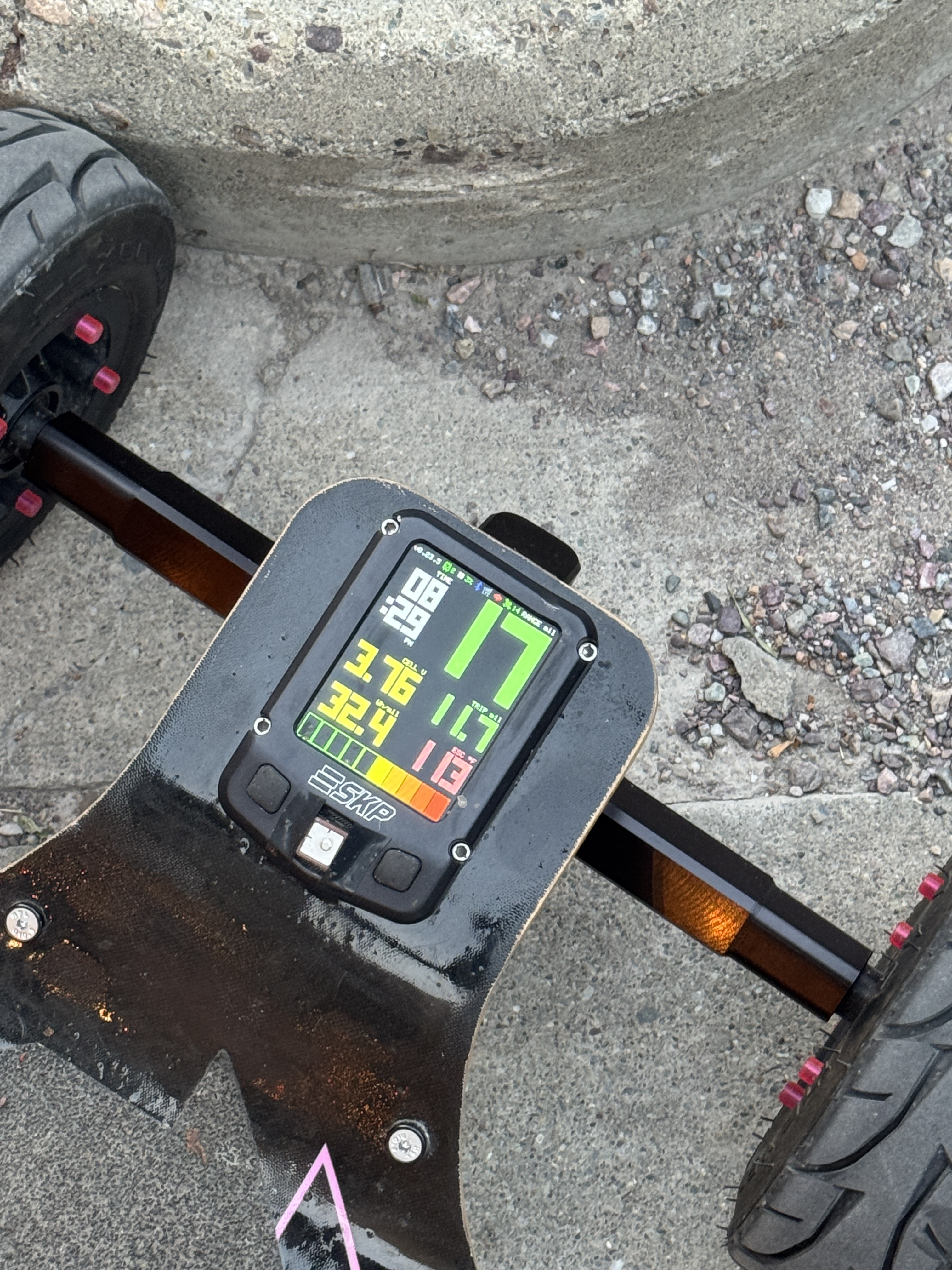

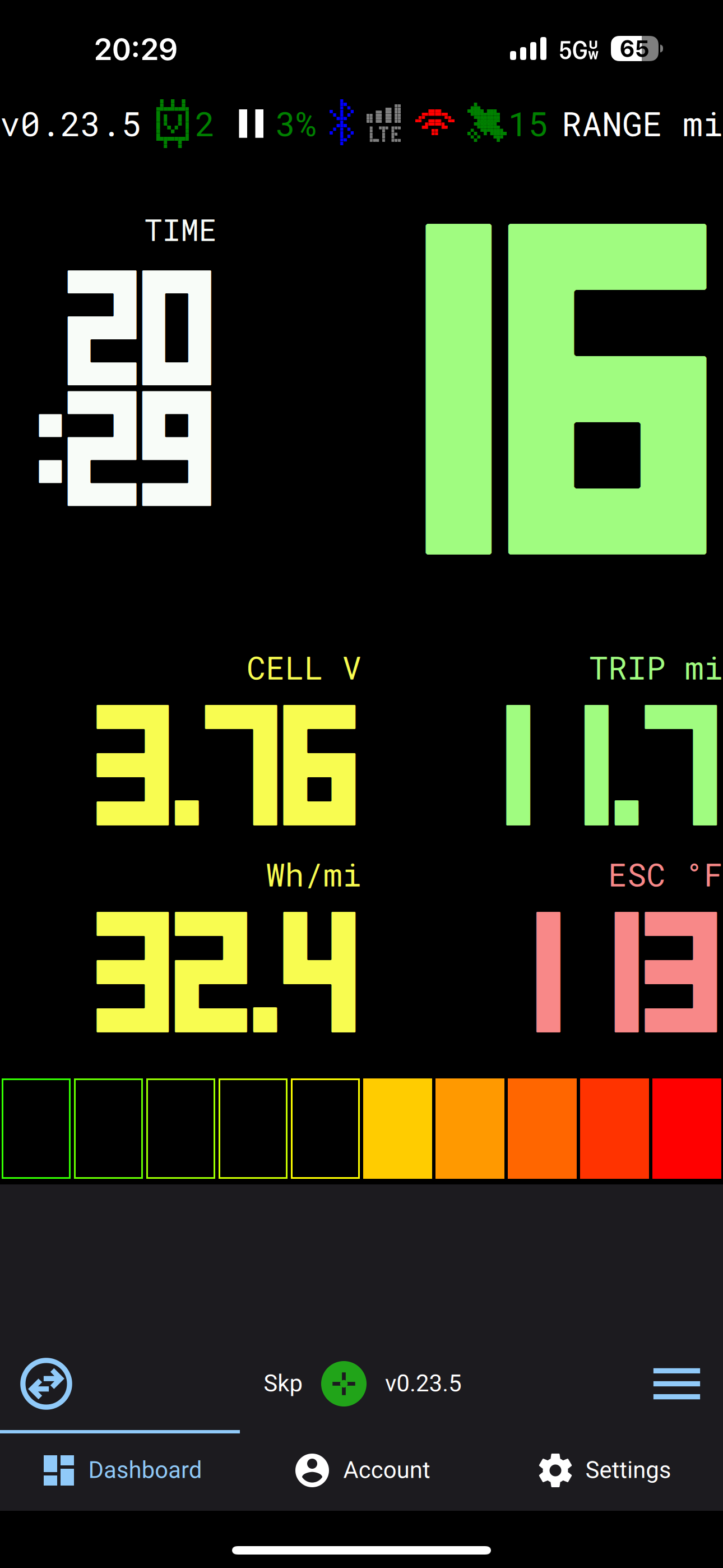

I have the Megan configured with 24 hour time (the one true way) and it shows up like that in the app, but on the unit, it stays in the 12 hour time format. I’ve toggled it back and forth and seen it change on the app, and seen the Megan refresh the display, but it never seems to change to 24 hour. Possible bug?

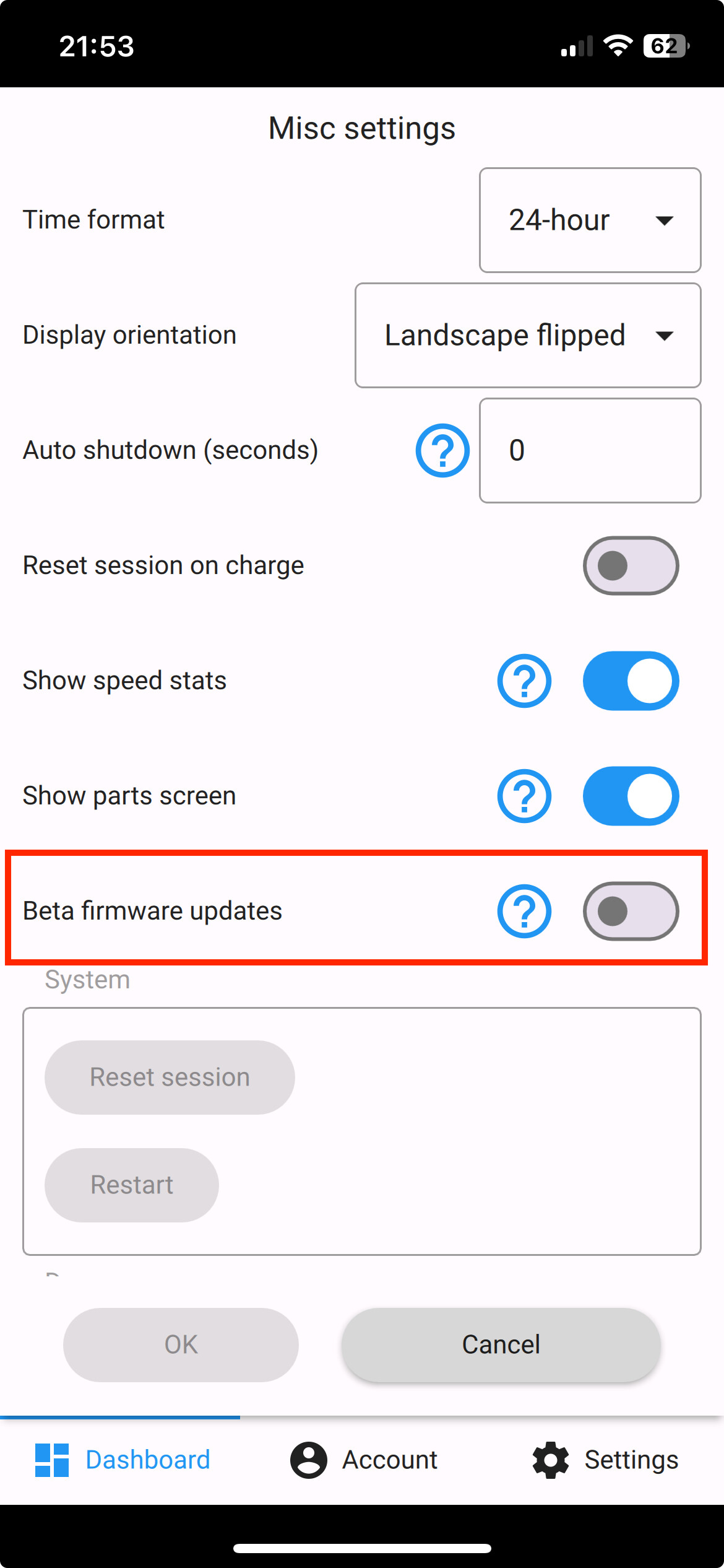

You need firmware v0.27.1 or later for that to work correctly. v0.23.5 is the latest stable. You can enable beta firmware updates in misc settings and then update the FW. Beta releases are generally very stable. There may occasionally be a glitch in a specific functionality but other than that it should be safe to use. We are maybe a bit too conservative in what we release as “stable”.
With your current FW, the time format follows the unit settings – metric = 24 hour, imperial = 12 hour.
@rpasichnyk, can we hide the “Time format” setting in the app when it’s not supported by the connected device?
Awesome - I’ll run a beta.
I can’t help it that I live in a country with backwards standards :sob: :sob: :sob:
24 hour time is not considered metric or imperial.
No, but it is considered superior :kissing_heart:
found a clip of how it was before

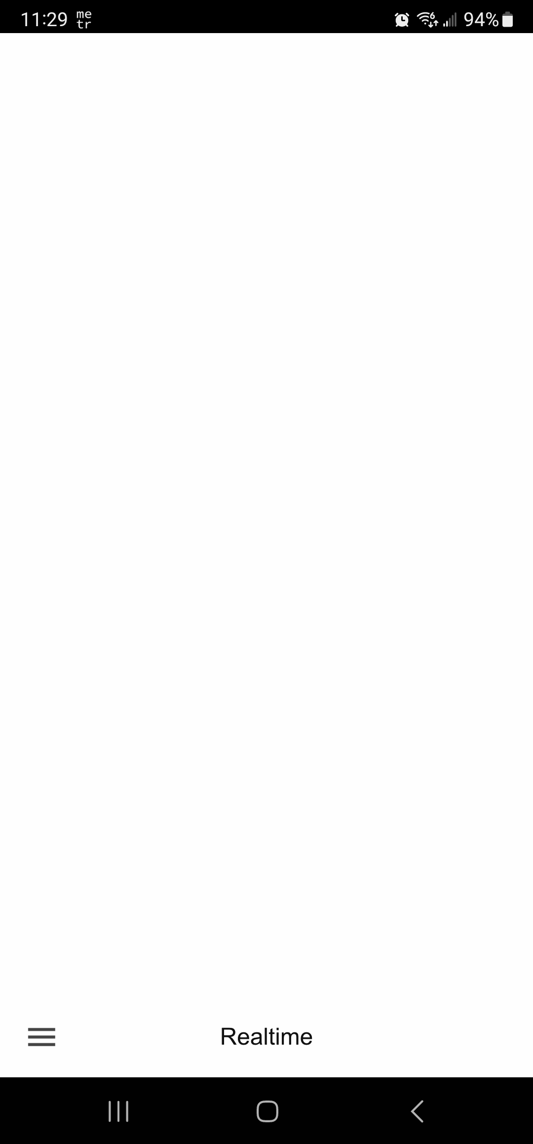

I just grabbed a new mininie can, put it in the board, opened the metr app and all i get is blank white screen on every screen?
Uninstslled/reinstalled solved that problem. Now I’m getting this… otherwise it’s working great. Just can’t update it
Tried updating via the voyage app instead of metr?

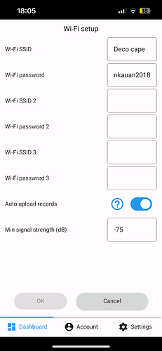

I can’t connect the voyage mega to Wi-Fi !!! help!
I’ll give that a go this eve
Maybe you’re too far from the Wi-Fi AP?
No amigo , no meu app não aparece uma pesquisa de Wi-Fi vou mandar um print
I typed the name that appears there manually
The WiFi module on the ESP board is only 2.4 ghz, so make sure that network has its 2.4 ghz radio enabled.
Also, on signal strength, change it to -90 to help.
Thanks friend, it worked here!
