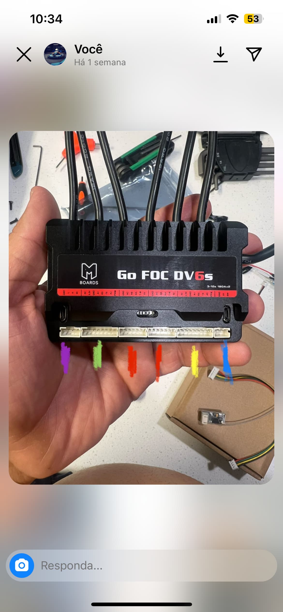

I just bought the Megan, but my DV6s does not have the ports almost all open use, blue power button, yellow the receiver of the remote vx4, the two red the motor sensor, the green the bluetooth receiver of the esc, only the purple one left which is a 4-pin input,
Will it work correctly if I connect it to the purple input? Can someone give me some help
Purple is can, megan has can

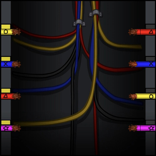

Megan works on CAN. That’s a start for you. Figure out where the CAN port on your ESC is and how to wire it from there. It’s pretty straightforward.
It’s literally this, but replace the colors with the pin labels

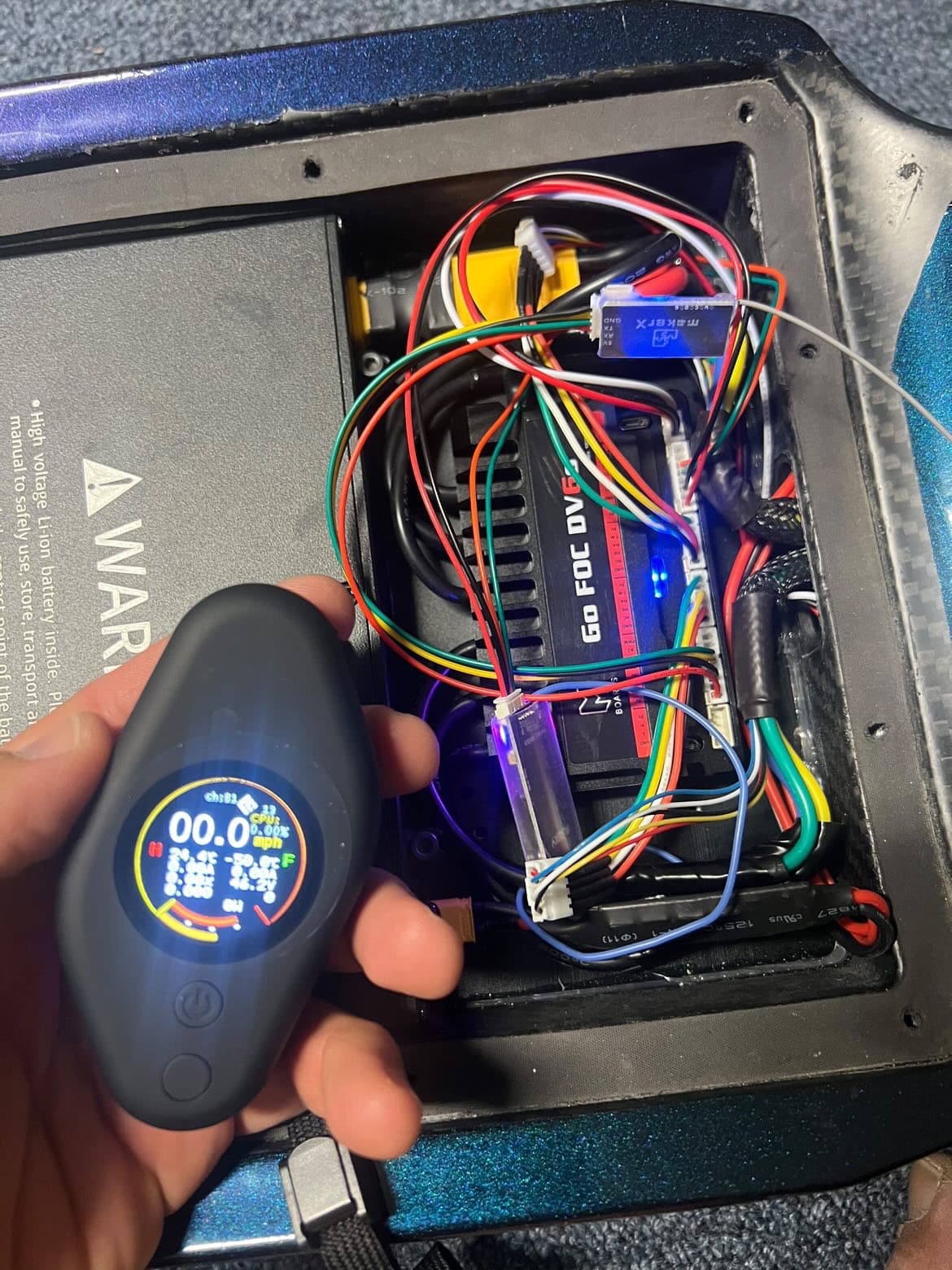

Ok feeling kinda dumb. Can someone spoon feed me how to set the megan display to freedumb units? I can get the app (metr) and records to display in freedumb but I can’t seem to do the display. I know it’s probably so easy I just keep missing it lol
What’s a freedumb unit? Never heard that before.
mph :joy:
Aha! My first thought was that ā€œfreedumb unitā€ is a ā€œfreedumb ESCā€. Some brand I have never heard about. :laughing:
I’m afraid we only have the metric/imperial toggle under the expert settings. We should probably fix that. @rpasichnyk
