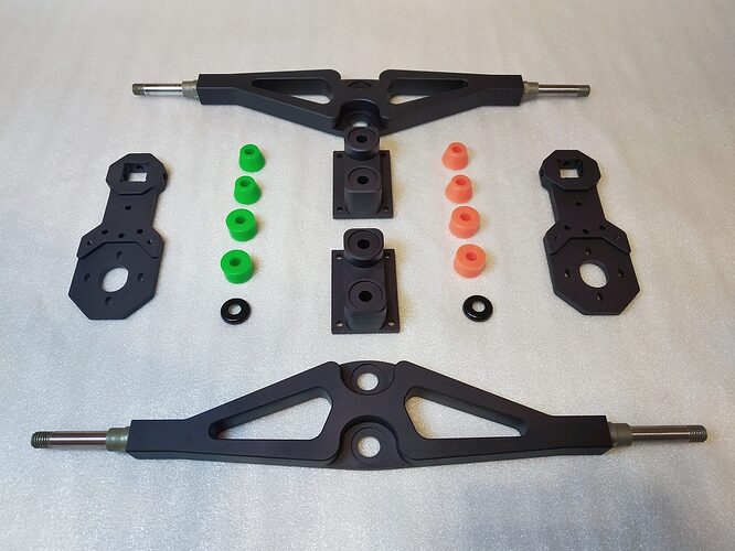

As some of you know last year i released my mountainboard deck. And what needs a mountainboard deck? Correct - trucks!
So here they are - VOLOKNO DMT - double parallel kingpin mountainboard trucks :slight_smile:

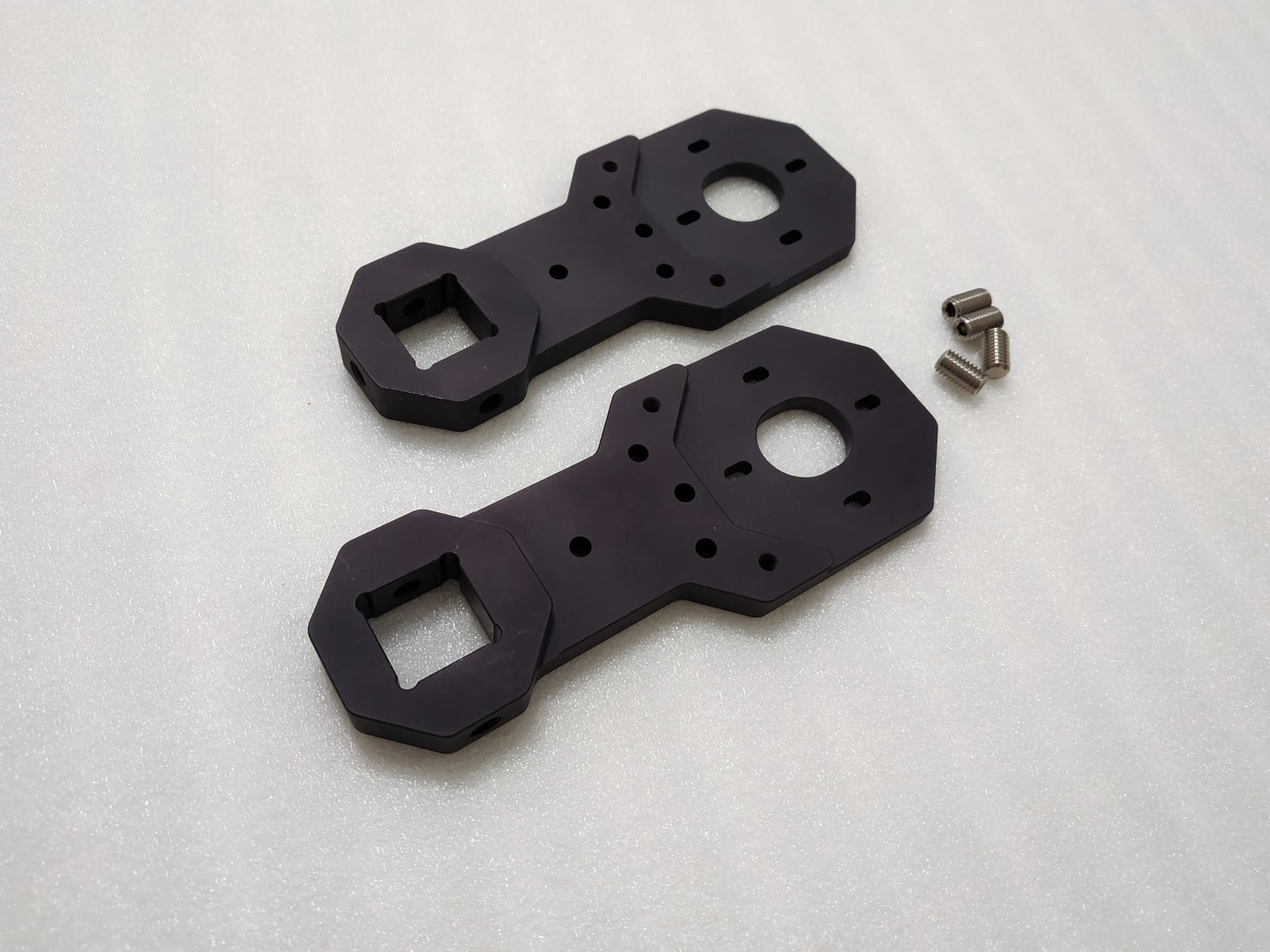

Motormount - 115$ kit (2pcs)

Trucks:
Materials: machined from a block of 6061 aluminium
Dimensions: 464mm wide (324mm hanger)
Bushings seat: standard 24.7mm
Motormount placement area: 22x22x30mm
Weight: 1150gr
Motormount:
Center to center distance: 106-110mm
Hanger placement area: 22x22mm
Thickness: 14mm base, 10mm body, 6mm motor placement area

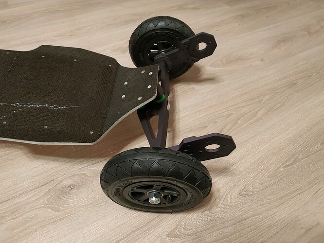

The trucks look sick! May I suggest a king pin cover for a possible v2, looks like they could get caught on stuff, especially in offroad situations.

That’s an interesting design, did you come to it after FEA or just for looks? Only bringing this up because it looks the thinnest in the center circled in red and thicker where I circled in blue.

good idea, but if you need - i can send you a spare kingpin + nut for 3$, and i am not sure that a design and production of an additional kingpin cap will cost less than 3$
yes, i made the the first model just for looks (by eye) (blue model), but then i made a lot of simulations to make this trucks reliable and remove all weak points. grey is material that was added in the version that was produced.
i am not a fan of high speed so i can not tell anything about pkp tucks higher stability on high speeds, but after several rounds around my workshop i can confirm that this trucks have what i looked for - better “steering” on low speed (compared to regular trucks with springs)

I like that they’re not entirely symmetrical. I’d like to see what the difference feels like, with the hanger one way vs the other. 2 questions; do you know off hand if the distance between the kingpins? I wonder if your hangers and baseplates would be swappable with apex’s. Also, any chances of you ever working on a 35-45° baseplate to run these on street boards without complicated risers or brackets?
Wait, one more question, I couldn’t tell from the pics. What’s the bushing seat like? Can I run fat cones/chubbier?

It was more of a safety concern, although this is purely hypothetical, pkp trucks are a relatively new concept and so far I haven’t heard of anyone becoming superman because the kingpin got caught. :smiley:
Plus covered kingpins add style points imo. :smiley: Its also something your competitors aren’t doing, so it would make you more unique.
I hate to be the bearer of bad news but that’s not a DKP truck, DKP trucks already exist and they use 2 kingpins in series, not parallel.

on my trucks this distance is slightly bigger so my hanger will not fit apex baseplates
i am not sure that i will make such baseplates
bushings seat is 24.7mm (0.975") diameter and 2mm deep
