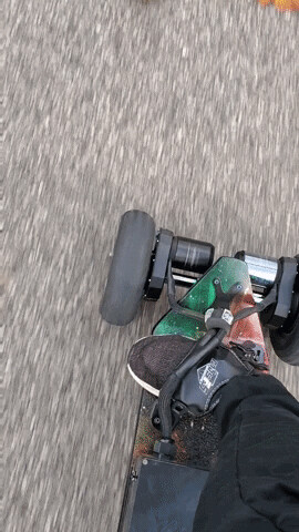

The motors on my daily driver street board have recently taken some big scratches. I’m looking for something to cover them up. Does anyone wrap their motors? If so, what’s the best way?

I’ve used normal 3m backed vinyl wrap off amazon with a lot of success, for a little while I had my motors wrapped in reflective tape as well.
Basically just a matter of applying the vinyl on smooth while periodically heating it with a hair dryer to soften the adhesive a bit then trimming the excess with a blade, if you look up vinyl wrapping tutorials on youtube you’ll definitely come across some helpful methods.
Like this?
Any thoughts on heat dissipation? Maybe some kind of coating or even white/reflective instead of black. I can put the can in a lathe and cut some shallow fins into it.
I had mine wrapped for a while and saw zero difference in motor temp

Pro tip: clear shrink wrap your vinyl wrapped motors, it keeps the edges from coming up and it’s easy to cut off and reapply if scratched
