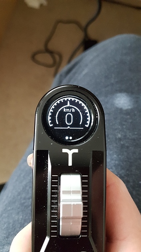

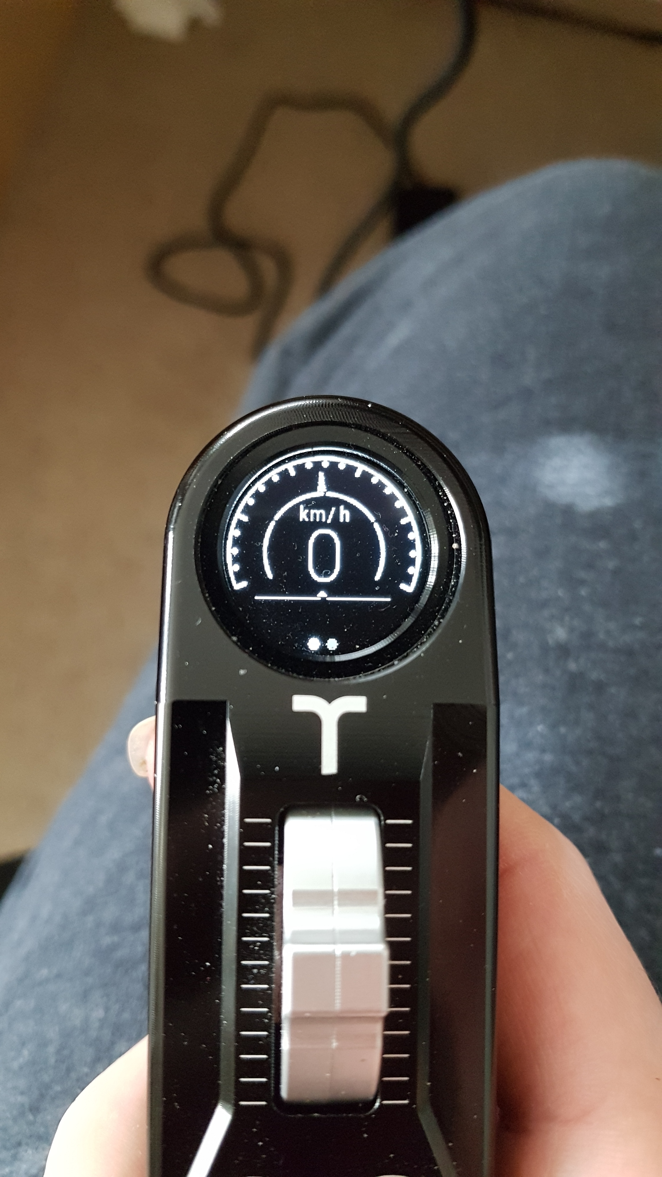

The code will be uploaded to Github. The issue looks like HW related. What does the throttle indicator say. Is it centred?
Wand FW 1.1 : no issue
Wand FW 1.2 : issue
Is this really HW related ?
If so, WAND HW issue I assume.
So, please tell me how to send it to you to have a replacement one. Thank you.
I need to double check how it could be possible that there is a difference in throttle neutral between the two FW revisions.
Once the github repo will be updated, I can help you doing that. :wink:
Could you try to switch on the wand with the right button? Maybe you got some CC holding the left button while switching on.
If the current release firmware for the Wand gets posted I’d be happy to take a look and post what I find.
Plenty of reasons a code change could impact how an ADC is read, and looking at the V1 Wand code there is a good amount of filtering happening on the joystick input.
The only difference in between the 1.1 and 1.2 FW is “immediate responsiveness” after switching it on or reboot and FW version display.
The rest of the code is the same. I’ll tell Benjamin to update GIthub.
Nice spotted.
This is the issue.

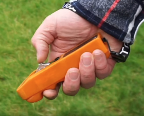

Rad Board Customs also sells some 3D printed remote covers for the WAND that are supposed to make it more ergonomic. Have you tried these?
