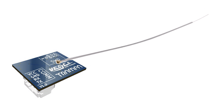

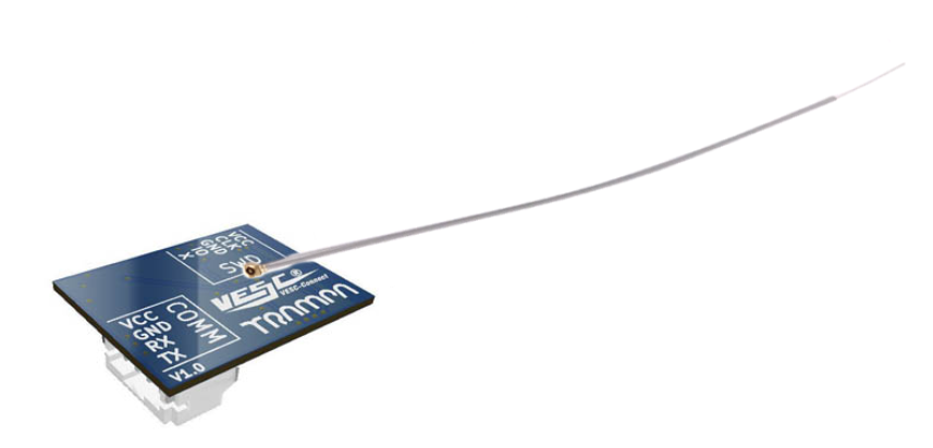

At least offer a version of the receiver that has an antenna that can be put outside the enclosure for people that have carbon or metal enclosures.
Like this

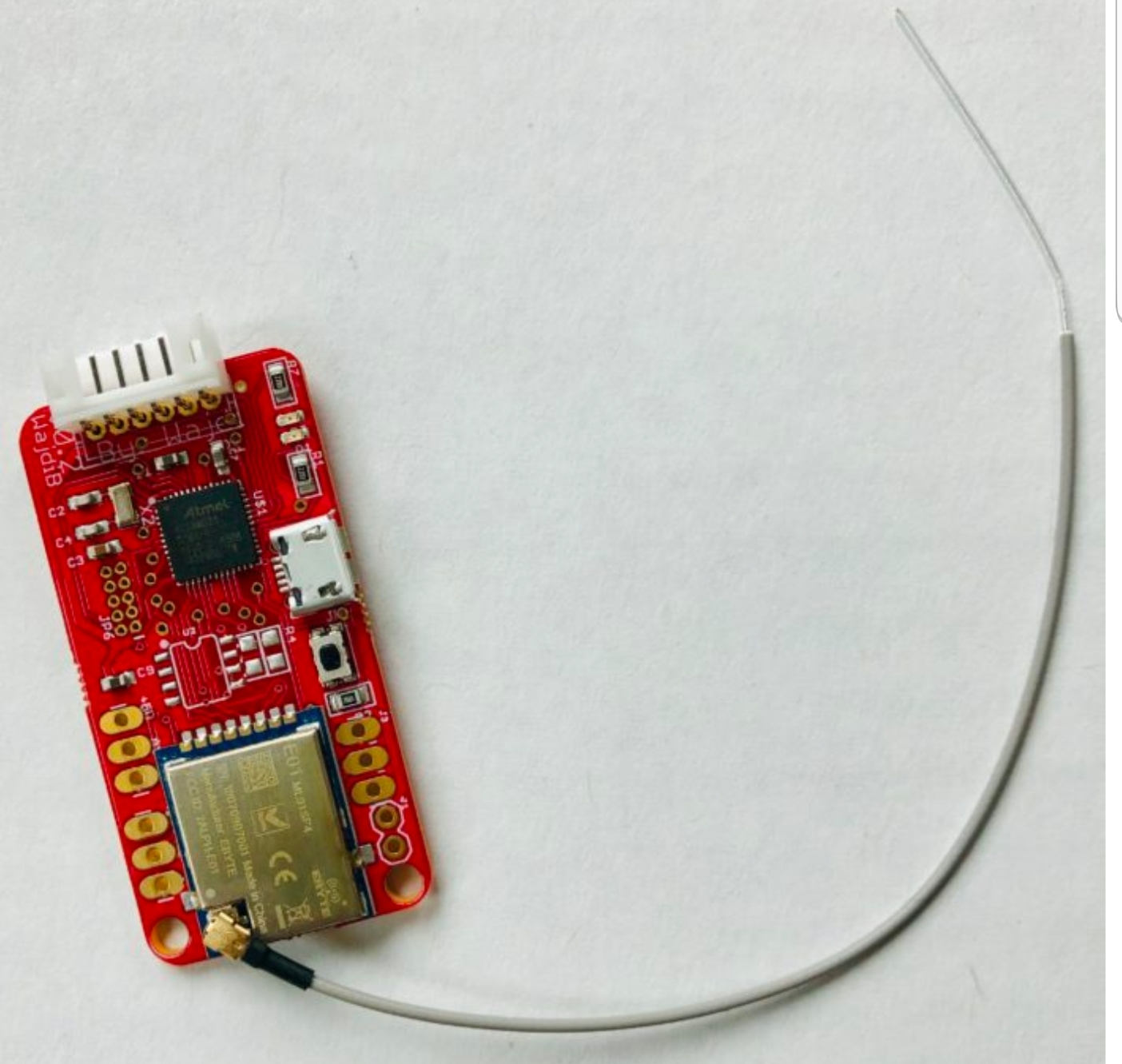

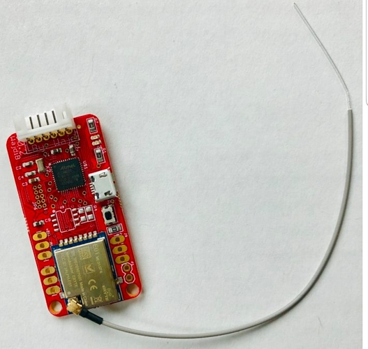

Over even like this :stuck_out_tongue_winking_eye:

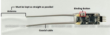

Modern RC receivers actually have two independent receivers built inside with two antennas so that the two antennas can be placed in different locations. Then it can take whichever signal is stronger at the time. It greatly reduces dropouts. They are even really small. This is a safety feature I personally would like in a next gen remote. Dear santa :santa:
http://www.myrcmart.com/radiolink-r12dsm-24g-12-channels-dsss-fhss-receiver-p-11688.html

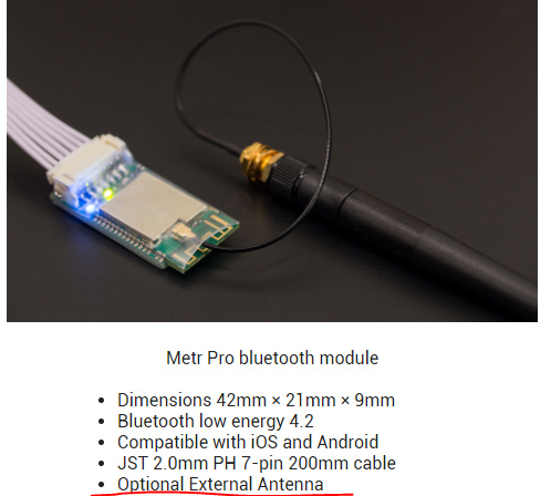

@LR-designs Even photon had thought of that
