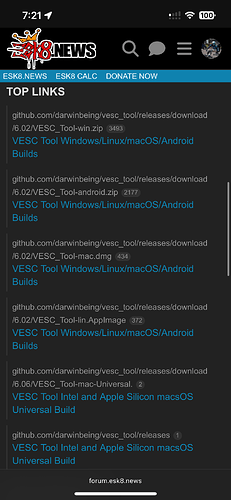

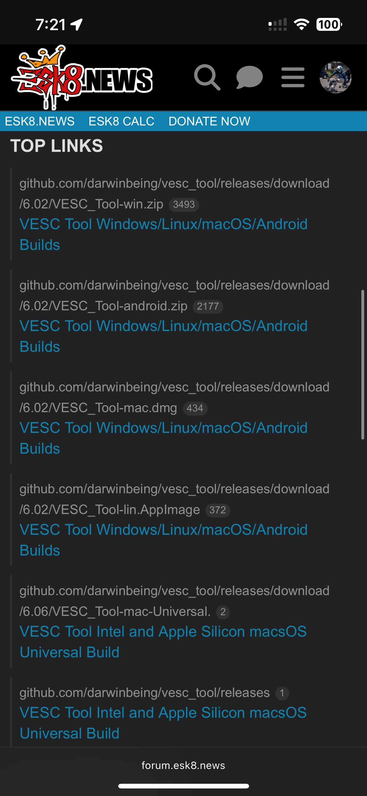

lol the link has been clicked 5 thousand+ times?
Definitely a scammer

look at the commits in the GitHub repo. all VESC Tool code is mirrored from Vedder’s repo. nothing has changed except patches to the build scripts to allow usage of GitHub CI runners for automated builds.
this profile has 5000 clicks on their links because, until 15 minutes ago when Marcel unlisted their 2 year old thread, it was the 5th result on Google for “VESC Tool download” and the only result with an actual download button.

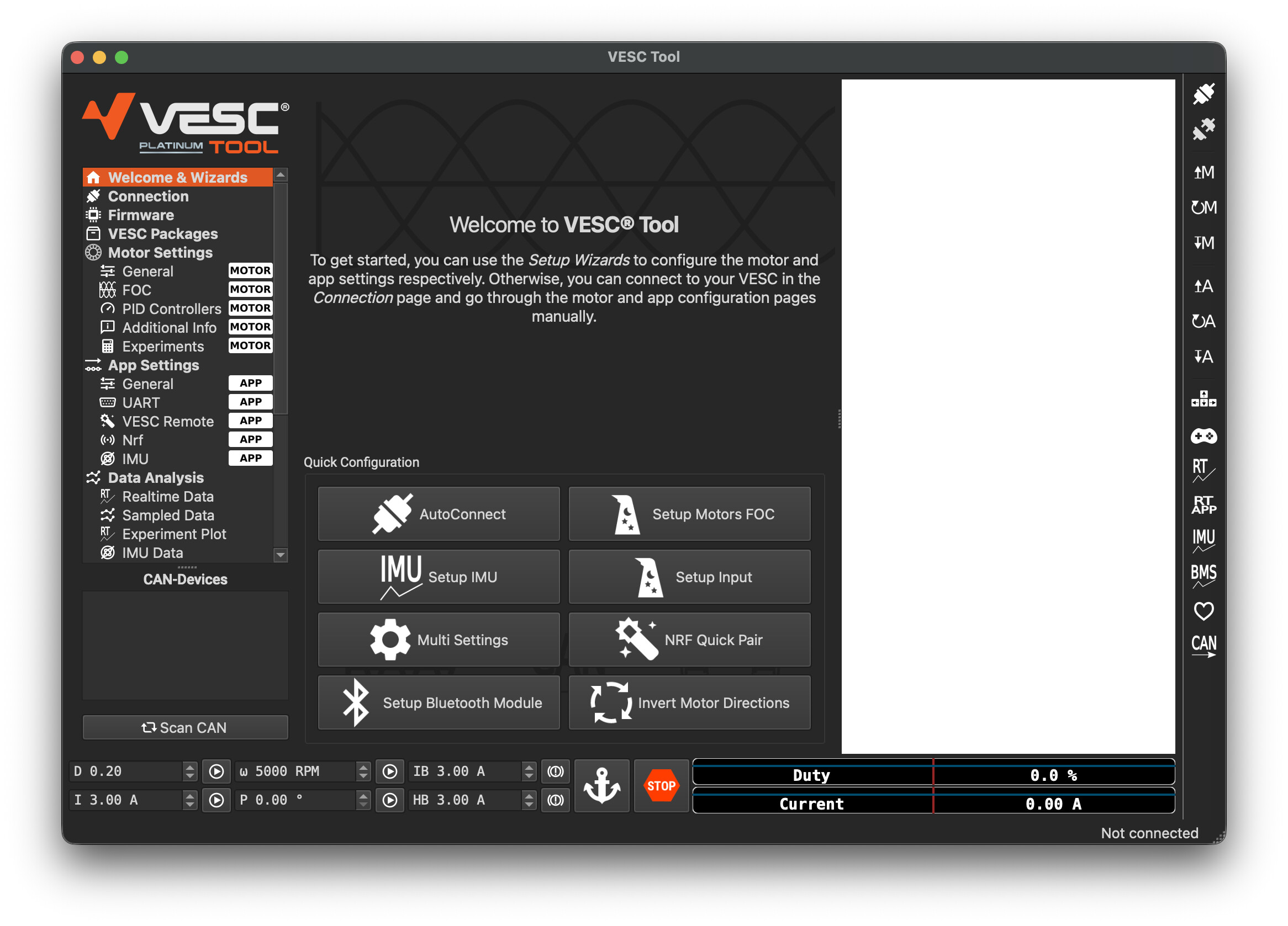

hi, thanks so much for your efforts! I just tried the universal build on Apple Silicon. unfortunately, the realtime data window is blank:
also, the Bluetooth permissions don’t appear to work correctly. every time I open the app and scan for devices, it asks for Bluetooth permissions again and no results appear in the list. I’ve tried adding the app to the allowlist manually as well, instead of just waiting to click the allow button when prompted. you might need to add an ad-hoc code signature for permissions to stick, I’m not sure.
one other minor gripe is that the application is about 7x as large as an Apple Silicon native build I compiled recently (granted, that one did not have firmware bundled in).

Regarding the realtime data window showing blank on Apple Silicon: have you noticed the same behavior on other versions, such as 6.02? It might be expected under certain conditions, but I can look into it further.
@Deodand hey Jeff, why is this the case?
it’s something completely new, I’ve never experienced it on any other version. and like I mentioned, on my own compiled version of 6.06, it works as expected.

Thanks for the feedback! I don’t have VESC hardware or an Apple Silicon computer, so I’m not able to fully test whether everything works correctly. I just uploaded all the possible macOS builds I could provide — x86_64, arm64, and the universal version.
