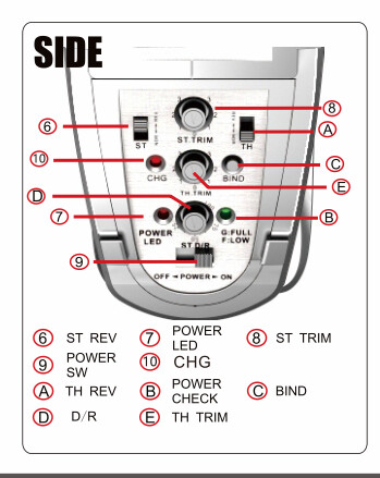

I have a new GT2B mod remote and was trying to setup the VESC. When doing the PPM wizard I set the min and max values - however on my GT2B the max is reached when I push the throttle and the min when I pull the throttle. The behavior should be the other way around but I can’t seem to find a setting in VESC tool that allows me to switch this. How can I set up the GT2B correctly?

That does not help - the VESC still registers braking and accelerating as before and simply switches motor direction
flip switch A.
Thanks a ton - that helped! Still wondering why the VESC can’t just do it in software though. Seems so trivial
