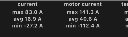

I would strongly encourage anybody with braking current this low for fear of damaging cells, to go and find some metr data from a similar build and observe braking currents in said data.
That’s a really good point:

Negative 35 is the worst I’ve done and iirc it was an emergency stop. Didn’t realize i was hitting 140a motor so consistently ¯_(ツ)_/¯
And that would have been a spike for a fraction of a second
Okay but what about the data sheet, pretty sure it says if the cell ever sees anything even slightly beyond the spec they will instantly explode soooo
/s for the dummies out there
I know you’re be hyperbolic but the sheet does say 10a pulsed, 6a high continuous and 2a continuous for the preferred . If you dig into the testing method and plotted the cell charging amps vs time you could probably get real cell max input numbers for short duration high amp input capacities… what you would probably find though is that you can’t max them out with these conditions unless you go get some crappy unbranded non power cells.
All my peak negative battery amps, and im on the brink of loosing traction and leaning hard, are fractional seconds.
That would require actually reading the entire datasheet, and understanding/properly interpret it. Not common in this hobby

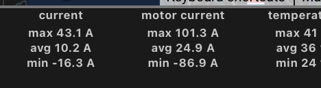

where can i look at other peoples builds and setting in detail to analyze?
you’ll have to ask people directly about exact settings but if you look up “voyagesystems.eu” in the search bar, you’ll be able to find some ride logs people have shared. you can find diy builds in the “diy-builds” category
and here’s the log for the highest regen on there
