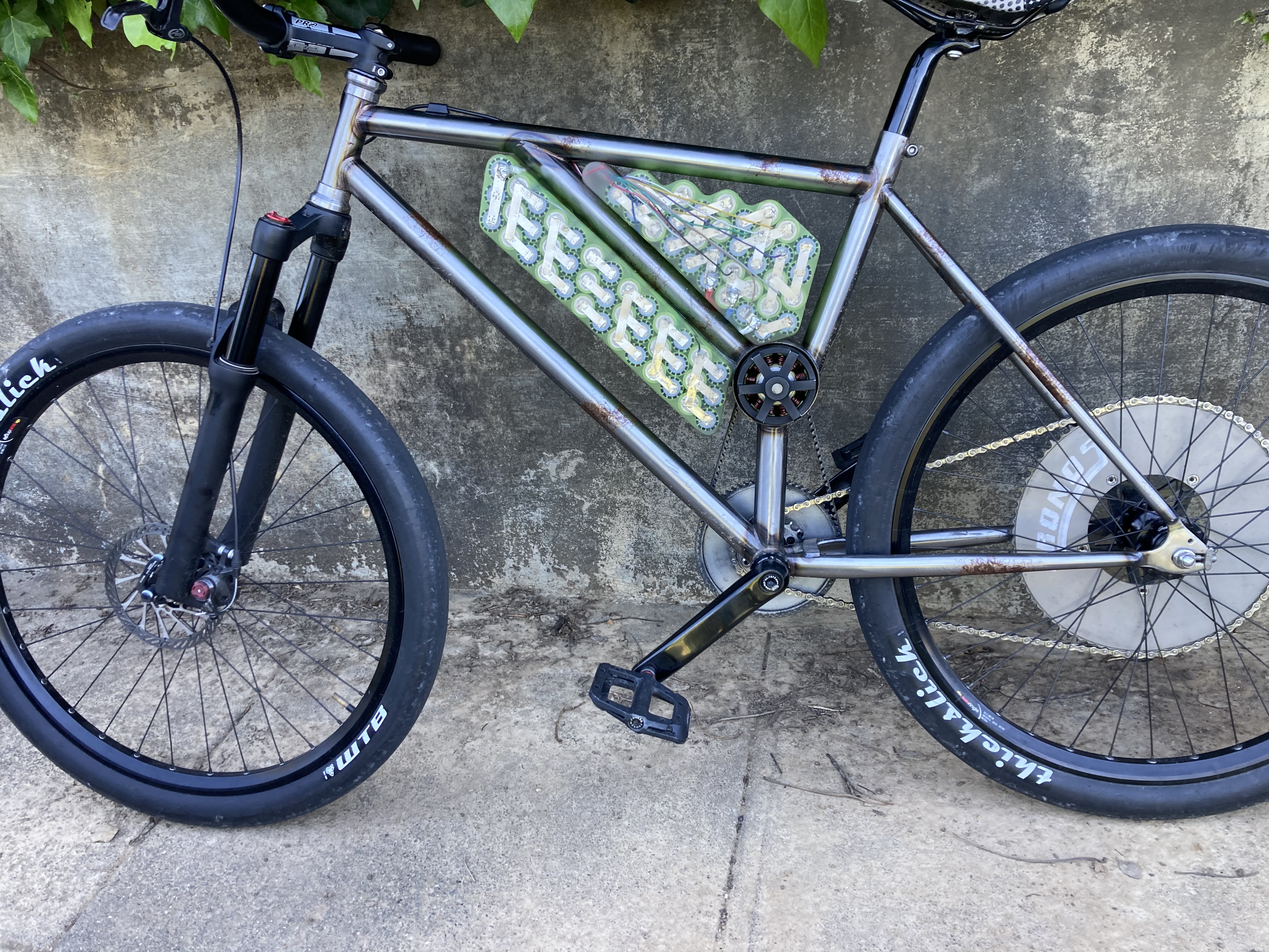

Itll do 20mph, it’s a hardtail so there’s no supsension. I wanted it as low as possible, it’s fun as shit to ride.

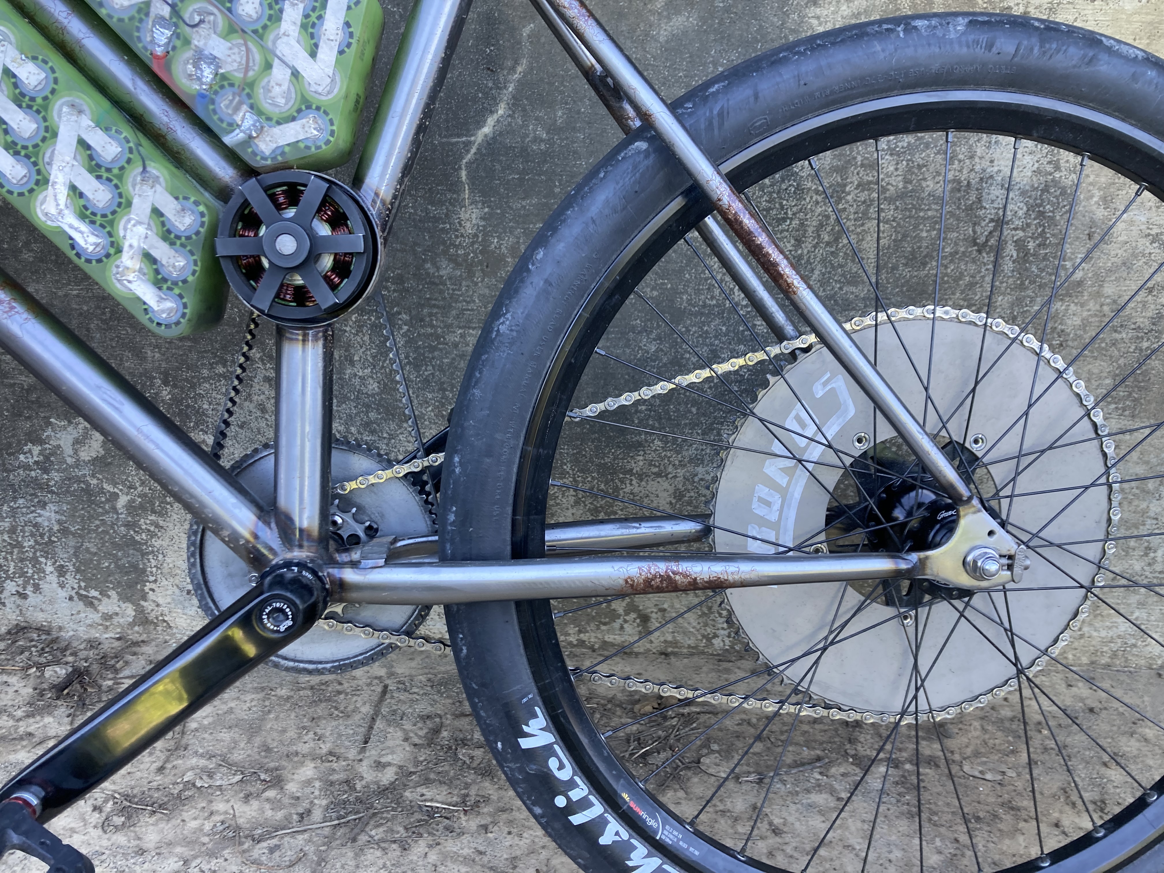

Would hardly call this a mini bike but i started on one. I wanted shifting because as others have mentioned fixed gear mini bikes cant go to fast.

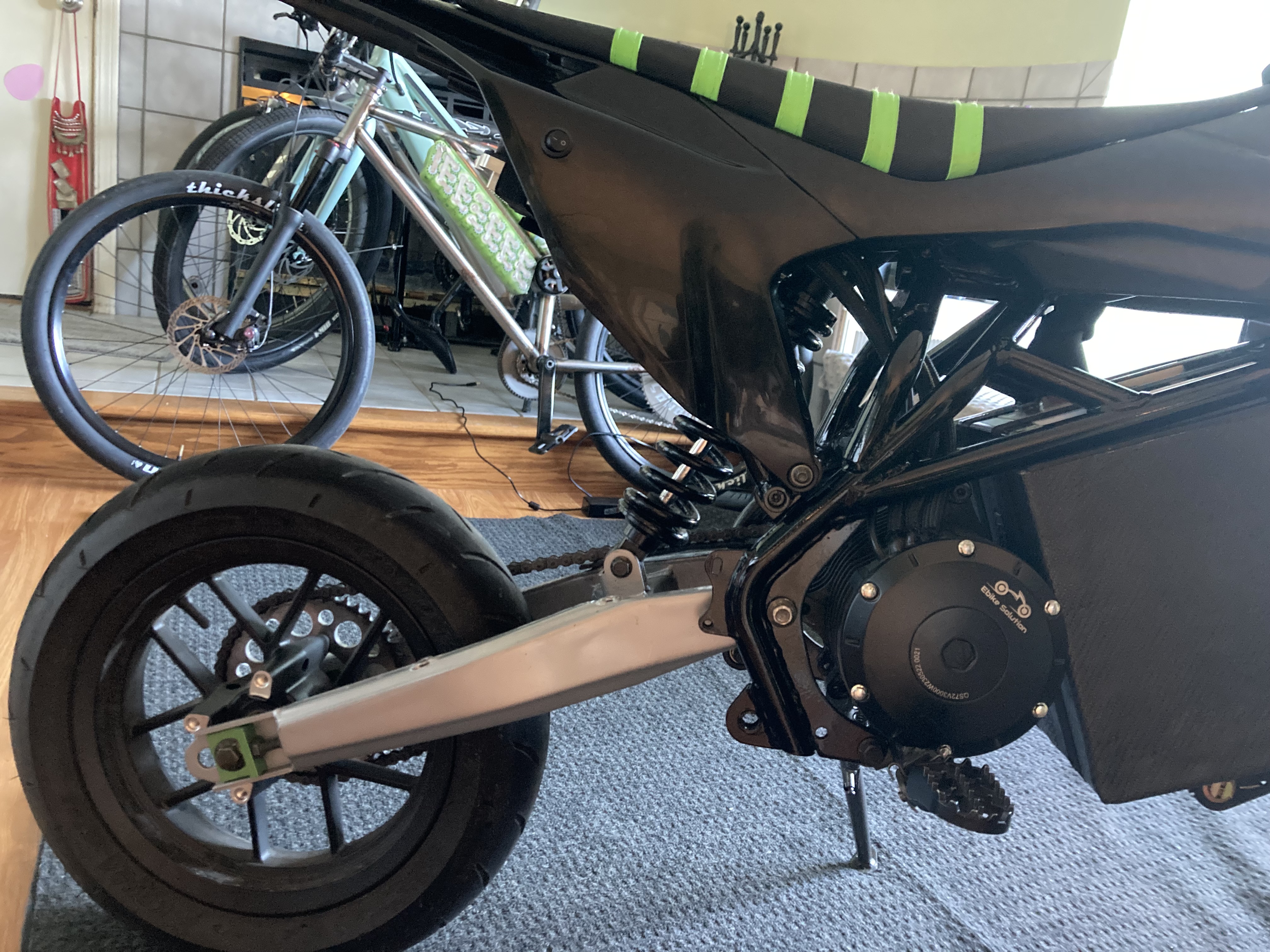

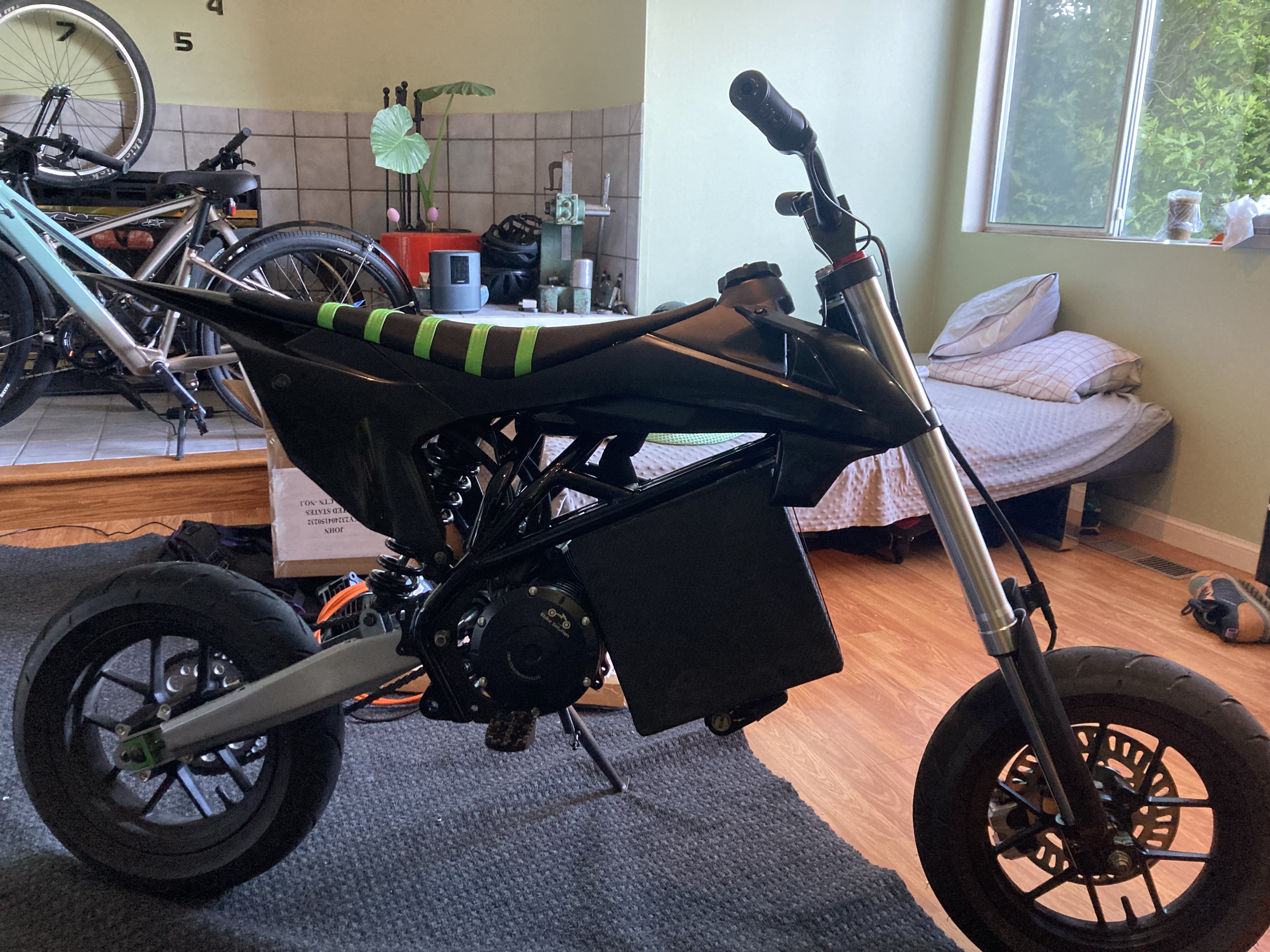

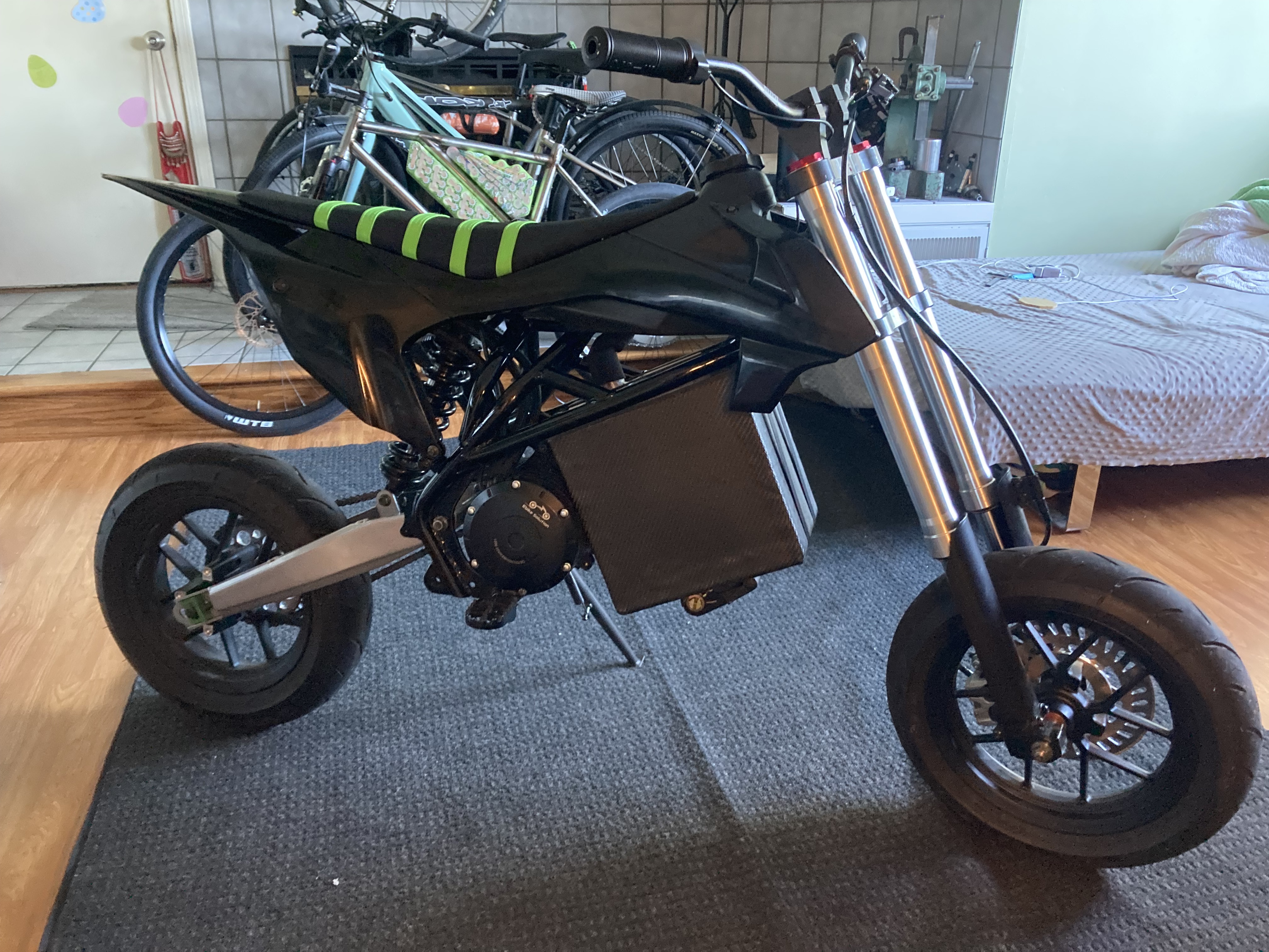

I pull 70 amps motor current on a stormcore and have a triple reduction. If i can get the shifting working we should 20-45mph range. Im worried the motors are too small but i have a 1:24 reduction with room to go up or down.
Is a 800$ bafang motor worth it? Curious if anyone has done the dual motor mini bike thing.
You can get way cheaper bafang motors than that imo. They are worth it.
I have to do research ig. The esk8 motors are dirt cheap by comparison. How much weaker is a dual 6374 than a bafang motor with no reduction?
