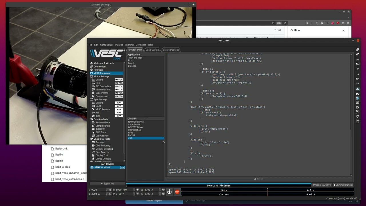

Vesc music! I don’t see a thread on this.

The music while moving on the hifi sounds really good. It’s got two melodies at once.
I love this feature. I don’t really do music but making various tone patterns for board warnings has been really beneficial, so I don’t need a UI. Here is what I programmed in my VESC package
