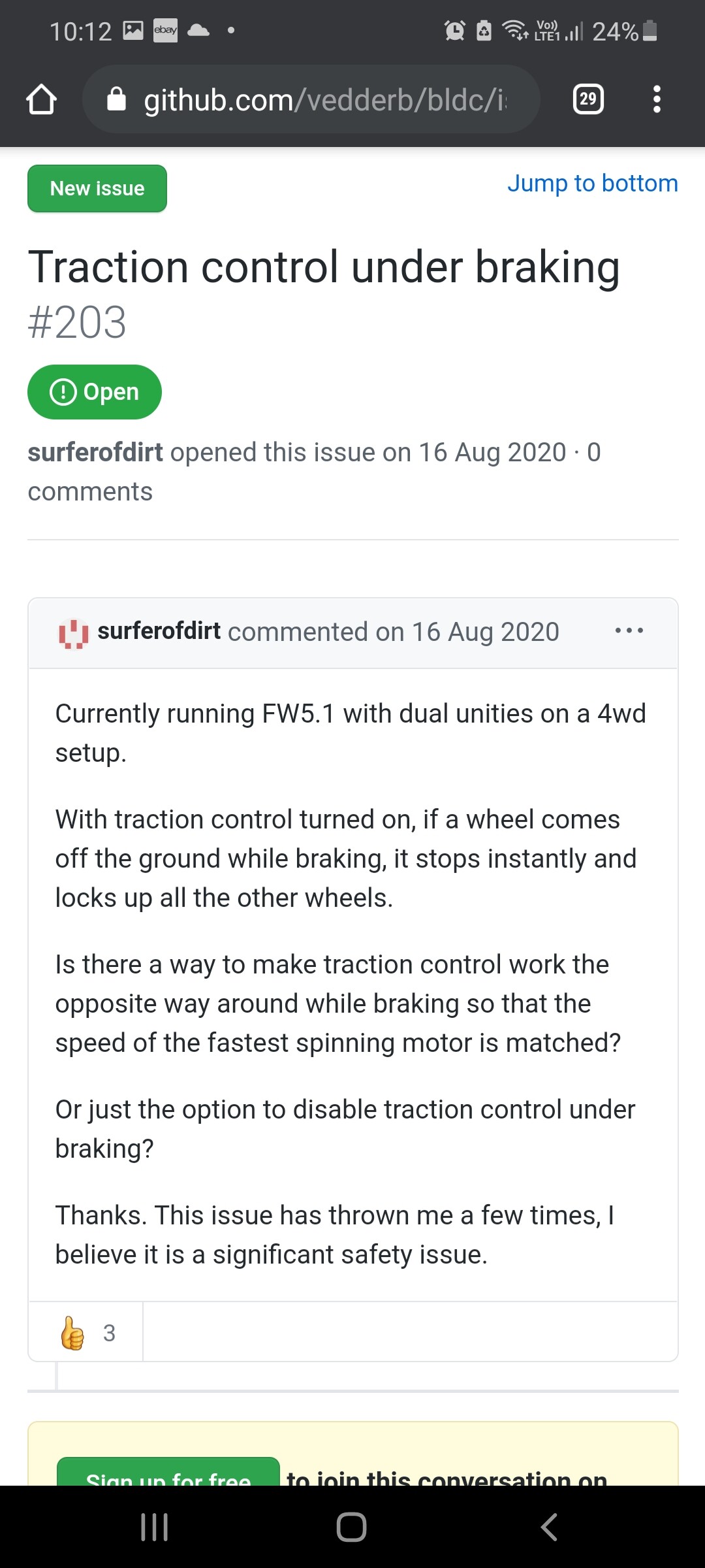

No fix to traction control :disappointed_relieved:
That’s the issue to fix ?
@glyphiks Now that Trampa is selling 4WD board, hopefully they will experience it and have it fixed, sad that this has to happen for something dangerous to get attention
One can only hope. It really is a significant issue.
With no traction controls is unrideable right?
And maybe it is fixed, the PPM rewrite by @Pimousse may have done it, by making the command sent over CAN bus a %, no a current value
This may also solve the problem I had in the past that if the master belt was broken and you didn’t have traction control enable, you had no power on the slave side
No i could ride fine with no traction control, although I did end up with a lot more mud in my face than I cared for.
I cannot test anything now anyway. The 4wd has moved on.
I didn’t address this issue in my rework. Sorry.
But it defo makes sense that TC can mess things up while braking.
Actually, I don’t like TC. Although it works great when everything’s fine, it has too many undesirable sides effects.

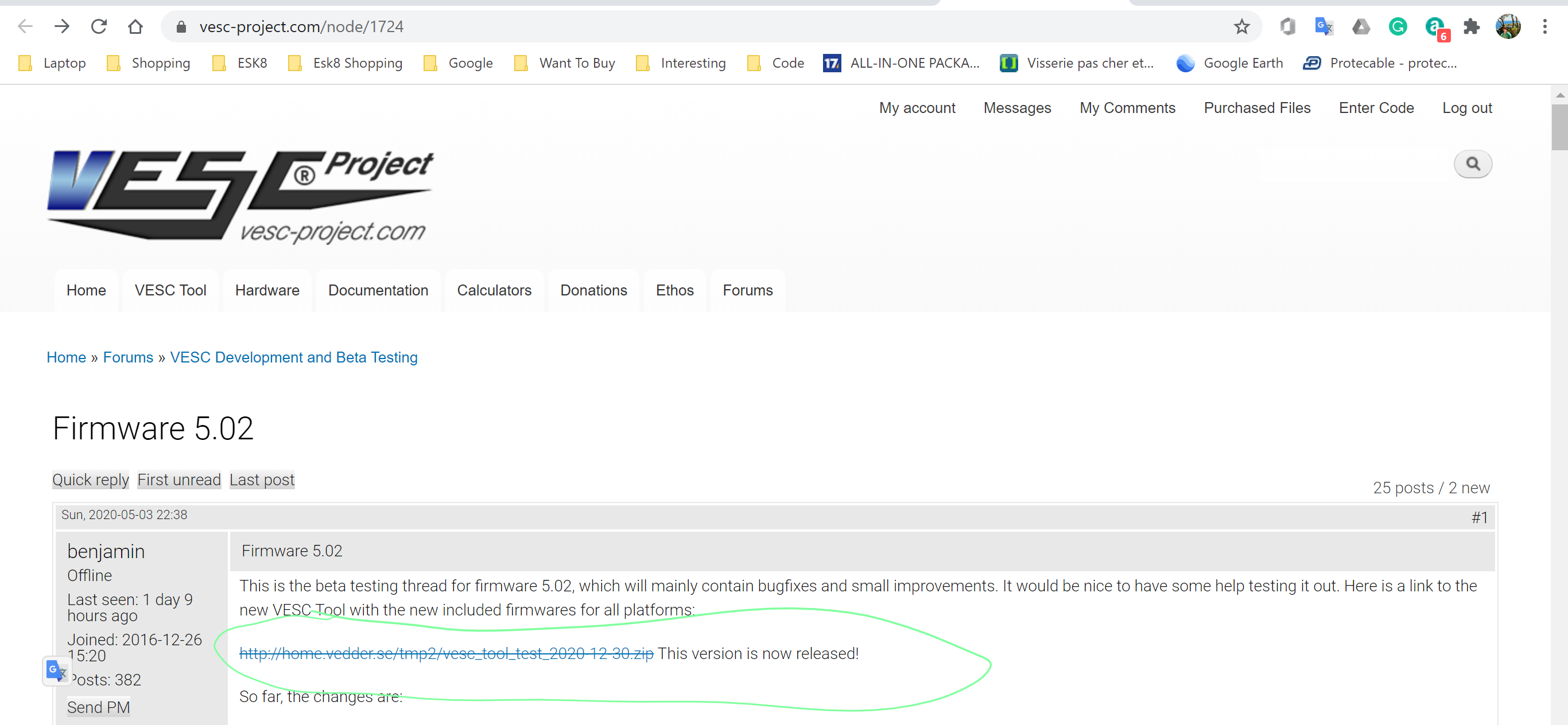

when i try and download it nothing happens. the link is also barred.
Am i doing something wrong?
The FW has been released and thus is not a Beta anymore.
Very well, but where do I download it from? I can’t find it on vesc tool website and I struggle to navigate on GitHub, so far haven’t spotted it :sweat_smile:
Do you have a File that you can share? Or link?
From the “VESC Tool” tab in that screenshot.
Then select “Add to cart” and checkout.
