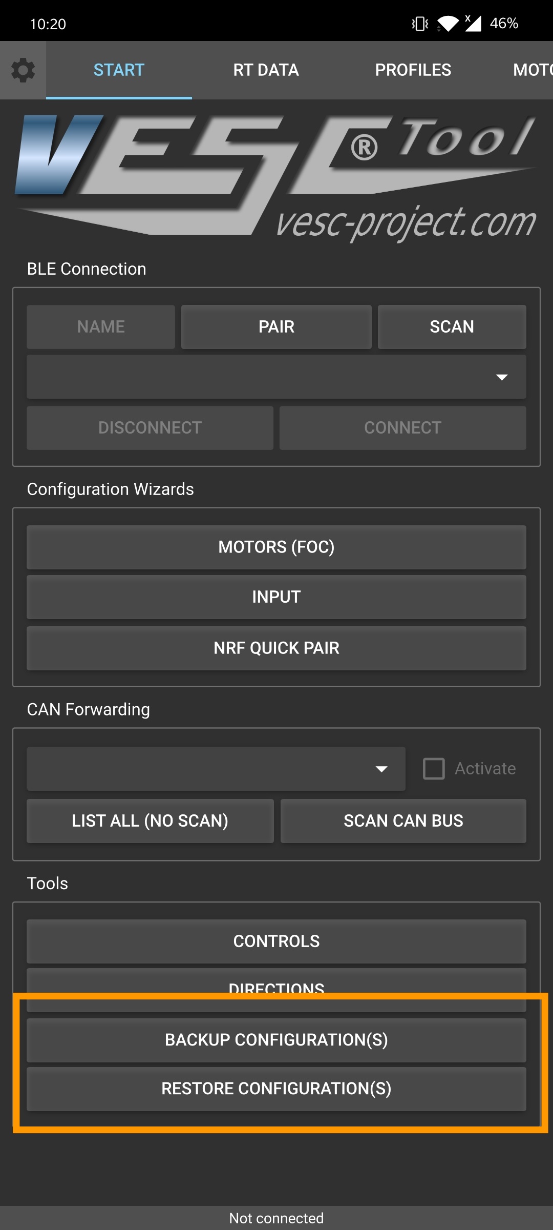

ok, i will give this a go, however last time i tried this upgrading from one of the beta versions to release it didn’t work.
I have been using it since a few versions ago and it has been working fine for me, I had also backup the settings from stable release and restore it on the beta 5.02 above and all seems to work well :+1:
Ok so I just did the upgrade, backup and restore worked as expected :slight_smile:

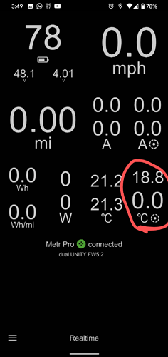

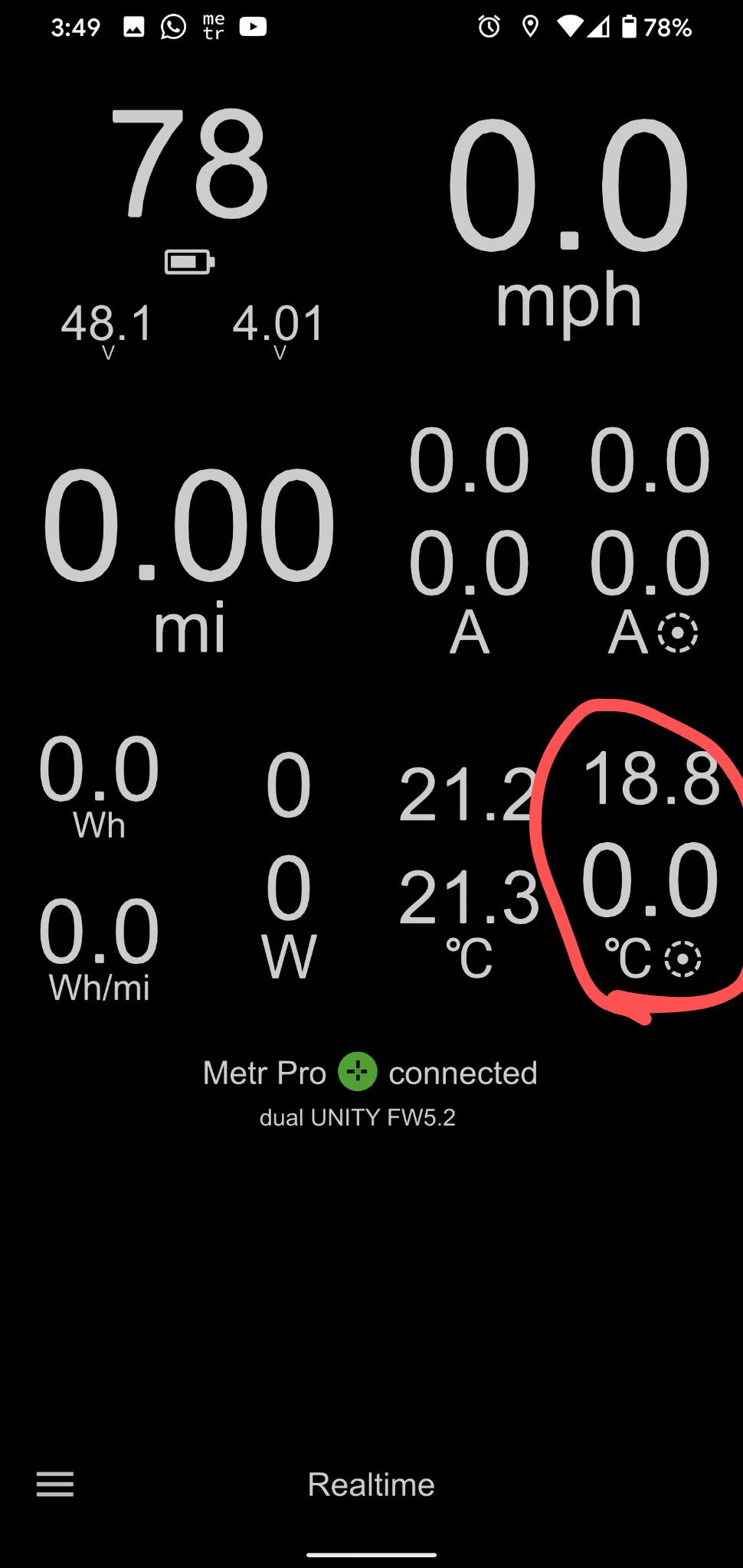

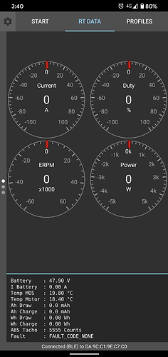

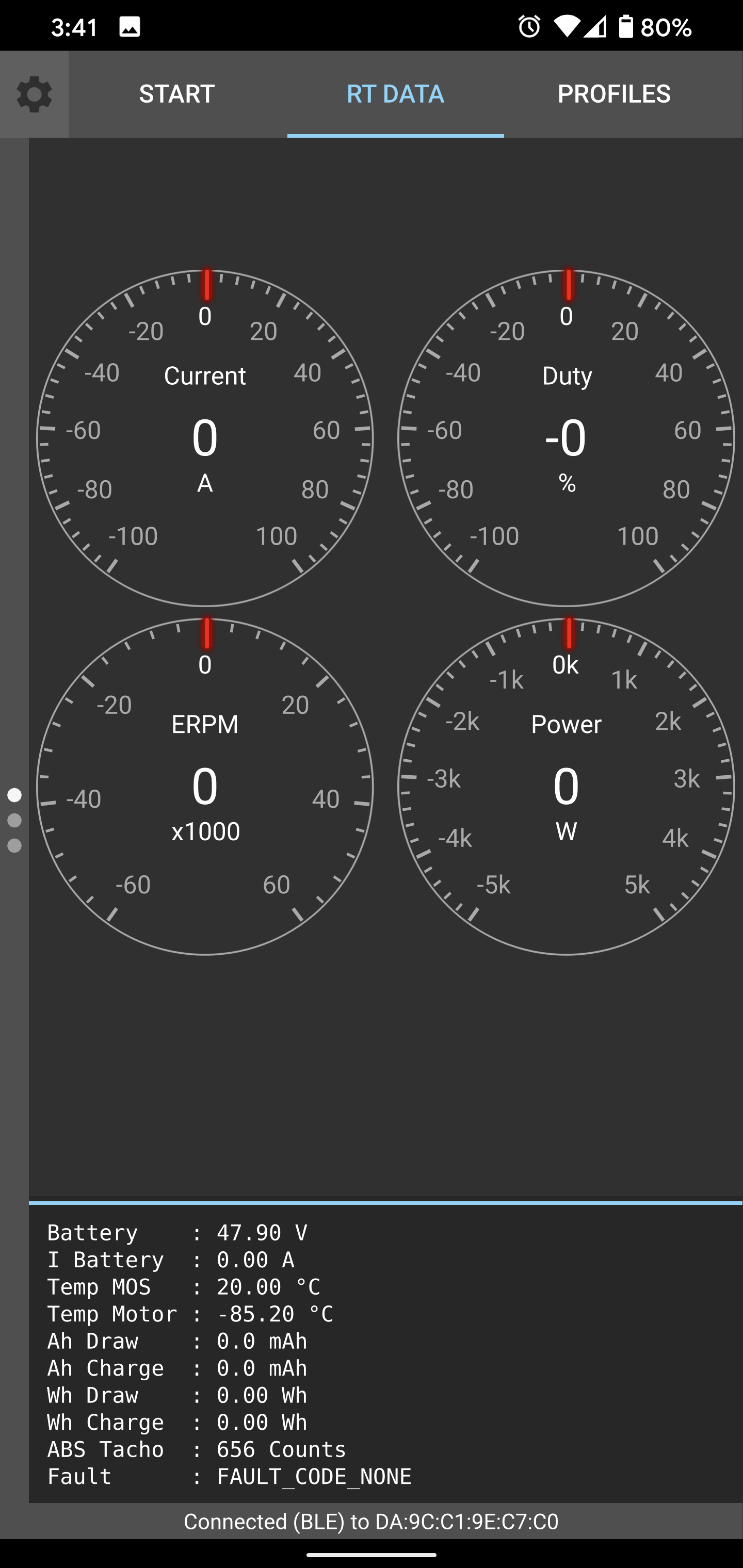

@Deodand I’m now seeing the correct motor temp on the first half of the unity but seeing a wierd negative number on the second half.
Checked with metr to verify its not a visual bug in vesc tool.
Might well be a hardware problem so I plan to swap the sensor cables over and see if that changes anything.
Is there some noise on that reading? It does look like its floating around the level of a disconnected sensor. Major props for the quick feedback, thank you!
