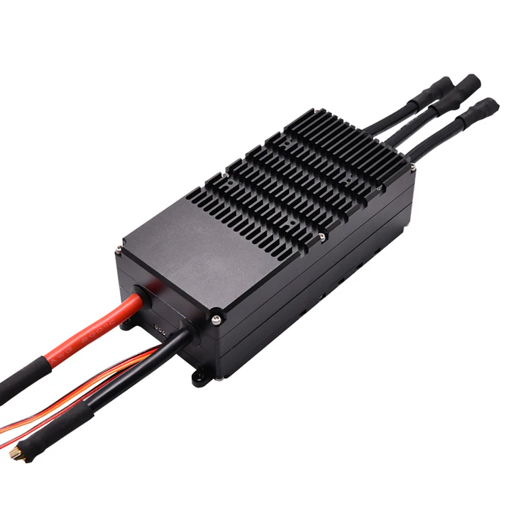

freeRChobby also have ESC, but price is crazy 24S 300A for $1,100 and 24S 200A for $810

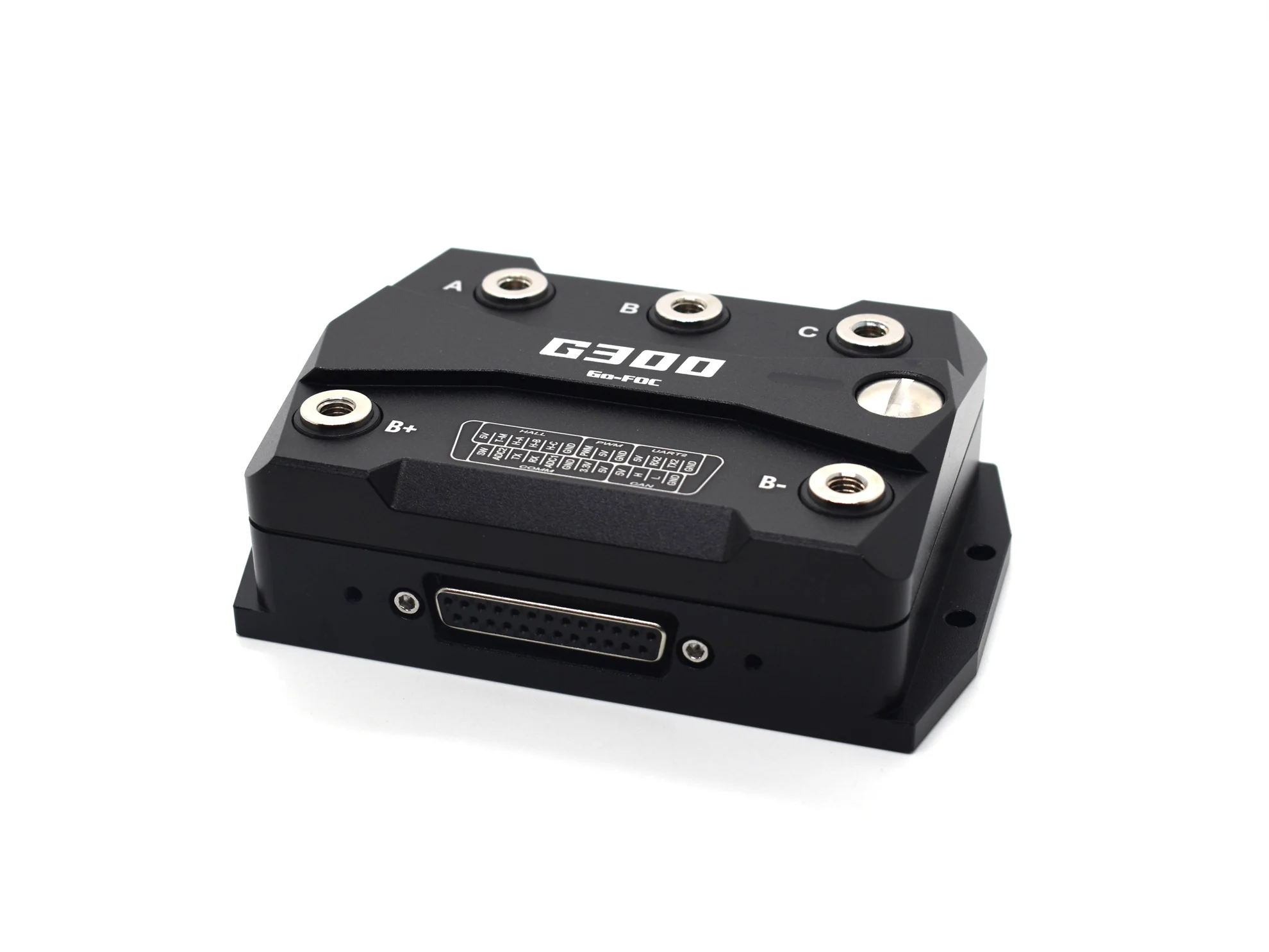

My plan was to use Go-FOC G300 from makerX, but it is only 21S =(

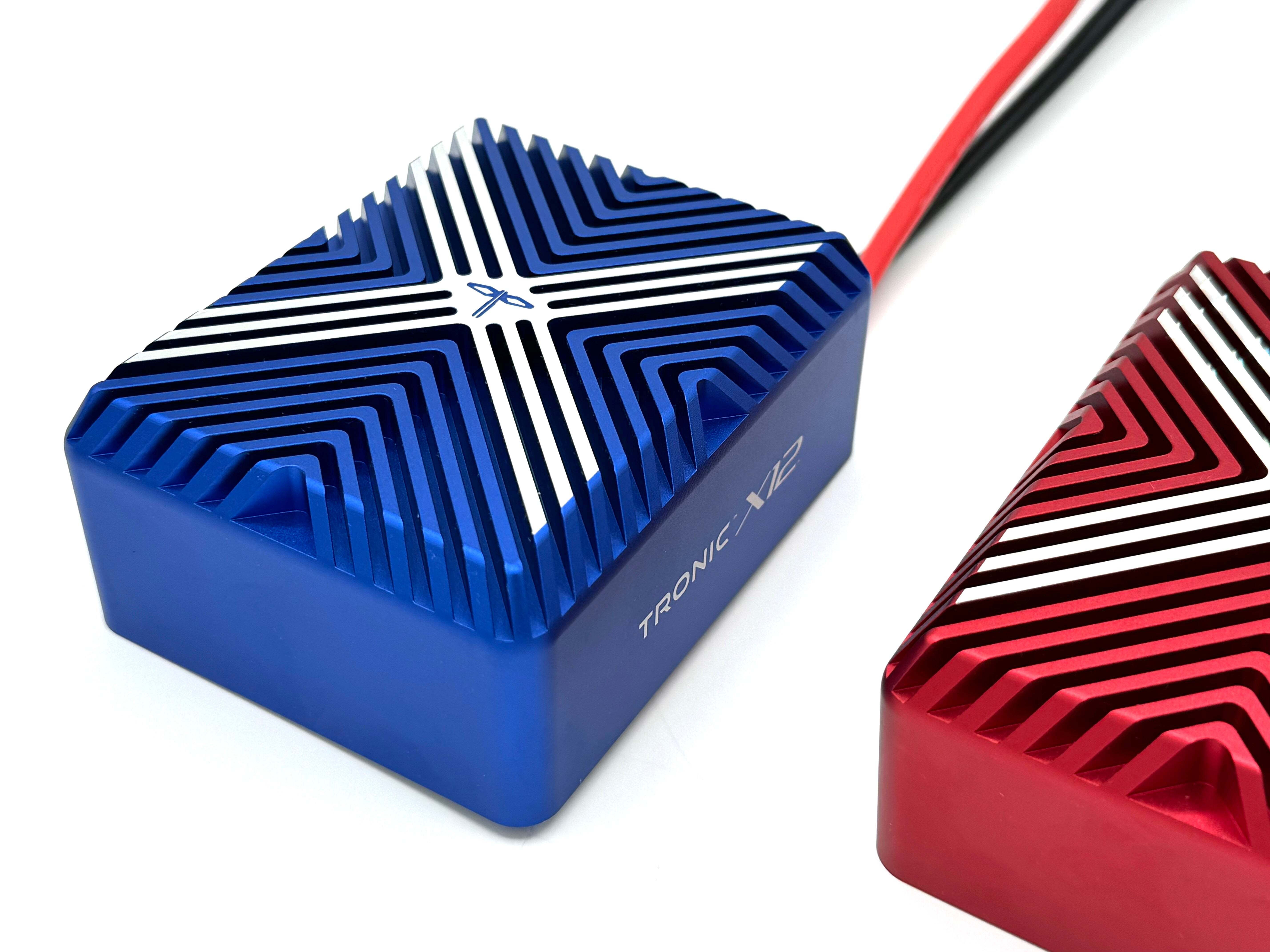

Tronic seem to have a good name and have been around for a hot minute now. I don’t know a great deal about this end of the spectrum, but this is the first/only product i’d be looking at.
many thanks! interesting product! 30S
I would go for 24S Tronic on 24S over 28S on the 30S controller.
They are super impressive controllers but their small size makes me doubt them if you want huge power for a long time. I don’t know how much power you need and how much motor/battery it is being paired with but 3shul is another place to checkout for huge VESCs.

TRONIC X12 30S web site (shotify) not avilable now =(
A-damW
December 4, 2025, 8:50pm
8
@Argazmo , I don’t know the exact story, but I think Tronic sold their remaining stock to some 3rd party.
