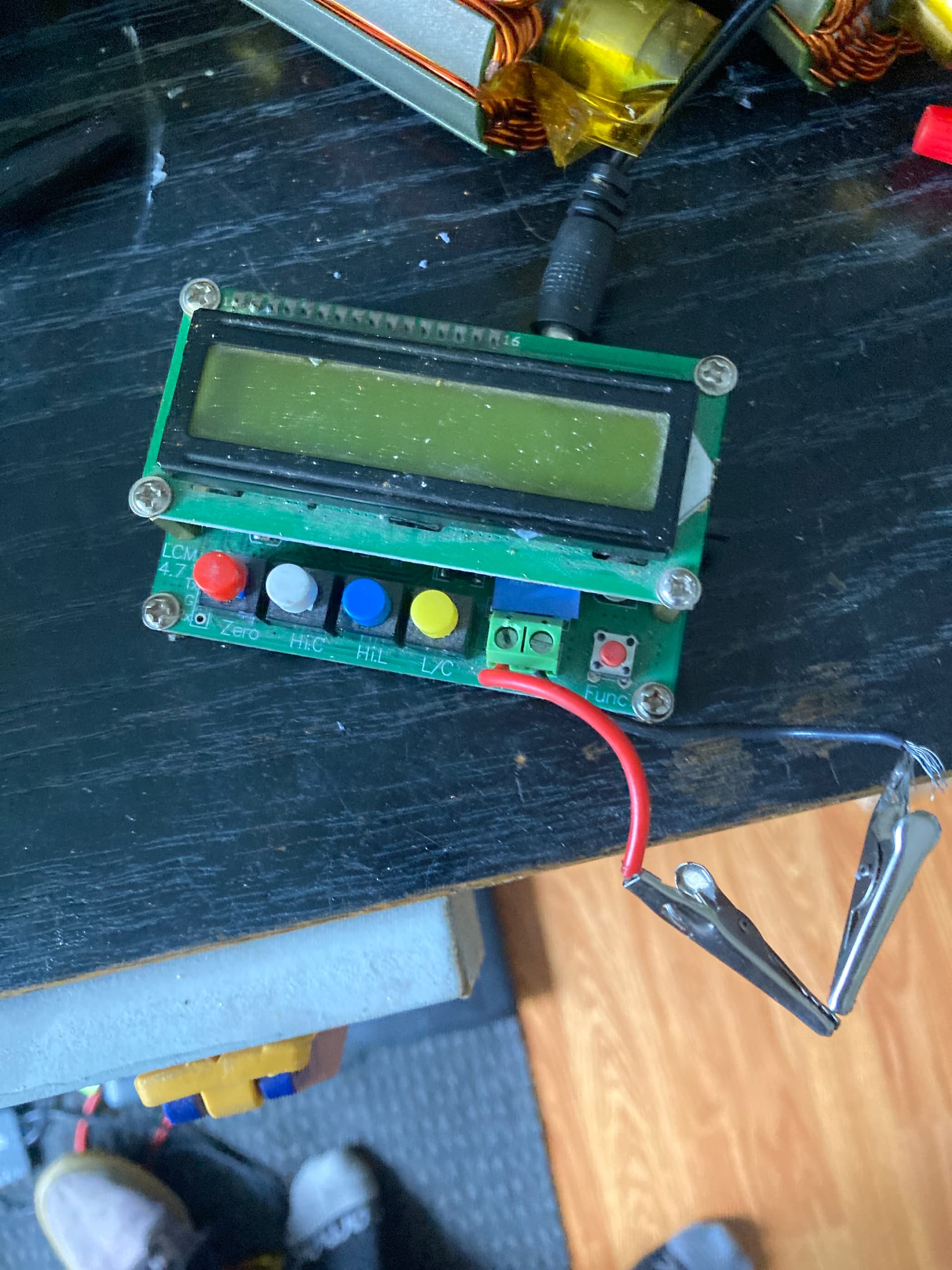

Assuming the motors worked before do they spin as easily in ur hand or does it feel like it’s filled with honey in which case it’s shorting. If it’s not shorting a wire broke or could be a loose connection that breaks the circuit or is shorting intermittently. Or if it’s kinda moving but gets hot it’s likely a short within the windings. No electrical engineering degree needed. If u can open it and check on the wires and get ur miltimeter in there that’s good and even better is to use an L/C meter and check each phase inductance
This 15$ L/C meter does it all
I just mentioned my degree since otherwise I have nothing to prove that I know what I’m doing, and that I fully know when it is better to have someone else fix it instead of attempting it myself. But, yeah, you’re right that it isn’t necessary to fix the motors used on eskate as they’re extremely simple design wise.
