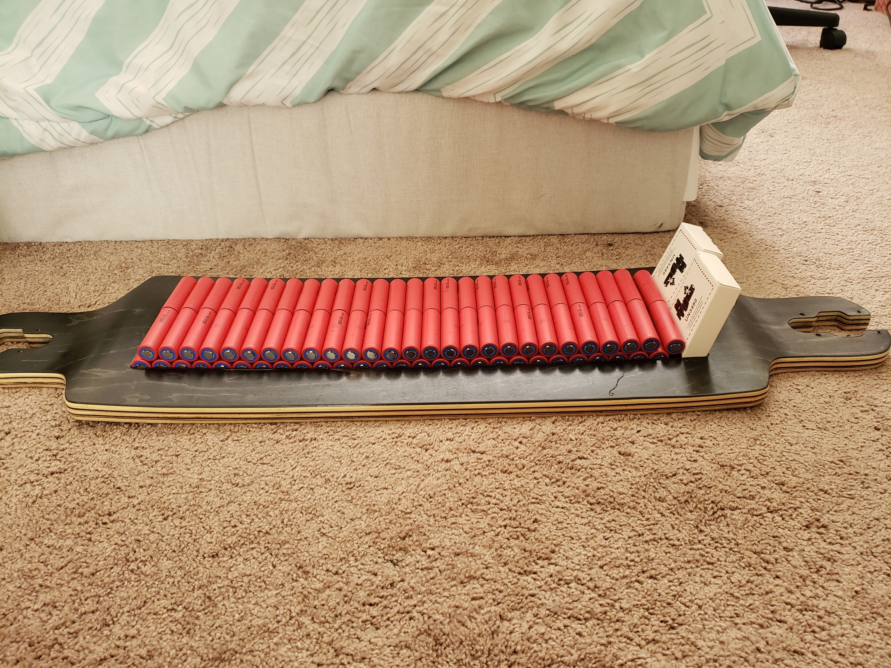

Inserts in and flush :smiley:
Artwork (in-progress)
Battery NSFW :sweat_drops:
Soon the battery will be finished, just waiting on insulator rings on the top to finish the last side of the batteries and apply the BMS ! Soon!!

How are you planning to fit 12s8p with 20700b’s? are you planning to mount the esc on top of the deck?
It all fits inside the enclosure, need to sand down the deck a bit to give me 1-3mm of clearance on the sides to fit the 20700 cells. I am double stacking the batteries as you can see. it fits surprisingly snug.
cool really excited to see how you will fit it without doing much modification to the deck.
this is 12s9p for reference, so youll have to squeez everything in lol
Shoutout to neil
A 9p is just too much for me loool, I just like having the all in one box type of board. No extra extremities if you will. I will take a pic of the cells with the unity soon. Though the extra 12 cells does make a difference in space for a build.

It’s going to be tight, but tight enough :wink: enough space for a BMS on top of the unity and enough for a receiver. Nothing more and nothing less, spaced well used :slight_smile:
