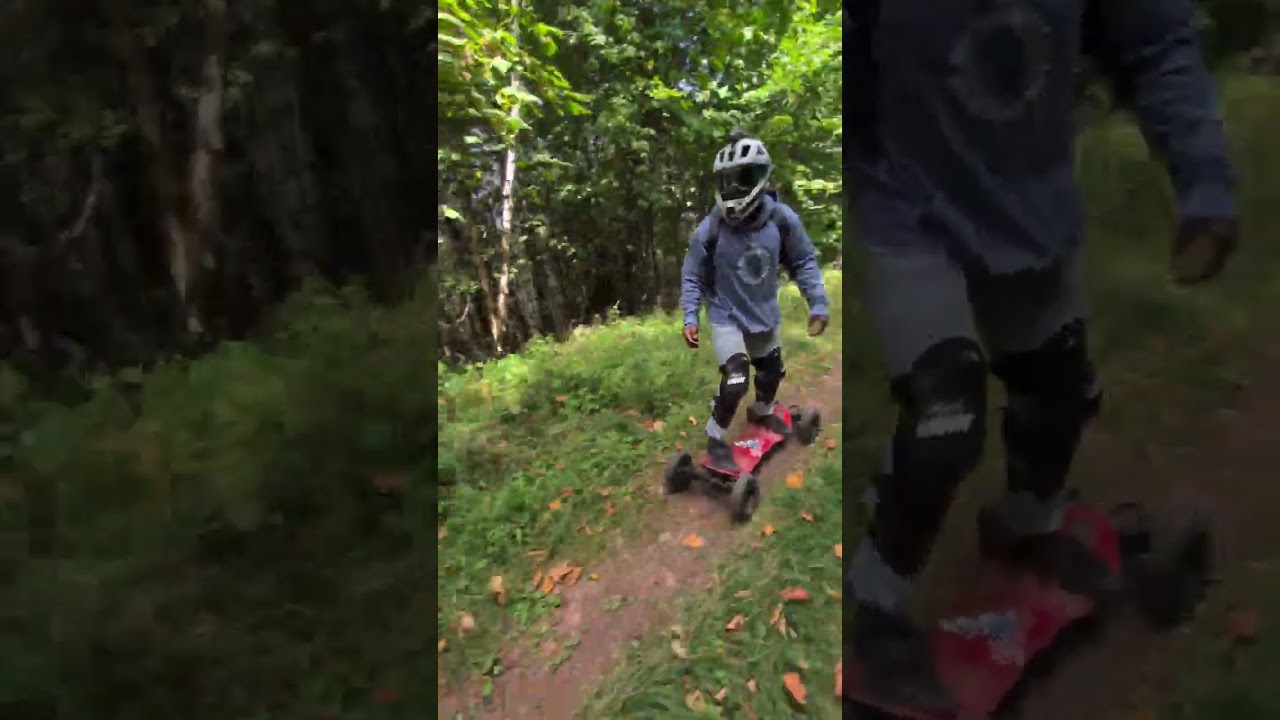

Damn that video is satisfying to see. Balance looks excellent. I hope you have this board at carve. I’d love to try it out.
Is that HFI / sHFI I hear or is it just noisy sensors?
One of my sensors won’t detect, didn’t have time to diagnose so I turned on HFI for that one.
Skill issue
Haha same on my board. Currently running one motor on sHFI coupled

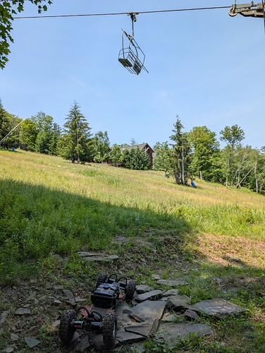

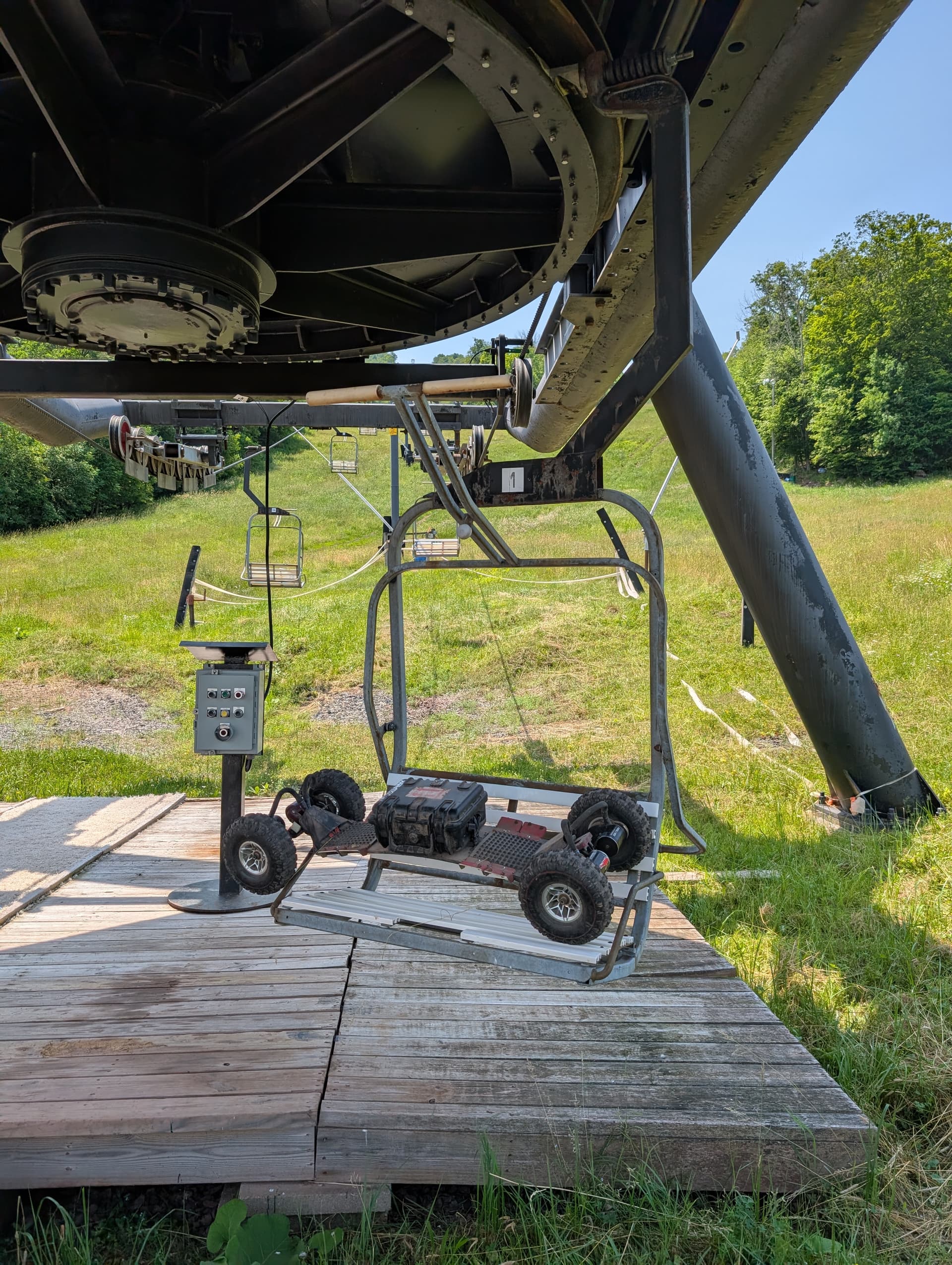

I love taking this thing to ski resorts
It’s cool they let you. We tried in big bear and they said “absolutely no mountain boards.” Will have to try some other spots.
Who said anything about permission? Y’all gotta remember this is still skateboarding
Also important to remember that many ski resorts are on public land. They can stop you from using their lifts and buildings and whatnot, but they can stop you from just being there on the trails.
At least that’s how it is in the PNW :man_shrugging:

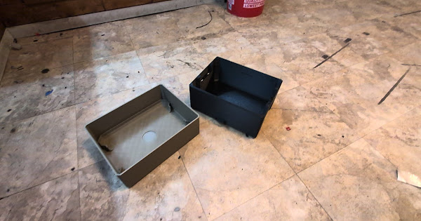

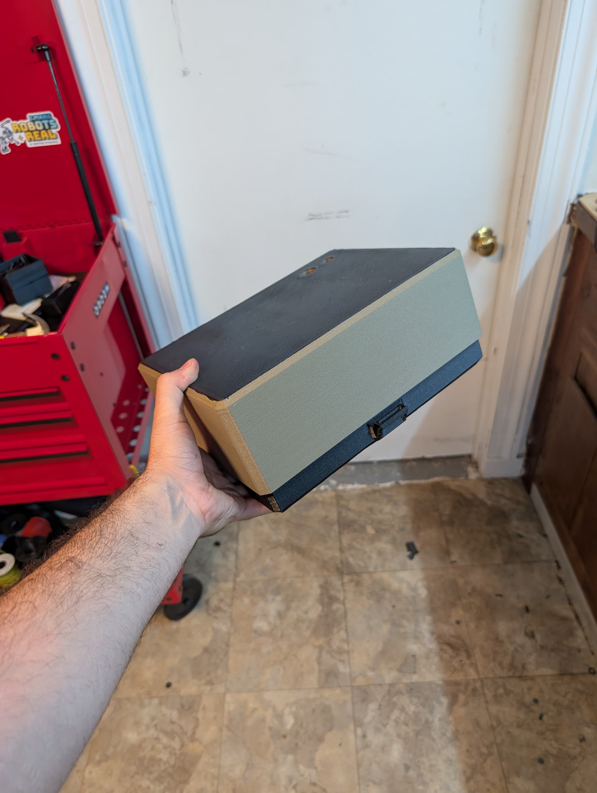

Been working on a 3d printed top box. Finally got active chamber heating working so I could print this in PETG-GF with zero warping and perfect layer adhesion.
What’s left:
-Some way to secure the lid to the box. Friction is good but not perfect.
-Gasket in addition to the labyrinth seal. This should be as easy as making a gasket for where the box lip interfaces with the box lid.
-You tell me
PS: theres no money in esk8 so heres the entire source CAD
