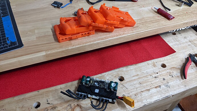

I have @Ace visiting this weekend so my main ride has to be in tip top shape!
  1. Redo the expoxy on the @SabreDynamics wings. I think I had to do it multiple times because I’m bad at epoxy. Took me way too long to learn that I had to heat it up. Now they’re on really really good.
  2. Redo the grip tape, easy
  3. Change the rear tires , I’m really gonna miss my @XBoard tires :confused: Switching to evolve 7in for now.
  4. Increased the pulley ratio for more torque
  5. Make the lights look less like Mr. Krab’s eyes

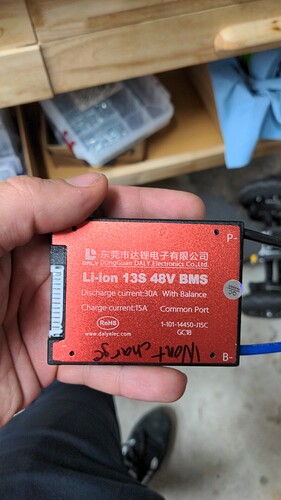

Within one week I had my unity die, my charging cease to work, and my wings started falling off.
I replaced the BMS thinking that it was faulty, then new one had the same issue. I found out that there was a cold solder joint at one of my bullet connectors. I soldered those about a year and a half ago maybe, I guess my soldering skills were a lot lower back then. I fixed that pretty quickly.
All have been resolved or are in the process of being resolved (epoxy curing)
Now this thing has a storm core 60D and I no longer feel like I need to change the motors because HFI works really well on this hardware holy cow
