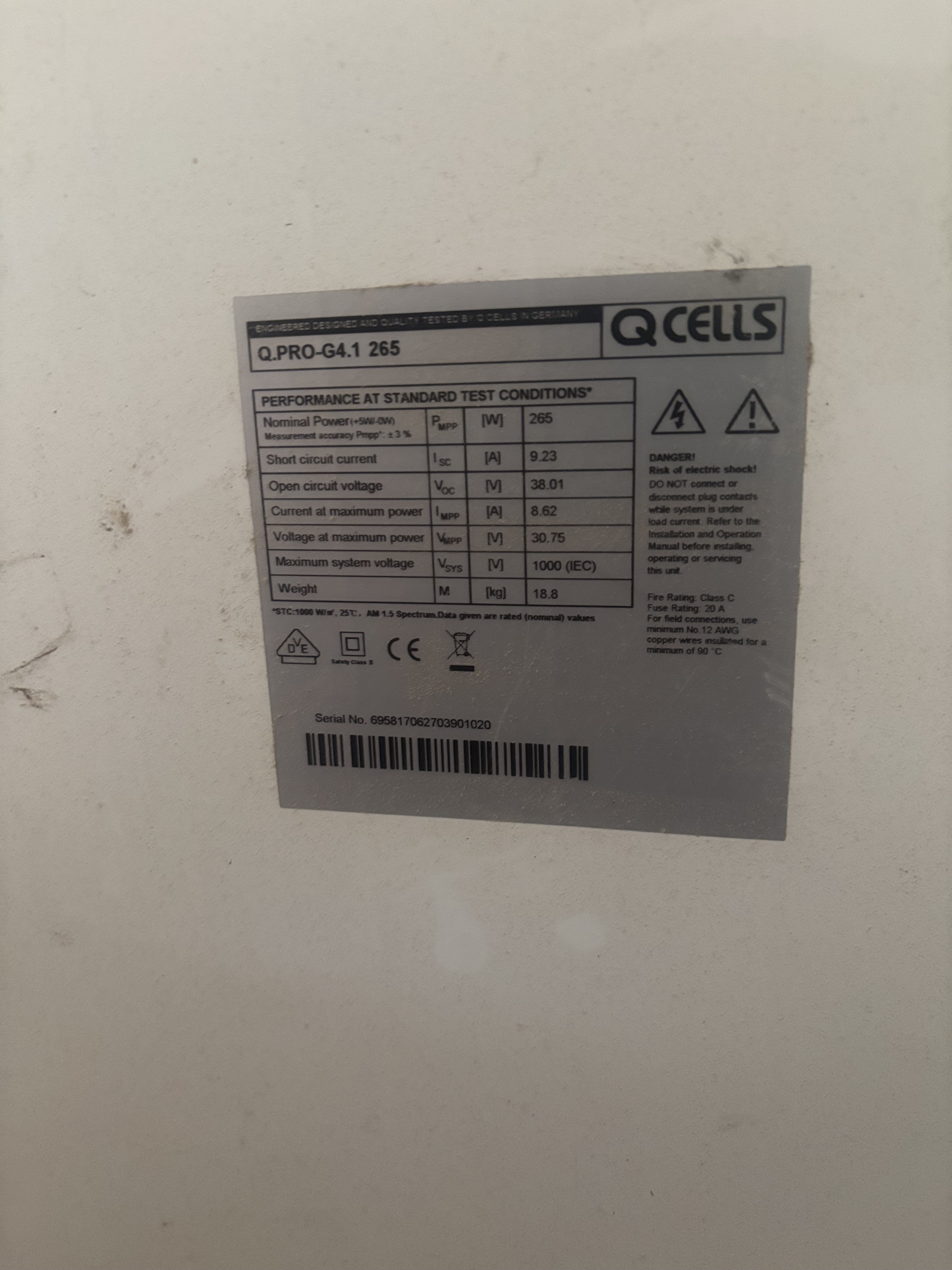

Hmmmm there’s 320w of panels there right now and I have a 265W panel that would fit perfectly at the front of the car on the slope between the windscreen and the roof rack.
Only problem is that it was a solar panel for a house, and it says max 30V, so I’d need some fuckery to bring it down to 12v.
I don’t really want to install this panel unless I have to though, so again, it’s gonna come down to suck it and see with the gear that I’ve got.

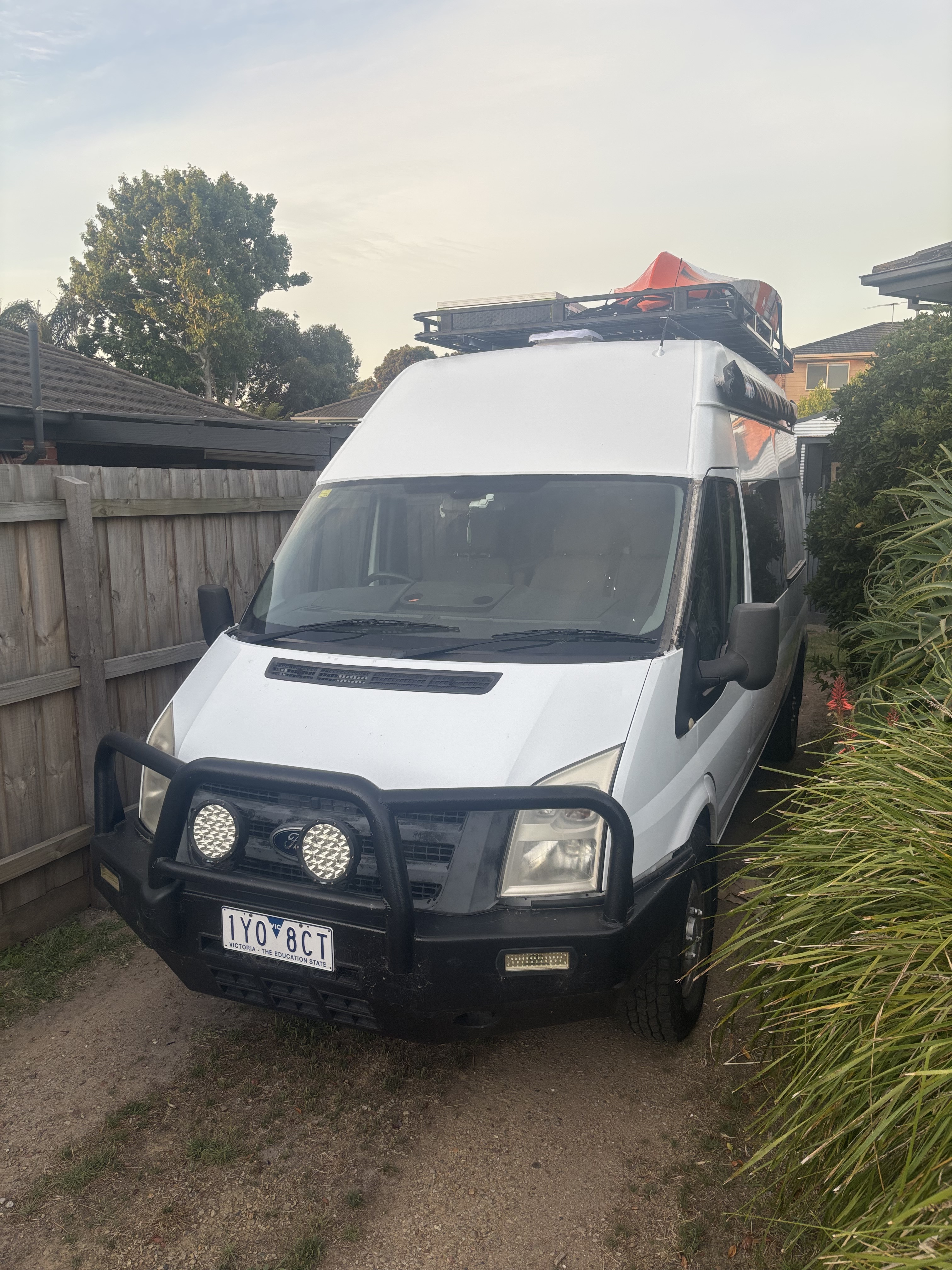

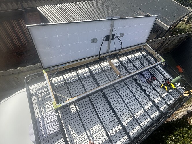

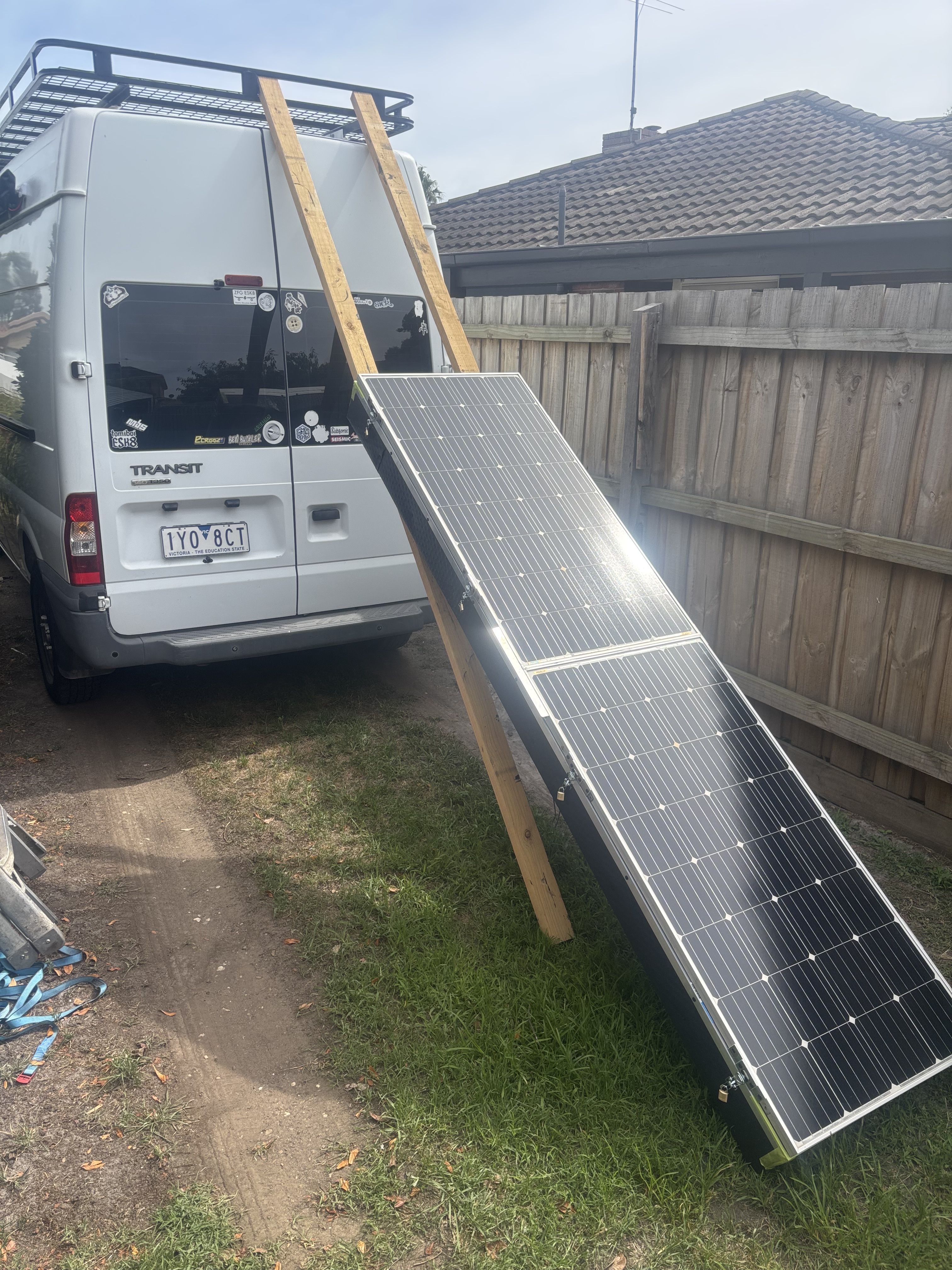

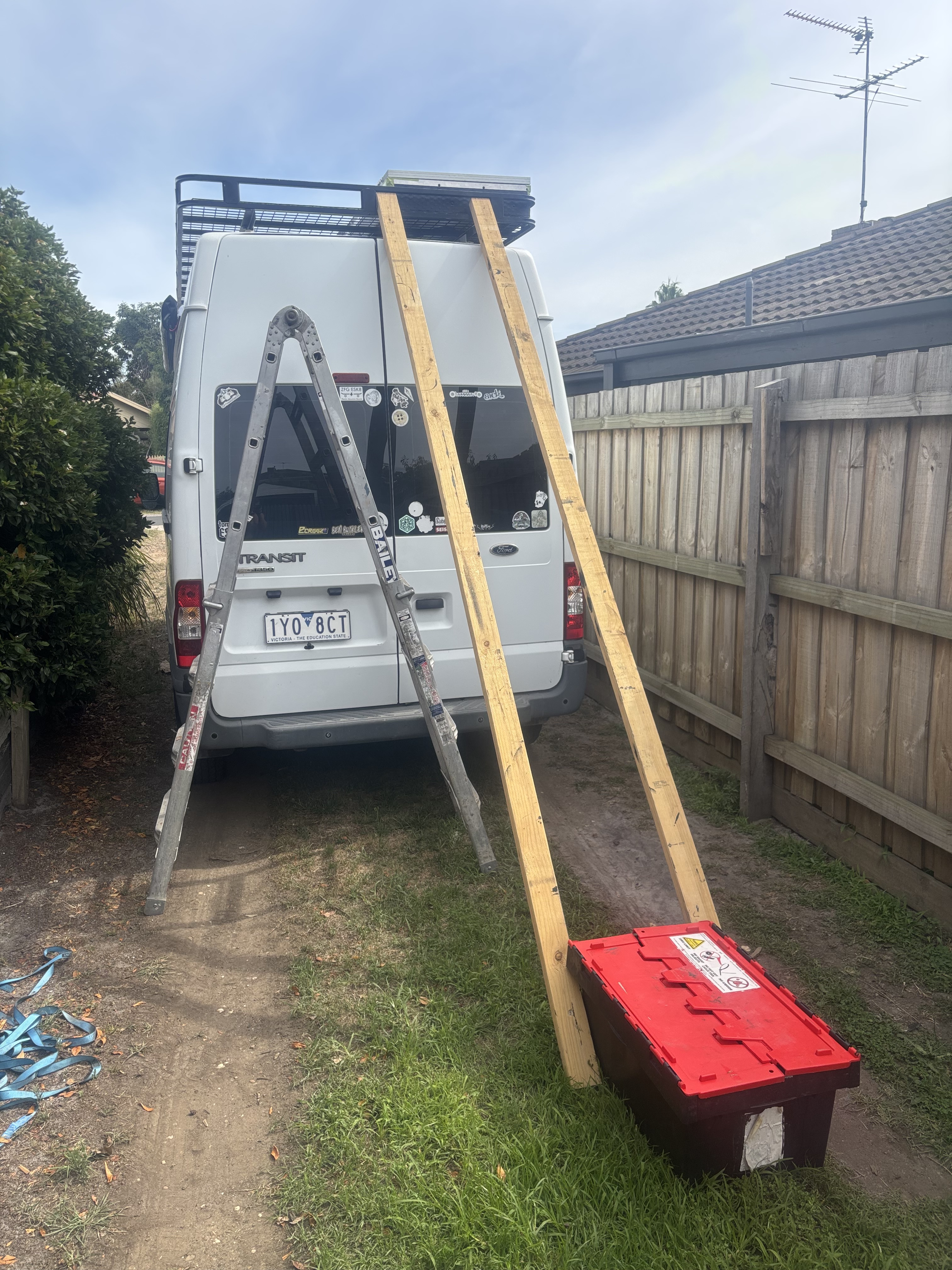

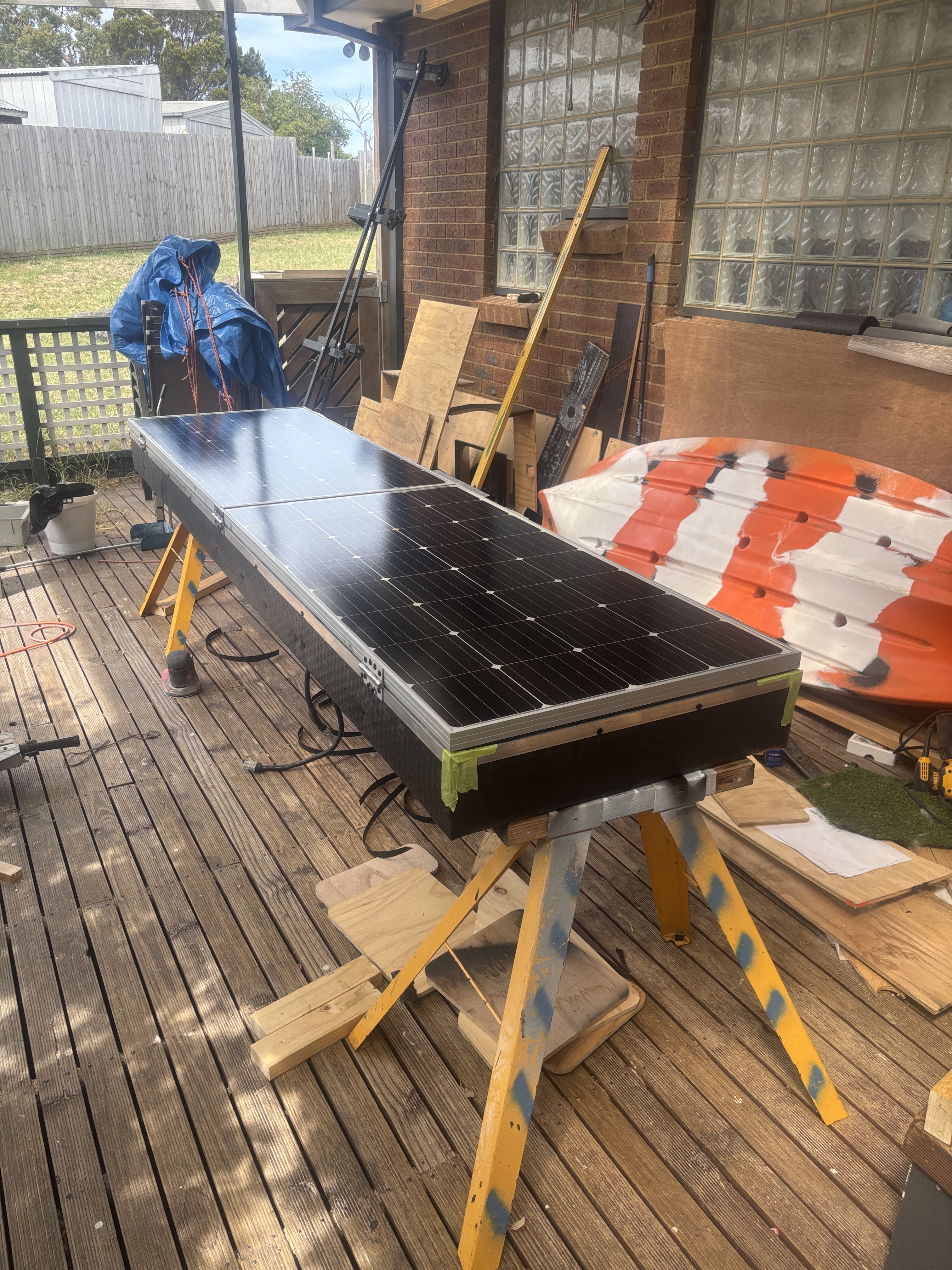

So as it turns out, the size of my solar box was giving me anxiety. It just didn’t feel right.
It took me the best part of the day, but I tore it apart and shrunk it. I ended up going even smaller than initially planned with a finished height of 175mm. I’m so much happier with how this looks and couldn’t wait to get it on the van.
Because I used up most of the hoist wood building the box, I had to improvise :grin: it went well.
The box secured to the racks well, with enough room in front for some kind of little air scoop, yet to be built.
The kayak also sits up there nicely with just enough space for me to move around up there as well.

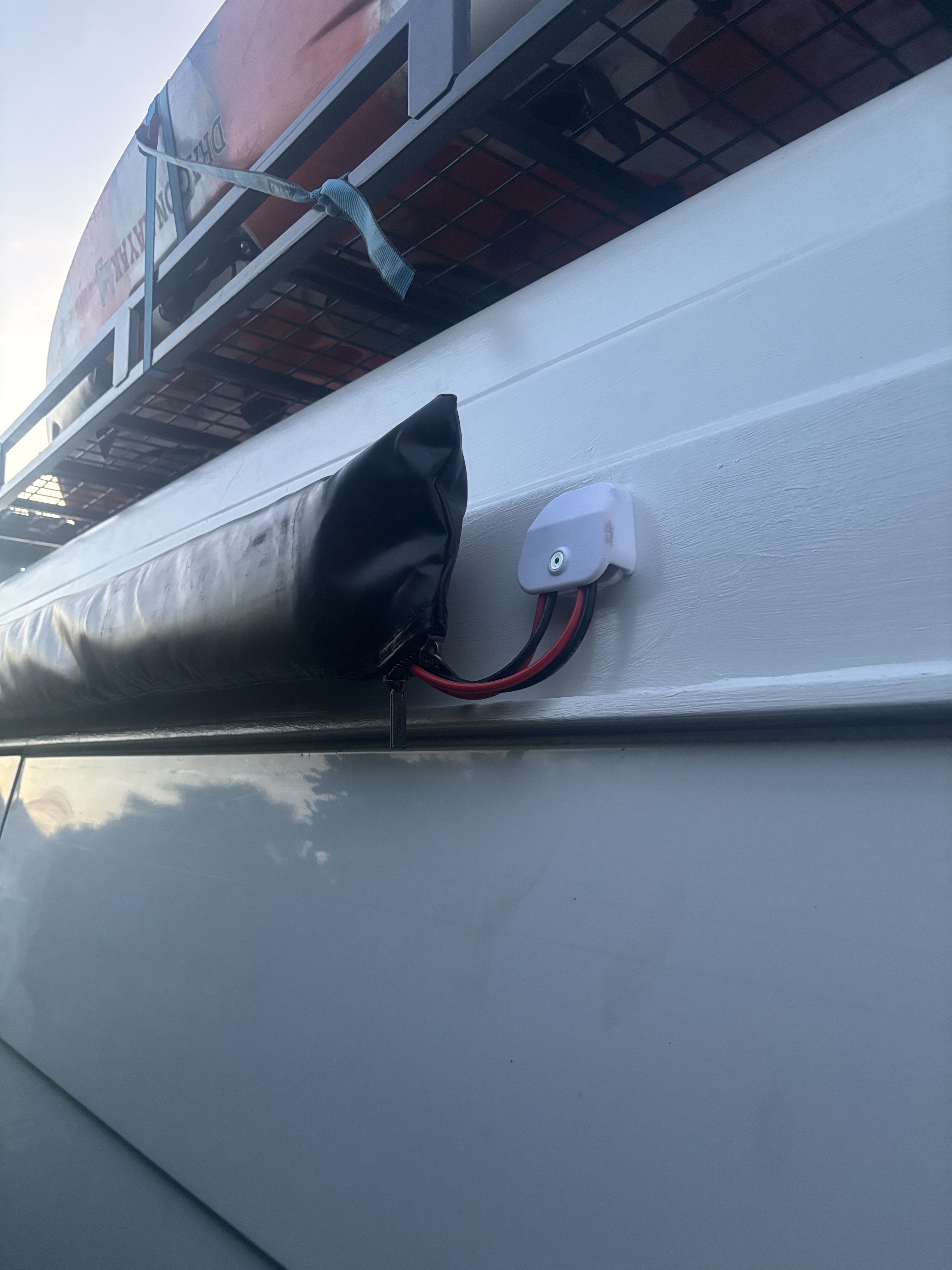

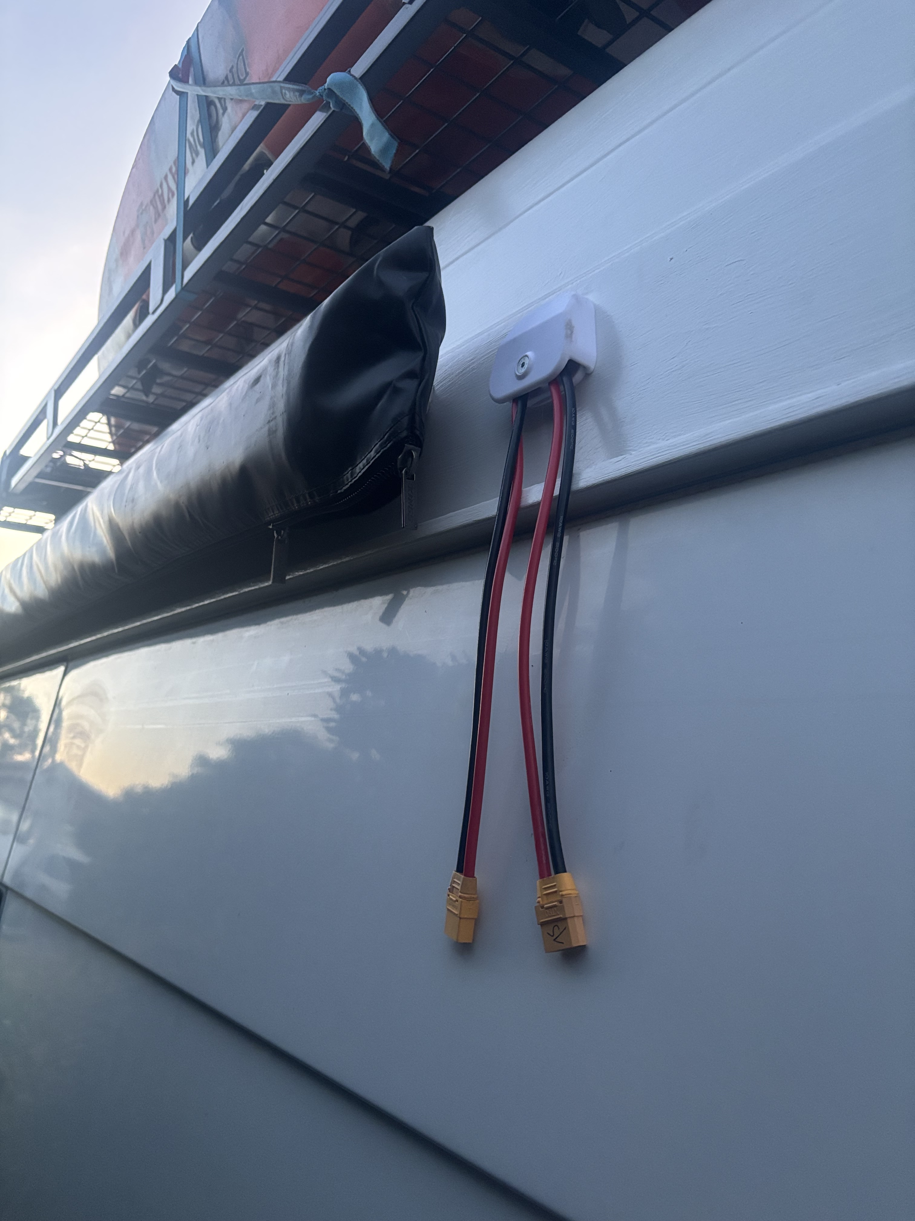

Ran some power out into the awning for lights/fans/whatever.
Definitely feels like I’m making progress now!!

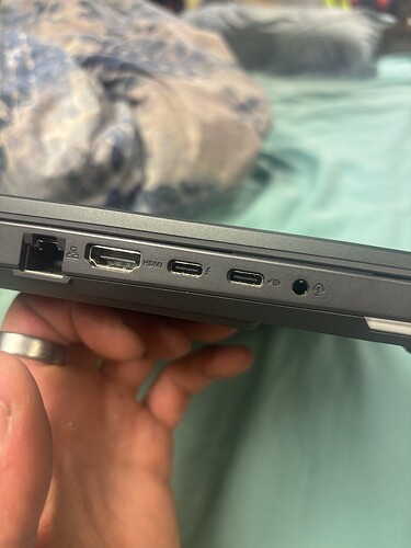

I’m guessing the laptop isn’t powered via USB-c PD?
If it can do that, i sure as hell don’t know how to make it do that :joy: it’s just got a 240v charger
Edit: it would seem that I can :thinking:
Internet tells me 100W can go through there
That’s one less 240V device!
