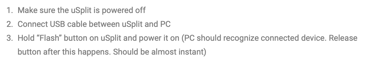

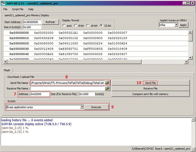

Finally got my hands on uSplit. Unfortunately both of them seem not to be recognised by BOSSA (neither on Windows nor Mac). Is usb cable enough to power on?
Pmed, This project looks like Exactly what i need to connect everything inside for maximum Telematry and control
Did you hold the button while plugging it in?
Nope, I also had the same struggle with this but you need it to be powered by the vesc, so it’s with a battery.

Now I understand, because (3.) says power it on, it means USB cable (2.) not enough for power. Didn’t read it very careful the first time, thanks!
Edit: I managed to update uSplit FW to 0.7
